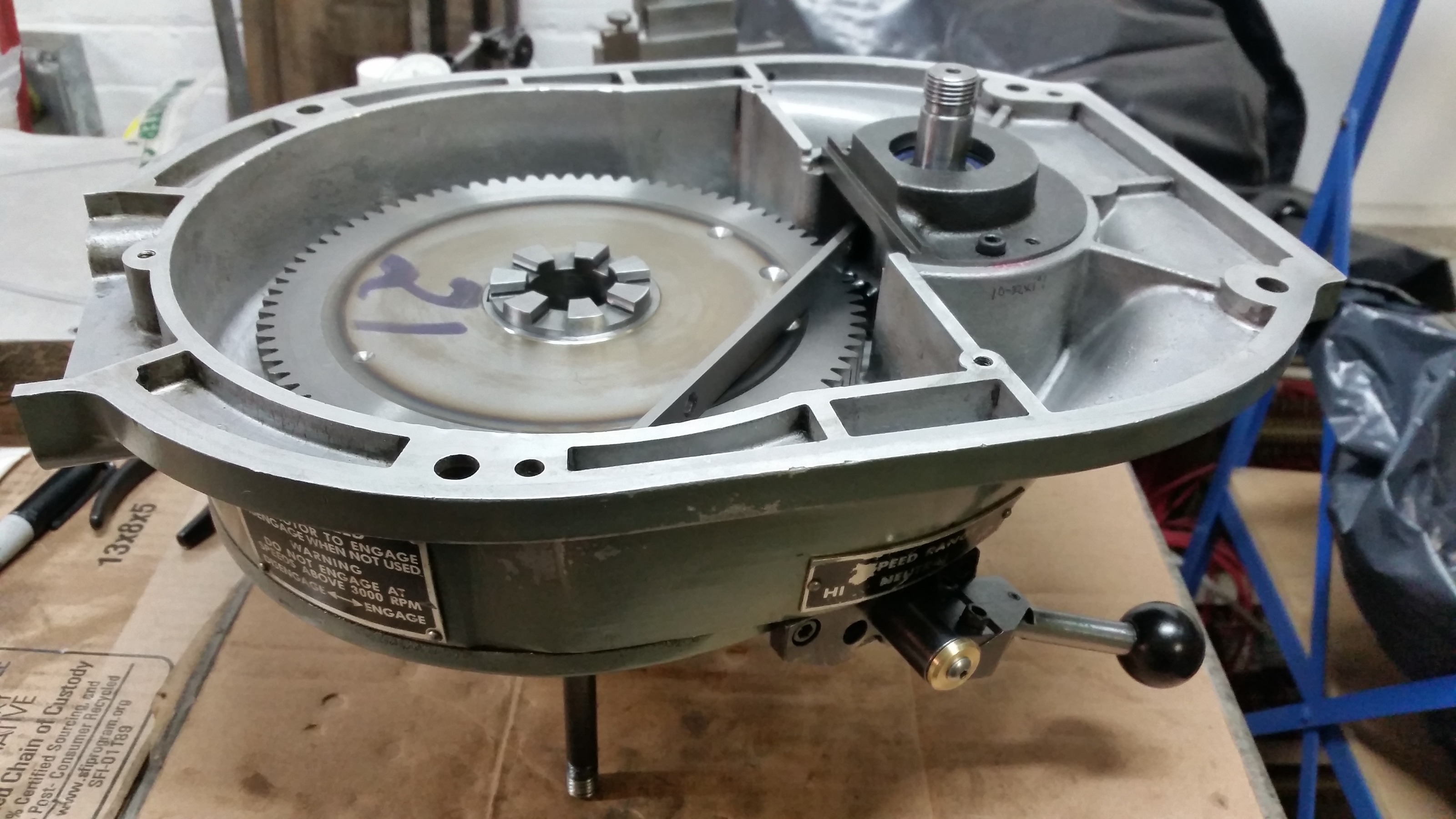

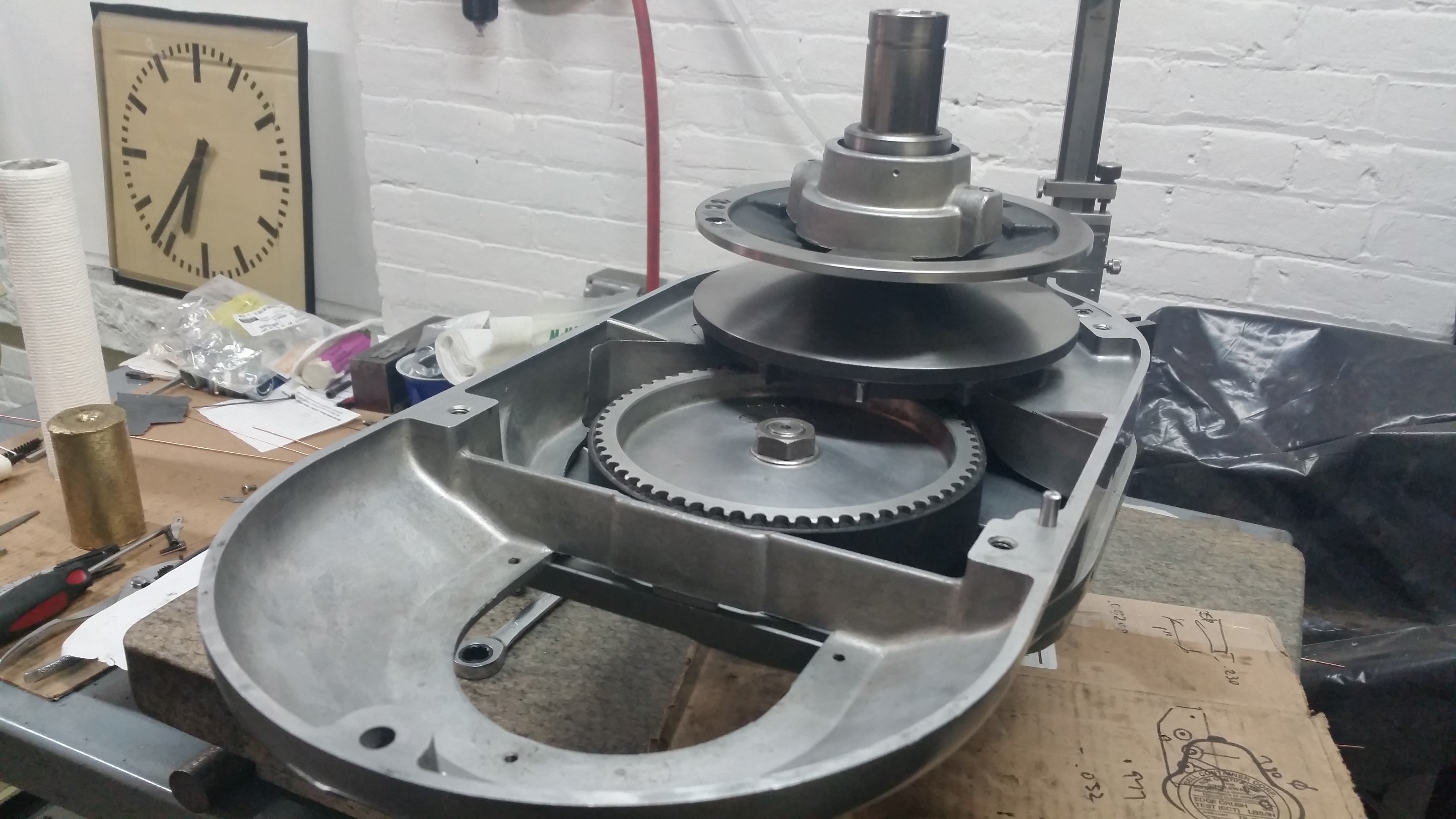

On the Bridgeports the upper shaft (where the vari-disc goes) will separate from the lower which is connected to the high/lo back gear. The lower hub is splined and drives the spindle. I recently tore the head apart on my machine to do some service and to add an encoder. I found there is really no practical way to fit one inside directly mounted to the splined gear hub as the hub moves up and down. I added the encoder to the top like on the OP's machine. I use KS tooling and don't have a draw bar.
NCpatrol's machine is different than my standard knee mill but I bet the backgear mechanism is similar. His has the annoying varidiscs replaced with a fixed pulley. We just have to figure out the lower gear ratio. I failed to count the gears on mine and have not yet configured that correctly for back gear. I'll have another look. In the mean time, if anyone knows the back gear ratio please post. Thanks!

That pretty much falls in line with the other info I've found. I do have the original manual for my machine. I need to scour it and see if the ratio is listed in there. I do know there is some variance in ratios between different generations and styles of bridgeports.
Another question I have - isn't index only used for multi-pass tapping? Is it really needed for tapping on a milling machine? If I didn't care about that, could I get away with dividing the encoder by whatever ratio my back gear is?
