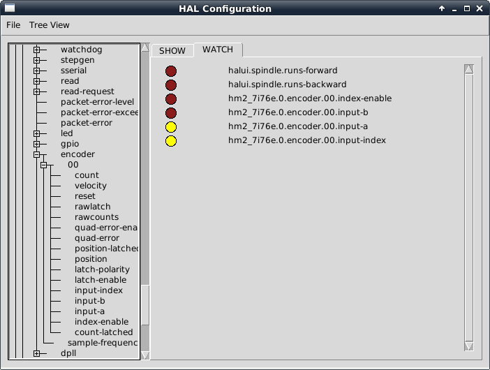

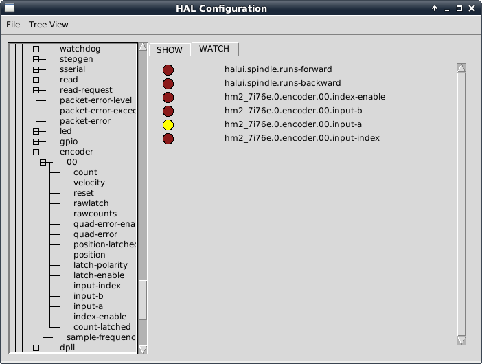

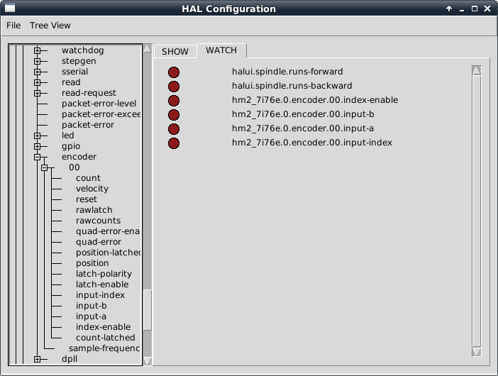

Hi!
I'm having trouble to get the G76 threading to work.
When trying to run a program with G76 the lathe starts the spindle and moves to start point, after that nothing else happens it just sits there with spindle running.
My first thought was that the index signal didn't come through but i get signal on both input-A and input-B using the watch function in HAL configuration.
So i guess something is not configured correctly but i cant figure it out.
The lathe is a Emco Turn 120P converted with Mesa 7176E, i kept the original encoder that has one 1ppr signal and one 360ppr signal.
I've attached the NC-program, .ini and .hal files and also some screen shots of HAL configuration/Watch
Any ideas?
Best regards Victor

Replied by PCW on topic G76, Troubleshooting needed!
Assumimg index is working, I think there are two possibilities here:
1. motion.spindle.at-speed false
(check state when spindle running and then check hal connections)
2. Spindle encoder not counting or counting backwards
( verify that this counts UP by 1.00 for each FORWARD turn of the spindle )

Hi!
Thanks for your response PCW!
So when checking "motion.spindle-at-speed" using HAL meter it shows TRUE, it doesn't mater if the spindle is off, at 3000rpm or during acceleration / de-acceleration it always shows TRUE, so it does not seam to work?
When checking hm2_7i76e.0.encoder.00.count using watch function in HAL Configuration it started at -108235 or something and continued to increase so after a bit of running it is now -377404 and it doesn't mater if i run cw or ccw it still increases but i guess that has to do with the fact i don't have a quadruple encoder.
Edit: i also check how many pulses that was counted after approximately a full turn on the spindle. and i got about 150 pulses, is that odd due to the fact i got a 360PPR encoder?
The spindle speed in axis is about the same as what my rpm meter says the chuck is spinning IRL.
Br Victor

That is decreasing.
It is counting backwards. Change the sign of the spindle encoder scale (probably in the INI) and it should work.
Replied by andypugh on topic G76, Troubleshooting needed!
That is decreasing.
Last edit: 14 Oct 2018 16:51 by andypugh.

Hi Andy!
That did the trick!
I changed ENCODER_SCALE from 150 to -150 and G76 started working!
Thanks to both of you!
