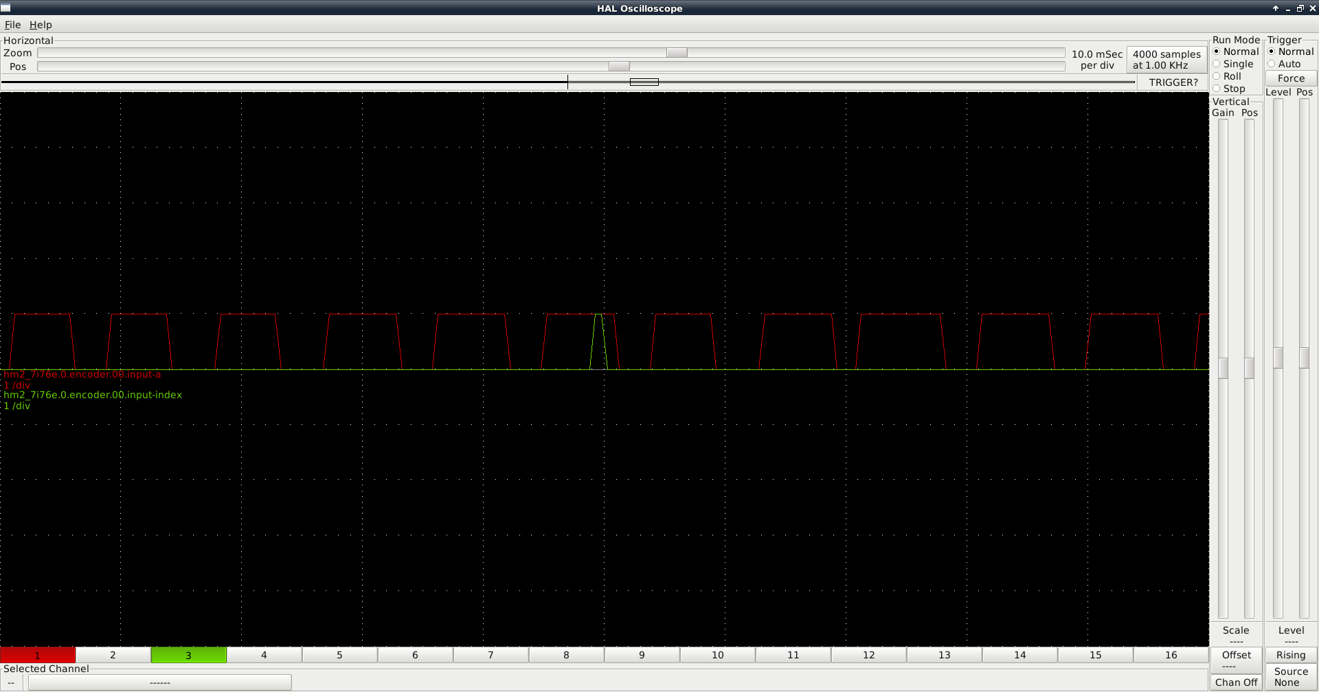

I mean using halscope to see if the encoder position or velocity are noisy

Ok, So i did a Hal-Scope of the Input-A signal and the Input-index signal.
Picture HAL-Scope-1, HAL-Scope-2, HAL-Scope-3 is when just running the spindle at 1200rpm-ish.
Picture HAL-Scope-4, HAL-Scope-5, HAL-Scope-6 is taken during the stuttering that occurs when using G76/G33 with 1200rpm / 1rev per turn in feed.
Br Victor

Yeah those are pretty lumpy
I suspect you will need to low pass filter the spindle encoder position to get
clean tracking (say 20-50 ms time constant)
