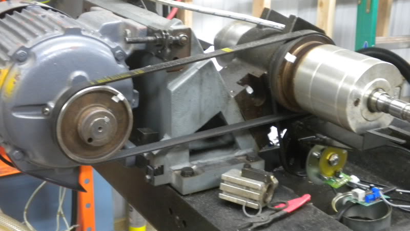

Hi Andy.
Today the encoder is mounted below the spindle shaft with a timing belt 1:1 to the spindle shaft.
no mater what encoder i get i think i have to make a bearing housing for the timing pulley shaft and attach the encoder to that shaft.
i'm more worried if the encoder it'self is a good choice and what ppr i should get.

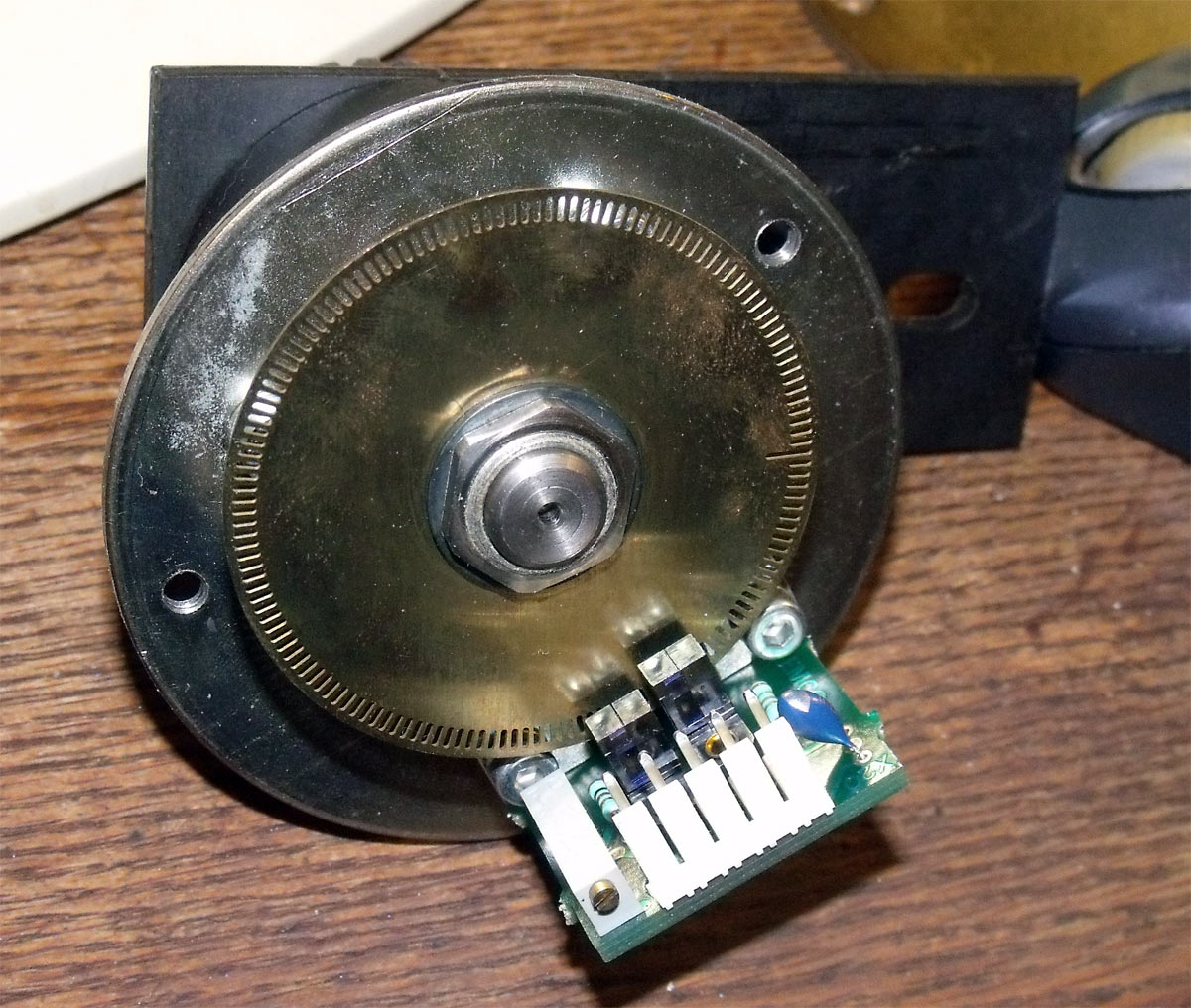

Edit: found a couple images of the stock encoder online, added them to attached files
Br Victor

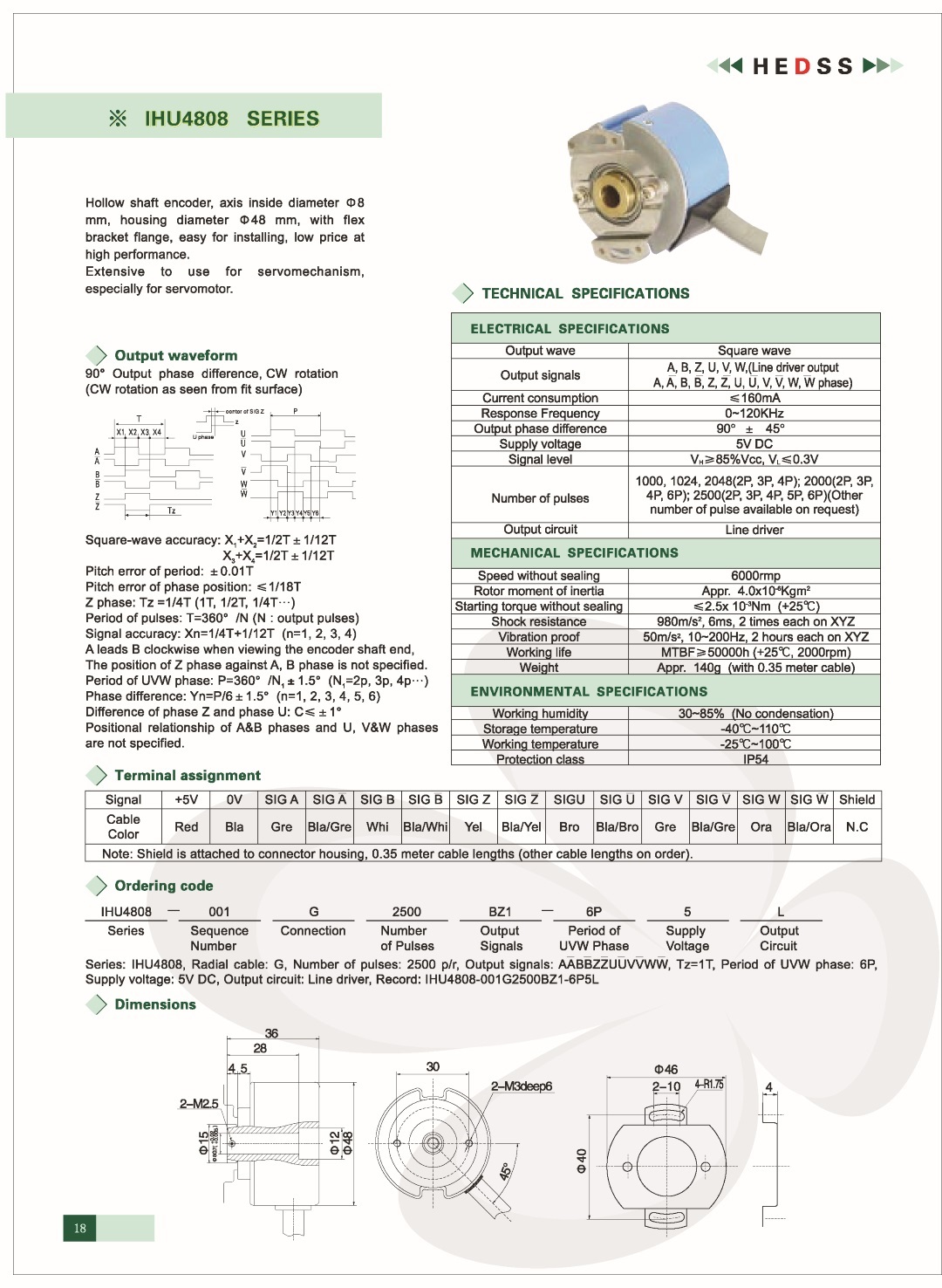

I figured since the encoder is almost 30 years old and i only have A & Index pulse i might as well change it, rigid tapping would be useful.
Are there any numbers in the specifications on the one i suggested (HEDSS - IHU4808) that i should be concerned about?
And what would be a good ppr count?
Br Victor

Are you sure that the encoder only has A + Z? The photo shows enough pins for 0V, 5V A B Z. And the sensors look like they could be dual-channel ones.
There is an adjustment pot on the encoder board, does that improve the mark/space ratio?

i have four wires, V+, GND, 1ppr and 150ppr signal.
