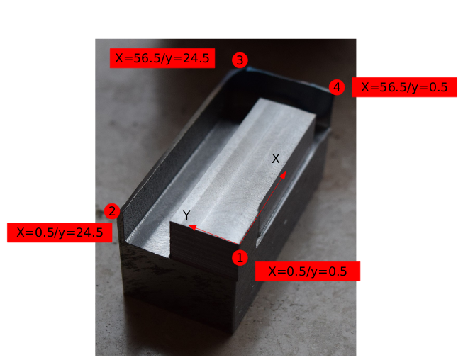

Today my first gcode program went wrong. I wanted to mill a simple rectangle contour by using the tool radius compensation.
The raw material dimensions were 57mm x 25mm and i wanted to mill it to 56mm x 24mm.
The path from point 2 to 3 to 4 went wrong, but i do not understand why. In the tool table i added a 10mm tool.
Tanks for any hint.

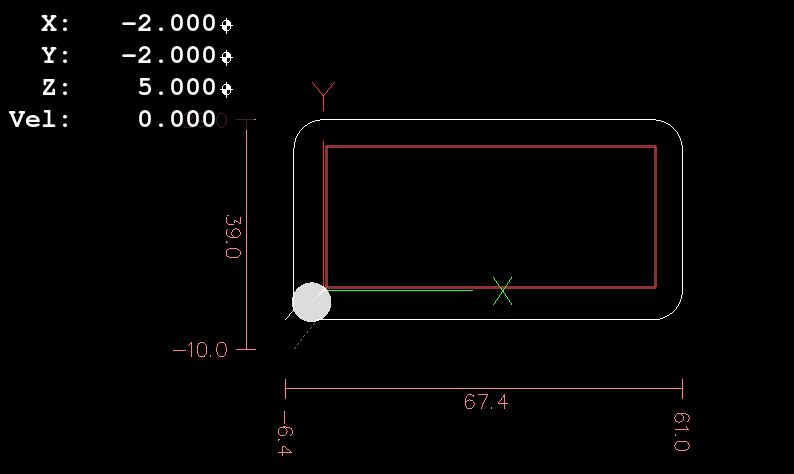

24 Dec 2018 12:56 #122833 by jbraun
Replied by jbraun on topic Gcode went wrong
Here's an attached png to clarify what I posted earlier.
The red is your file with no tool loaded and no D in the G41 line. You need one or the other for linuxcnc to read the tool table.
The white is a compensated path with a lead-in, notice how it rolls around corners.
It's not hard programming if you follow the rules.
Merry Christmas to you as well.
