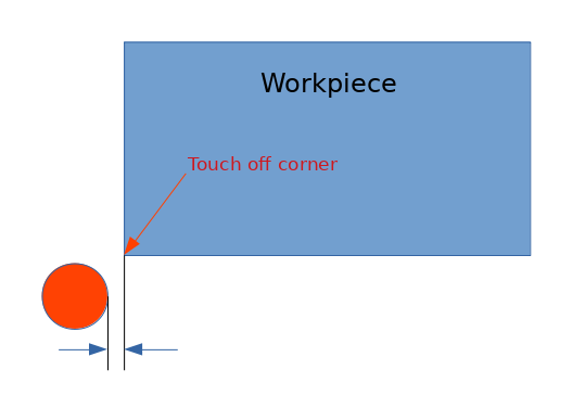

03 Jan 2019 14:31 #123405
by mane
Replied by mane on topic Gcode went wrong
I tried to start the g-code several times but something is wrong.
I use the AXIS GUI and followed this sequence described in the documentation under 4.1.2.1
After homing the axes and loading the g-code i touch off the workpiece in x,y,z each 0.000 mm with G54
Then i run the program line by line. But at line "G41 X0 D10" there is an offset of about 5mm as shown in the picture.
G17 G21 G40 G61 G54 F200
#1 = 56
#2 = 24
G0 Z3
G0 X-20 Y-20
G0 Z-5
G41 X0 D10
....Please Log in or Create an account to join the conversation.

03 Jan 2019 19:11 #123421
by MaHa
Replied by MaHa on topic Gcode went wrong
If your touch off tool has radius greater 0 . Then this radius must be entered on touch off. Tool centerpoint should be on X0 Y0. Retract Z, G0 G54 X0 Y0 to check. After your cutter compensation is applied. If you don't want toolchange M6, maybe at least load Tool M61 Q10. Then this tooldata will be respected, using G43, G41, G42. Possibly reducing source for faults.

04 Jan 2019 11:48 #123465
by mane
Thanks a lot. Now its working.
