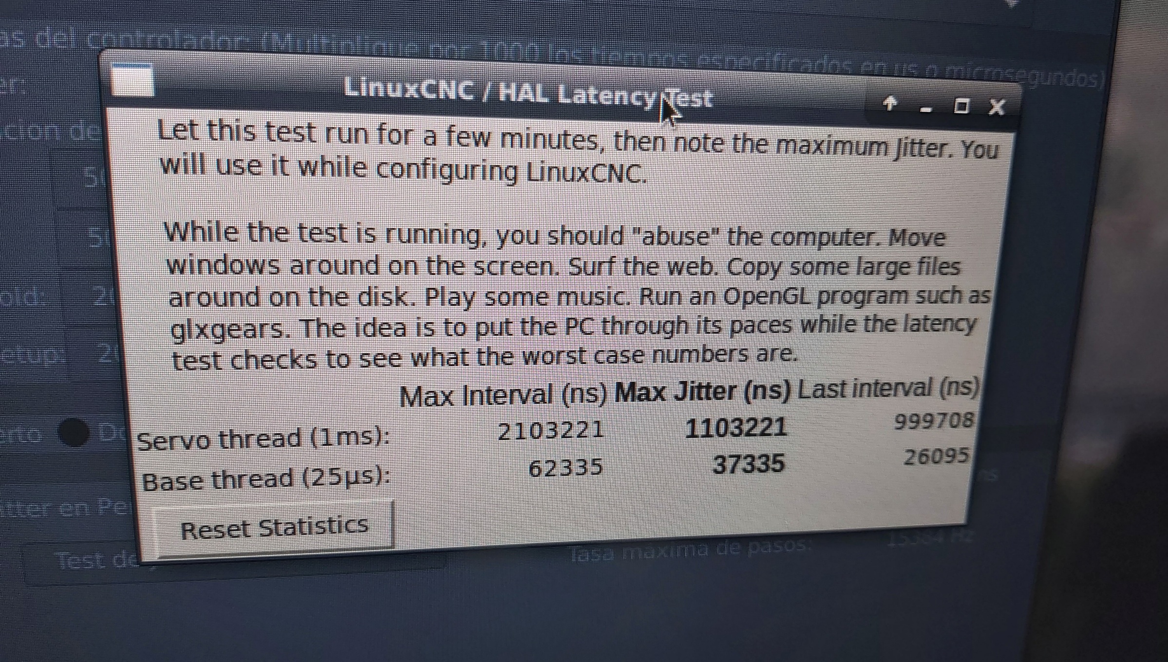

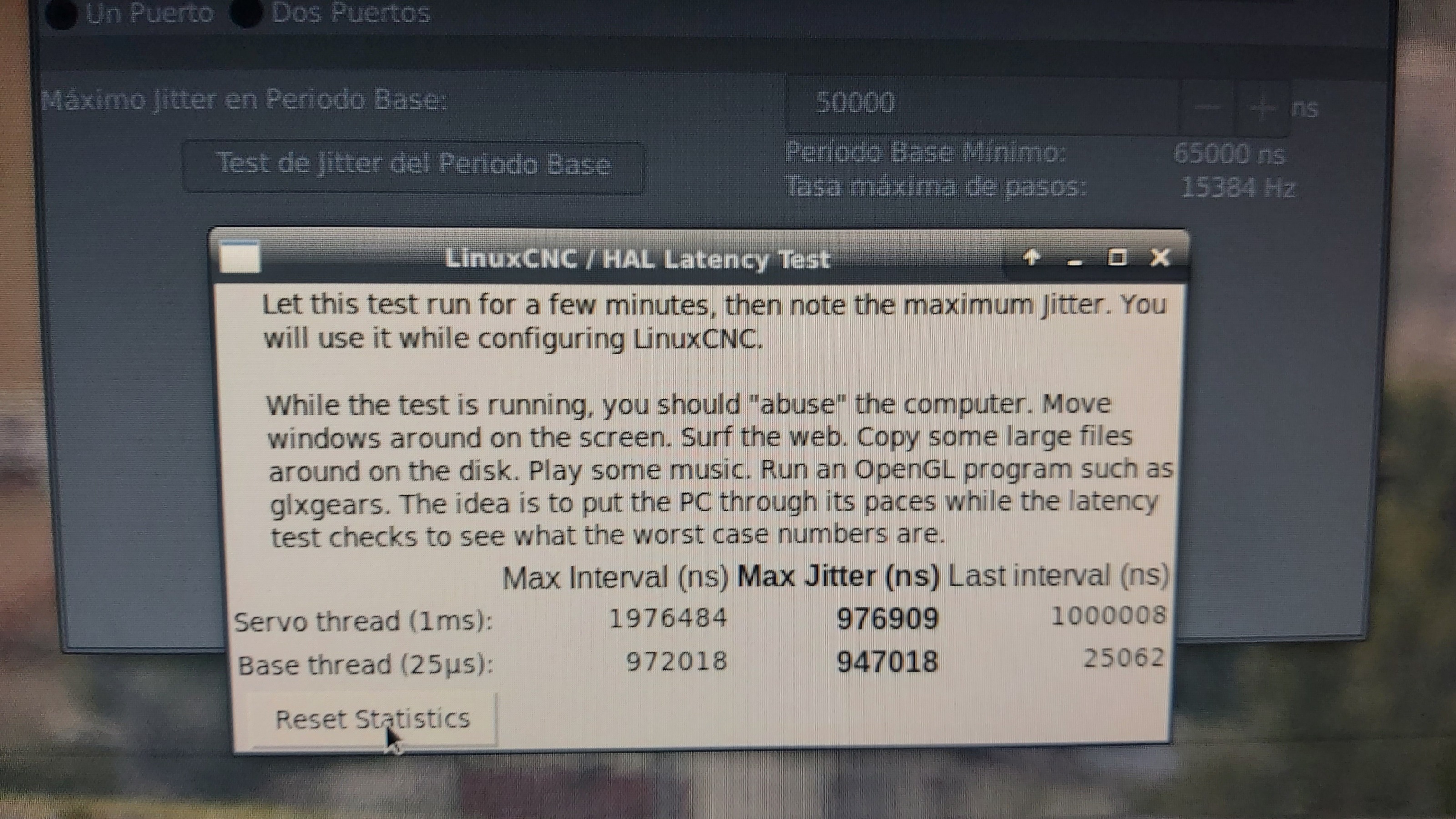

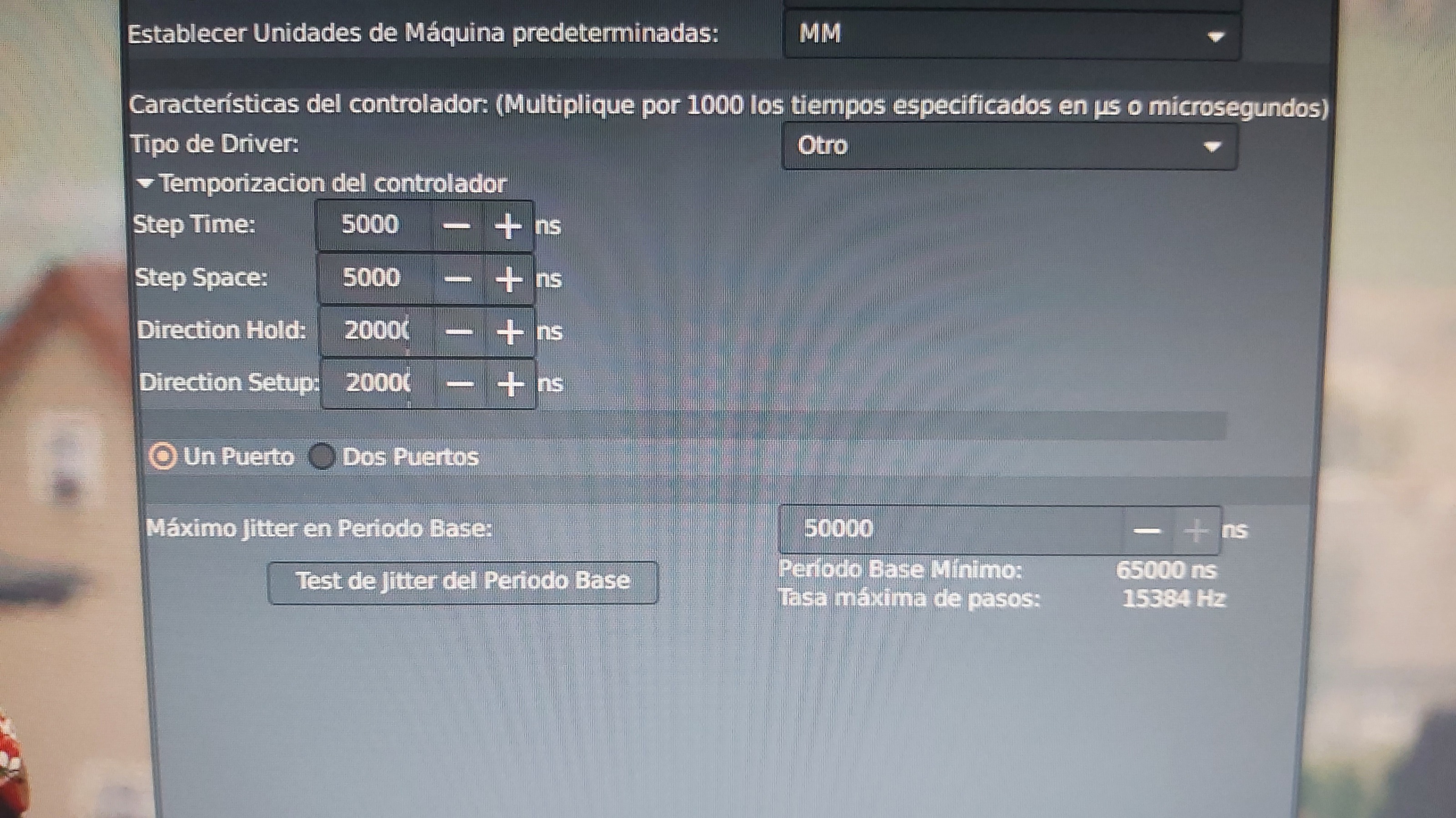

here I have what came by default and based on period maximum jitter I have the maximum which is 50000, I don't know if it is correct. I leave some images.
Replied by Ismacr63 on topic G76 problem
Before, I used mach3 with more speed than in linuxcnc and I didn't have problems of losing steps.
It is possible that Mach3 wasn't managing the requested step times (ie, it was lengthening them). What step time and step space are you using?

The second image shows some very bad jitter numbers.

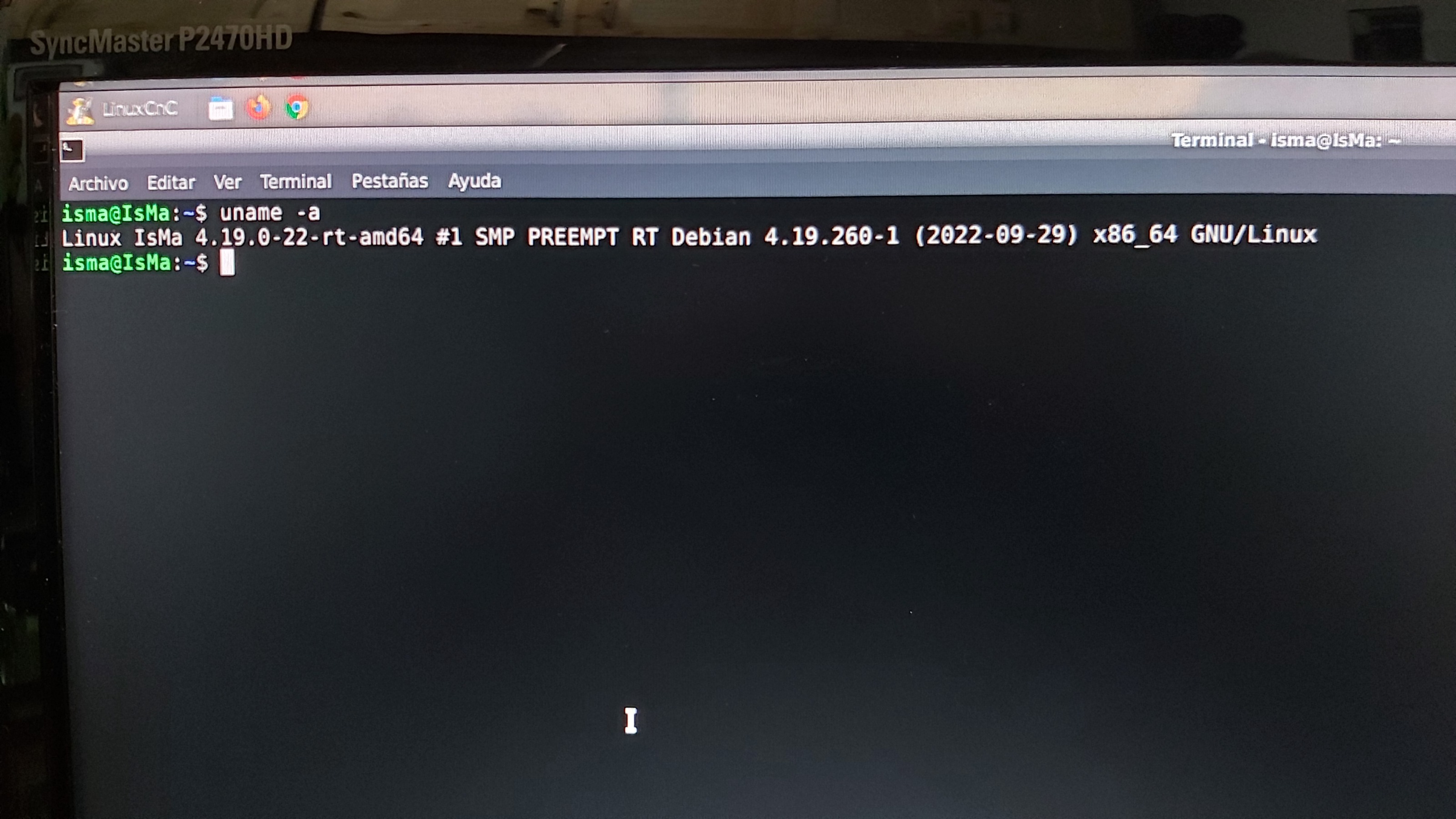

What does "uname -a" say?

Do you mean what I show you in the image?
Forgive my ignorance but I'm new to this.
- Posts: 19904
20 Dec 2022 12:19 #259973
Replied by andypugh on topic G76 problem
Yes, that. (though you should be able to copy and paste)
The latency / jitter in the previous screen shot was so bad that I wondered if the machine had booted into a non-realtime kernel.

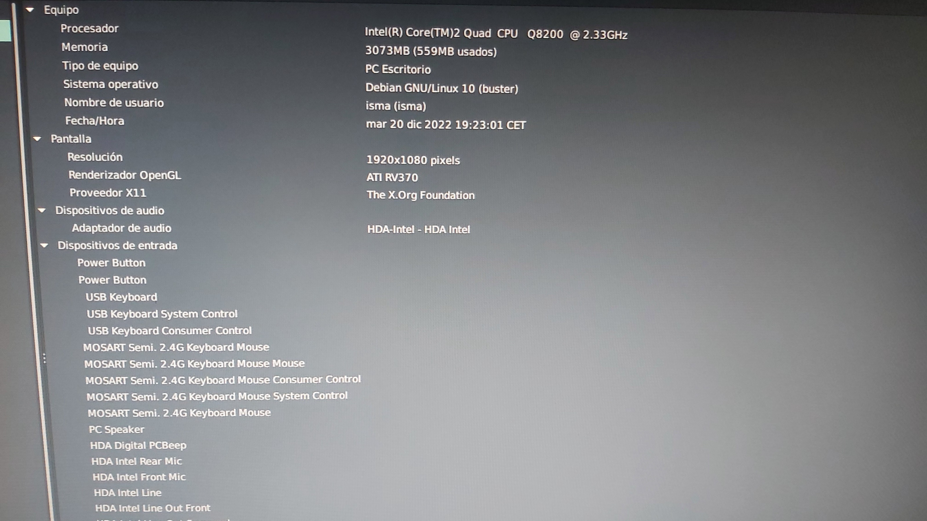

These are the PC specs.
I put the image because I write to you from my mobile phone, because the network cable of this PC has broken and I have to put one.
what could be the latency problem?
do you think i would need a higher pc?

The PC should be more than fast enough. Linuxcnc doesn't require any particularly high performance CPU (even a Raspberry pi can be adequate.)
The problem is more likely due to BIOS or mother board configuration settings that are poorly configured for real time performance. Make sure things like Hyper-threading are turned off and power saving features are disabled (C-states set to their lowest levels.)

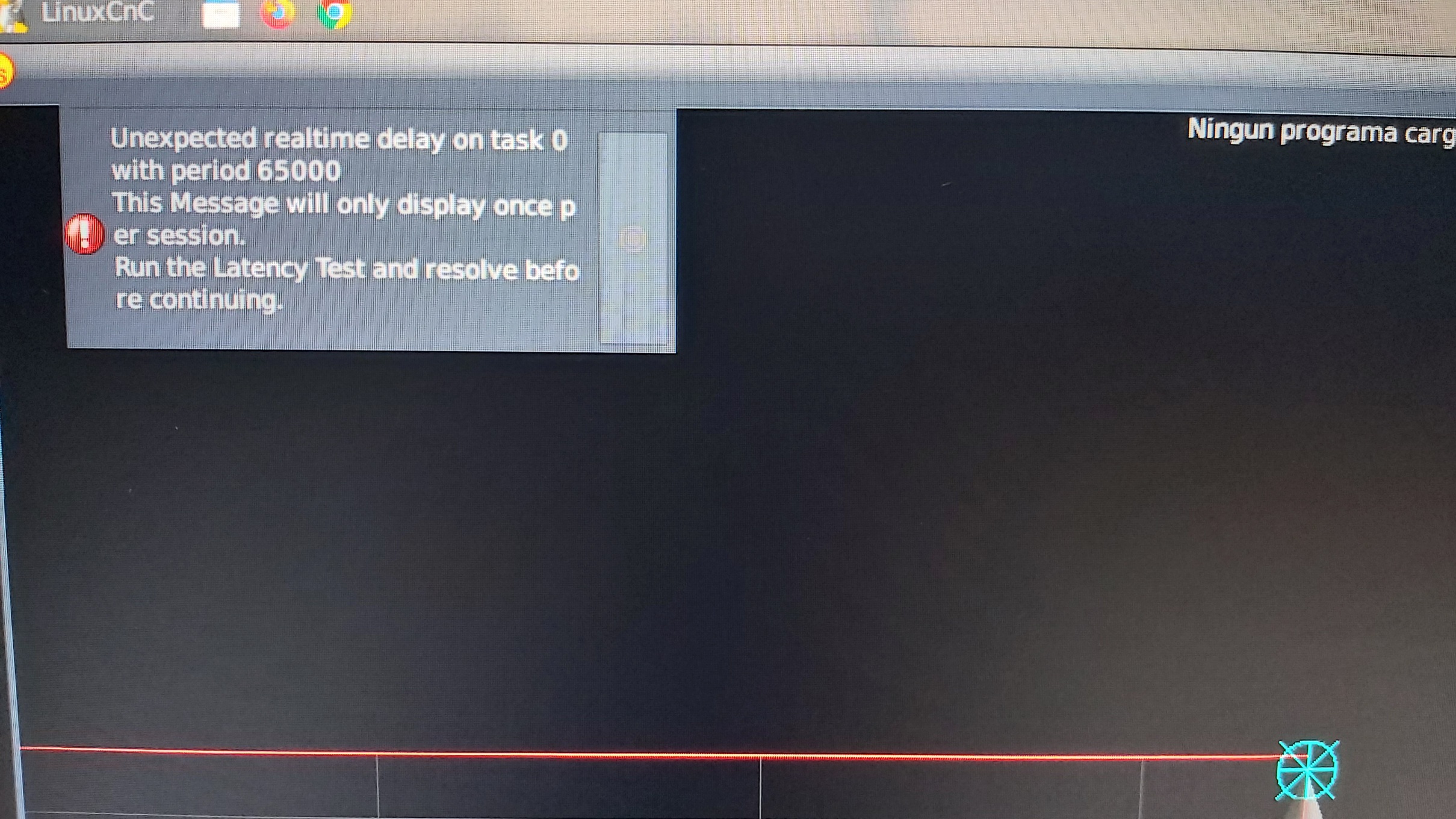

I have disabled some bios options that I think are energy saving, (nothing has happened with latency).
I have also changed the processor for another one that I have and the latency has gone down, but it is very strange.
before with the other processor linuxcnc didn't warn me of anything, and now that it has much less latency it does warn me.

The servo thread latency there is still terrible.
1.1ms latency on a 1ms thread can't work.
It's strange that the base thread is OK.
