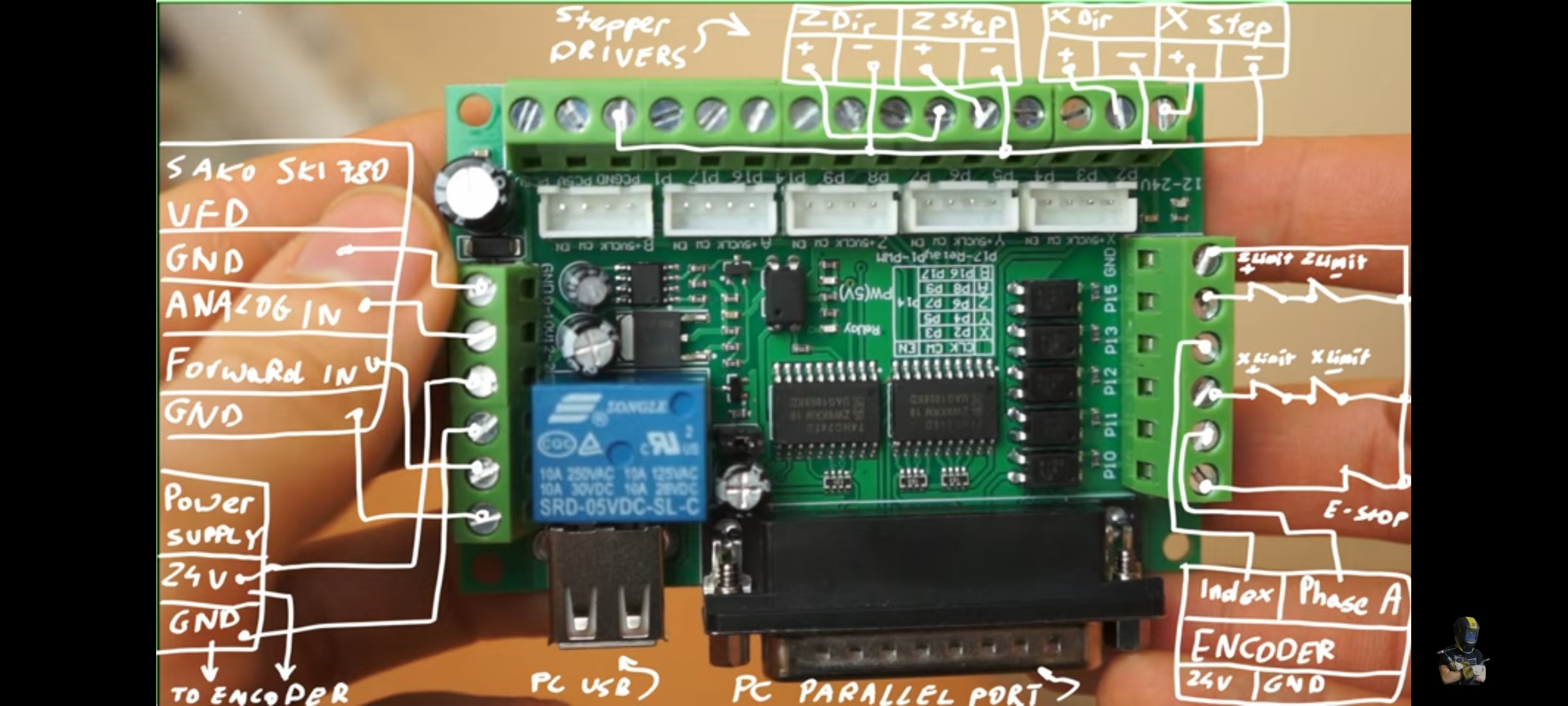

Do you have a circuit diagram for the stepper drive control pins?
17 Dec 2022 23:52 #259786 by Ismacr63
Replied by Ismacr63 on topic G76 problem
I used this diagram that I found on the net.
17 Dec 2022 23:56 #259788 by andypugh
Replied by andypugh on topic G76 problem
That's the BoB, not the stepper drive.
18 Dec 2022 00:03 #259789 by Ismacr63
step​per drive.
are you referring to this?
18 Dec 2022 00:22 #259790 by andypugh
Yes. That indicates that the drives use differential inputs, so as long as you have 7i76 step + to drive step + (and so on) then it isn't a step polarity issue.
