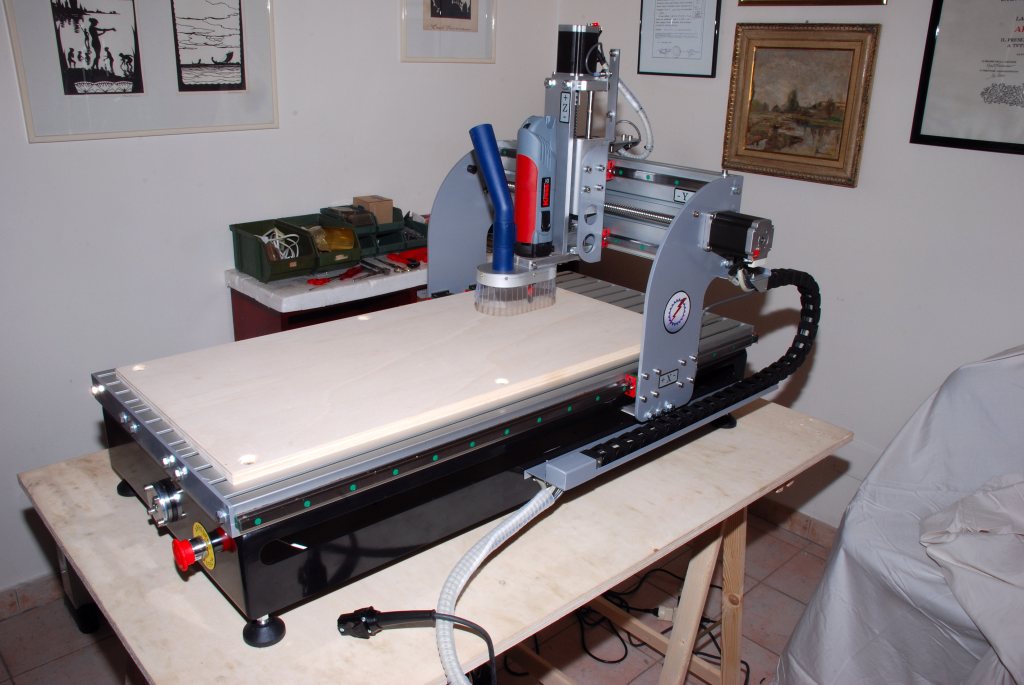

08 Nov 2011 17:39 #14685 by ioiotutu
Replied by ioiotutu on topic Re:Keyboard re-mapping (key binding)
Here is the photo.
If i stay left side all is ok, but usually i stay in front and i confuse me with jog.

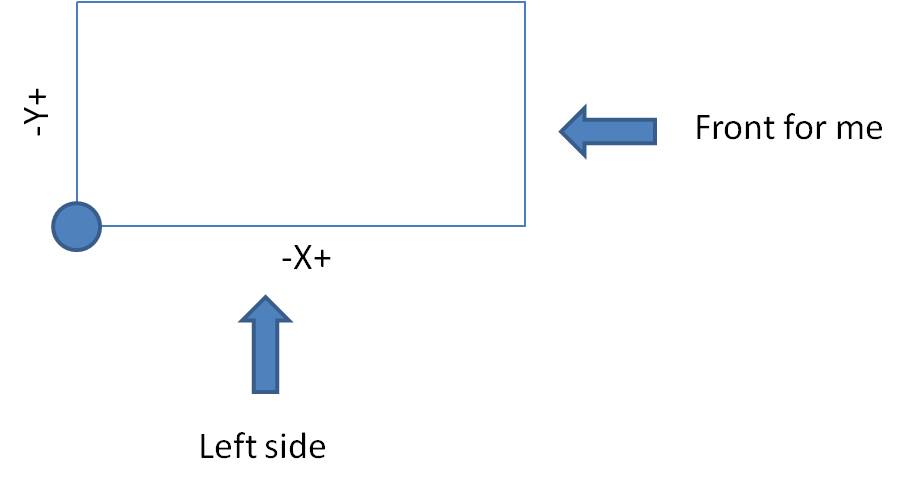

08 Nov 2011 17:49 #14686 by ioiotutu
here is a scheme.
08 Nov 2011 19:01 #14690 by BigJohnT
Replied by BigJohnT on topic Re:Keyboard re-mapping (key binding)
Ok, that makes sense the machine is correct but you don't stand in the conventional position. Have you give any thought to using a joy pad to jog with instead of lugging the keypad to the machine? Otherwise you would have to modify axis.py to change the key bindings. I scanned through the 3400 lines of code and nothing jumped out at me.
