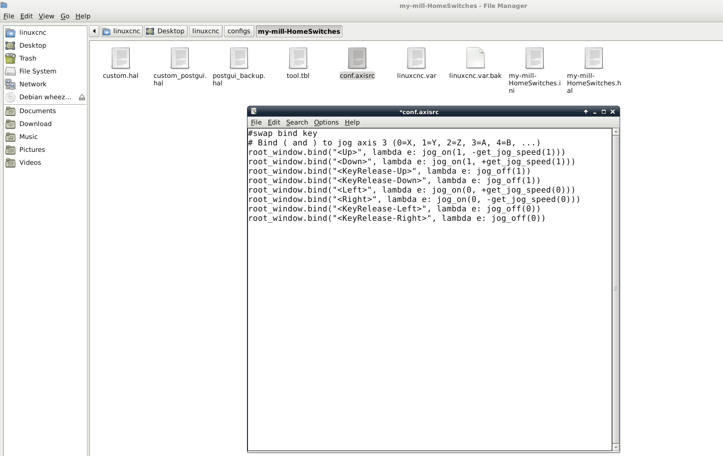

01 Feb 2018 07:57 #105280 by Lazarov
Replied by Lazarov on topic Keyboard re-mapping (key binding)
Hello.
I trying to change the buttons on the keyboard but it does not work.
Left Arrow --> X-
Right Arrow --> X+
Up Arrow --> Y-
Down Arrow --> Y+
Where should I create the .axisrc file?
Here is my code in .axisrc file:
#swap bind key
# Bind ( and ) to jog axis 3 (0=X, 1=Y, 2=Z, 3=A, 4=B, ...)
root_window.bind("<Up>", lambda e: jog_on(1, -get_jog_speed(1)))
root_window.bind("<Down>", lambda e: jog_on(1, +get_jog_speed(1)))
root_window.bind("<KeyRelease-Up>", lambda e: jog_off(1))
root_window.bind("<KeyRelease-Down>", lambda e: jog_off(1))
root_window.bind("<Left>", lambda e: jog_on(0, +get_jog_speed(0)))
root_window.bind("<Right>", lambda e: jog_on(0, -get_jog_speed(0)))
root_window.bind("<KeyRelease-Left>", lambda e: jog_off(0))
root_window.bind("<KeyRelease-Right>", lambda e: jog_off(0))
Do you have any idea?
Š¢hank you in advance.
01 Feb 2018 08:19 - 01 Feb 2018 08:20 #105281 by Lazarov
I'm sorry I did not understand where I was supposed to put the file but now I put it in the right place and it all worked.
