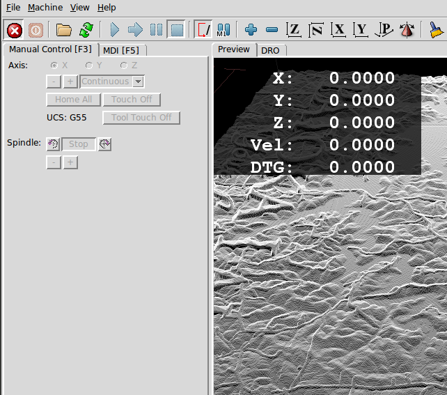

Entering the following in ~/.axisrc or a USER_COMMAND_FILE will give you a label on the F3 tab with the current UCS.
W = root_window.tk.call
W('label','.pane.top.tabs.fmanual.jogf.zerohome.ucs','-text','G5x')
W('grid','.pane.top.tabs.fmanual.jogf.zerohome.ucs','-column','0','-row','2','-sticky','w')
def user_live_update():
W('.pane.top.tabs.fmanual.jogf.zerohome.ucs','configure','-text','UCS: ' + all_systems[o.last_g5x_index].split()[1])

In. Deed! I been swooped sure enough. I just appended it to what I found already in .axisrc (a single line, which was already a root_window.tk.call) and it worked! (This would be the TCL/TK approach, right?)
I couldn't see it at first, because I was looking for it in the "graphic" model-Preview window, but lo, there it is! nestled under the "Home All" button. Byoo tee full. [See attachment. Shameless plug of one of my cool topo maps.]
Thank you Phil.

Thanks a lot for this code. I tried it in my sim, 2.7.15. The dispayed Gn was always 1 ahead, eg. G57 in effect, G58 displayed. So i changed this line
to
and it is displaying the active UCS now.
W('.pane.top.tabs.fmanual.jogf.zerohome.ucs','configure','-text','UCS: ' + all_systems[o.last_g5x_index].split()[1])W('.pane.top.tabs.fmanual.jogf.zerohome.ucs','configure','-text','UCS: ' + all_systems[o.last_g5x_index-1].split()[1])and it is displaying the active UCS now.

Interesting, I didn't try it with running gcode, just MDI commands.
