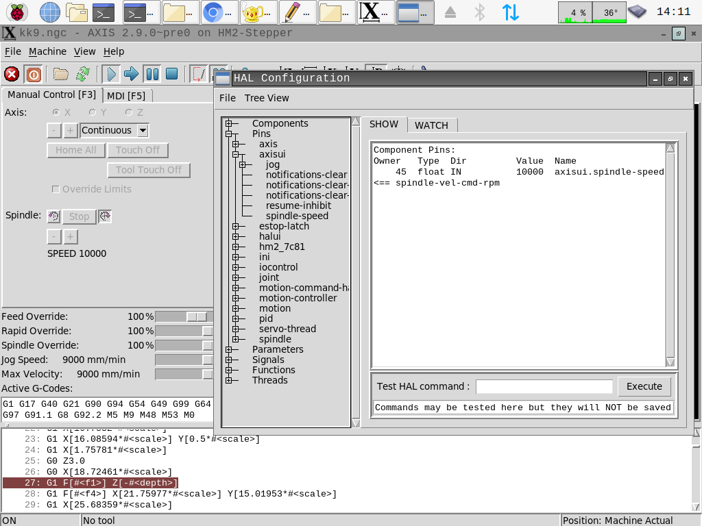

yes, i thought the same thing, display spindle speed, so i also used this thread to get me there. here is a fast and dirty one for you, because I am using my spindle speed in a different area. it is not as clean as phils, because i dont know how to leverage the python interface very well yet. it might be something like this linuxcnc.stat.spindle.speed . because im not so good, im making a halcomp and linking it to spindle speed in hal, so make sure your spindle is linked to spindle-vel-cmd-rpm in hal
add this the same way you would with g5x UCS.if you want to use both (g5x and spindle speed) you need to merge the user_live_update sections of the 2
pyvcp will not work properly with the way I have done spindlespeed with a new comp pin
here is the thread where I am playing with axis stuff, my main examples for spindle speed are located here
forum.linuxcnc.org/21-axis/40373-search-bar-and-gcode-scroll

# shortcut saves typing
W = root_window.tk.call
# create the label, the text will be over written later
W('label','.pane.top.tabs.fmanual.spindlef.spindle-speed','-text','SPEED')
# the position of the label, I changed it from the homing section, it makes more sense in spindle
W('grid','.pane.top.tabs.fmanual.spindlef.spindle-speed','-column','0','-row','3','-sticky','w')
# this updates the spindle label when every it changes, and also re-configures the text
def user_live_update():
W('.pane.top.tabs.fmanual.spindlef.spindle-speed','configure','-text','SPEED %3.0f' % (comp['spindle-speed']))
### this creates new axisui halpins and connects them to existing signals , spindle speed is now viewable under axisui pins in hal config
def user_hal_pins():
# create new hal pins
#mycomp = hal.component('feed')
comp.newpin('spindle-speed', hal.HAL_FLOAT, hal.HAL_IN)
hal.connect('axisui.spindle-speed','spindle-vel-cmd-rpm')add this the same way you would with g5x UCS.
USER_COMMAND_FILE = usercommand_justspeed.pypyvcp will not work properly with the way I have done spindlespeed with a new comp pin

Replied by nau on topic [Yes. YES.] Is there a way to display the current UCS [G5n setting] in AXIS?
Dear cakeslob,
Thank you very much for such a clear explanation. Now I do understand how it's works and my Axis looks exactly as I wanted.
