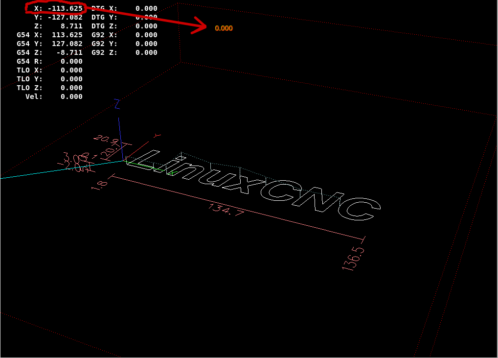

Tl; dr
Is there a way to reset the X and A- axis machine coordinates or re-home from G-code?
Assuming there is no way can someone point me to the right Part of the source code so I can add a few lines and re-compile linuxcnc.
Or if there is a solution using nml that would be appreciated too.

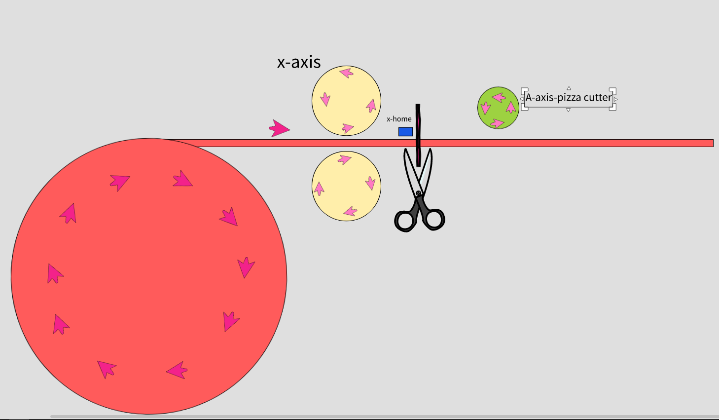

Hello Everyone,
I have this quite unusual machine where the material is fed by rollers(yellow). The travel of X is "infinite".
After The Scissors cut off the material the machine is "homed" eg the X-axis should be at 0.0000
Linuxcnc assumes X has a fixed length in machine coordinates I guess
So I could not find a way to reset X without rewinding it which would push out the material as it has already been cut off.
G92 did nothing to the machine coordinates.
Using offsets G54 ... does not work either for my case as this is a pretty fast machine that is being fed several G-code files a minute generated by another program.
The X value could exceed the variable size in which it is stored.
Re-homing the machine manually just takes too long and can be forgotten doing it several times a minute.
Thank you in advance.

The spool is 100 000 mm long and several spools are changed during the day.
If keep offsetting using G54 the G53 coordinate would exceed 999 999.
This is a mess I would like to avoid .
The machine is not using fixtures, using G54 G55... makes things just more complicated.
The easiest and best option is to reset the G53 coordinate as soon as the material is cut.
Because the machine is really at X0 then.
Same with the pizza cutter, it has no limits after cutting it should be zeroed.
If I just could reset the G53 Variable this would solve everything.
