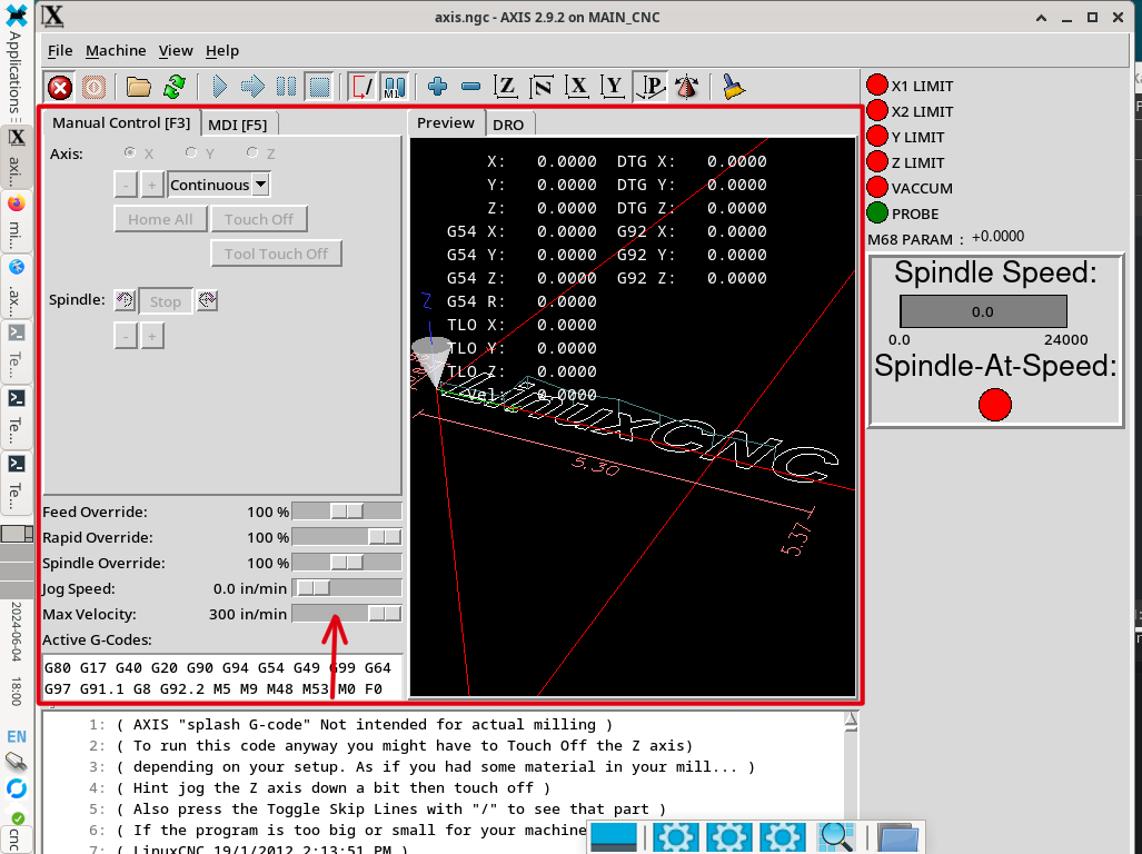

I just updated to newest version from wheezy. Looks like now the active gcodes has been moved out of the mdi tab view
, but now contributing to top pane height increase? The result is axis hangs below the bottom of the screen.
Could someone give me a hint as to what command would let me reduce the height of the top pane?
I am able to increase its height using the .axisrc file by usingbut it seems something inside stops its height from being reduced any further and this has no effect
For now I am going to scale my resolution until I have more time to look through the code.
root_window.tk.call('.pane.top','configure','-minsize',5000)root_window.tk.call('.pane.top','configure','-minsize',250)For now I am going to scale my resolution until I have more time to look through the code.

Try this:
You may also need to play with these for the bottom pane:
root_window.tk.call('.pane', 'paneconfigure', '.pane.top', '-minsize', 250)You may also need to play with these for the bottom pane:
root_window.tk.call('.pane', 'paneconfigure', '.pane.bottom', '-minsize', 250)
root_window.tk.call('.pane', 'paneconfigure', '.pane.bottom', '-height', 250)

yeah there are a few things you need to adjust, i dont remember it being as simple as just changing pane.top
dont remember exactly what I did, but you can refer to my 2 other files to play with, i did these specifically for small screens
www.forum.linuxcnc.org/21-axis/38188-sol...screen-w-usercommand
www.forum.linuxcnc.org/21-axis/49372-reg...od-based-on-plasmac2
edit, ok i went back to double check, because i remember it took me a long time to bruteforce the winning combo
i think .pane configures its min height for all the widgets, then hides them after, because just trying to change the height never worked
########## resize bottom pane #######
root_window.tk.call('.pane','paneconfigure','.pane.bottom',"-stretch","always","-height","200");
######### resize top pane ########
#root_window.tk.call('.pane','paneconfigure','.pane.top',"-stretch","never","-minsize","300");
########### window resize #########
root_window.tk.call(".pane","configure","-height","350");

That did the trick, I am up and running. Not sure I would've ever figured that out.
