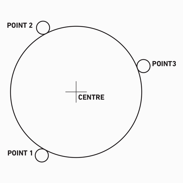

Hello all,
I'm a basic user of LCNC - I know it reasonably well, but don't use a tool changer, only have a basic through tool Z probe which gets occasional use - you get the idea: my set-up is pretty rudimentary but I get good results and productive use out of the software.

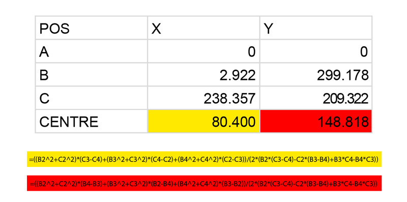

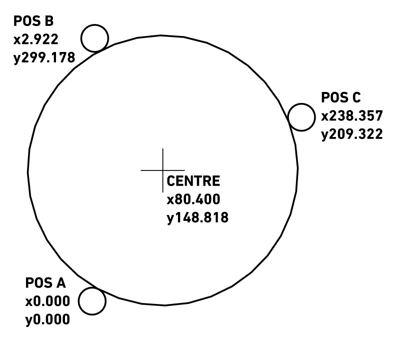

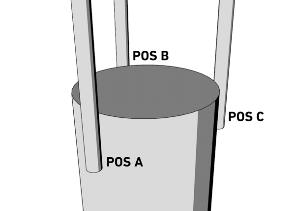

When I need to find the centre of a circular feature I've been touching a dowel off at three points around a circumference (fag paper or multimeter method) and feeding three sets of X,Y coordinates into a spreadsheet which then works out the centre for me, like so:
Here's the sheet in OpenOffice format.

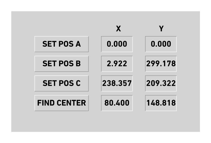

It works, but I was wondering if there was a way to incorporate a simple centre finder tab into the interface, something that would look a little like this:
The first three buttons to touch off the three positions on the circumference and the 'FIND CENTRE' button to perform four ops:
Calculate the X,Y centre coordinates
Lift the Z axis to its G53 0
Move to the calculated X,Y centre
Set G54 (or current WCS) X,Y to 0,0
So I guess there would need to be six variables that get written using date from 'current position' numbered parameters #5420 & #5421
POSA_X
POSA_Y
POSB_X
POSB_Y
POSC_X
POSC_Y
And then the two calculated variables that are used in a subroutine to lift and move the spindle to the centre and zero out X,Y at the new position
CNTR_X
CNTR_Y
I get that this is still clunkier than using a probe, but I honestly have little need for one!  If I have to keep punching the numbers into the spreadsheet then that's fine, but to have this in a tab would be cool.  Am I thinking about this in the right way?
How would you tackle it?
Many thanks.

31 Aug 2025 11:01 #334185 by andypugh
Replied by andypugh on topic Simple/Manual Centre Finder
Yes, that can be done. I would use GladeVCP because that allows you to automatically run Python code when a control value changes.
My gear hobbing screen has a similar thing, where entering the tooth counts and tooth pitch calculates a number of gear parameters.
There is a zip file here, though I don't know how much help it would be.
wiki.linuxcnc.org/cgi-bin/wiki.pl?Hobbing
You basically need 6 entry boxes, and two/three display boxes.
I would be tempted to add a button to automatically G0 to the centre, once found, and maybe another to set the origin.
(The latter two options would involve interacting with LinuxCNC using the Python Interface (probably using Pythin to create G-code command strings)

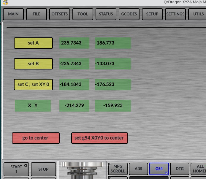

I used your formulas for calculating the center of a circle and created a widget for qtdragon that does it.
(There's also a Python function that calculates the center from three coordinates.)
You're using axis, so it probably won't be useful to you.
The following user(s) said Thank You: Waldemar

Nice work. Yeah, I'm on Axis - 2.8.4 although I'd be happy to hear about your method to set this up.
Have spent a few hours going around in circles trying to get Chat GPT to point me in the right direction. Managed to get a custom tab set up but that's about it - buttons proved problematic for one reason or another. I'll probably wait until I upgrade to 2.9 to try again but that might be a while. Spreadsheet for now..!
*Not my formulas - I found 'em squirrelled away on a Microsoft forum page.
01 Sep 2025 09:52 #334232 by JT
Replied by JT on topic Simple/Manual Centre Finder

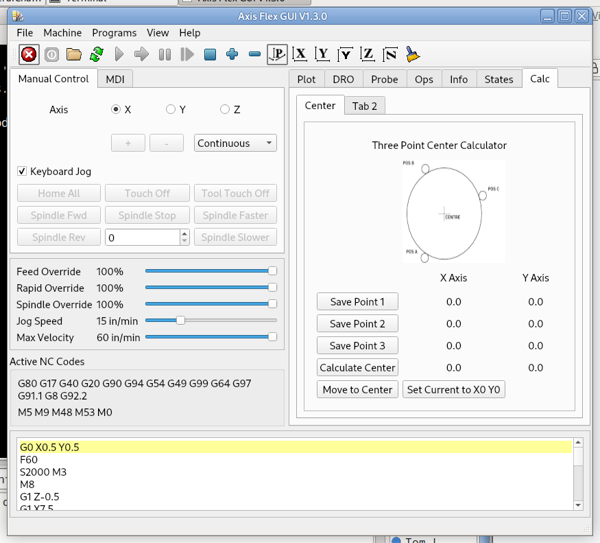

I would use Flex GUI because it's super simple to add a Python Module that is connected to the GUI.
Took me about 30 minutes to add the center calculator including debugging the formula from spreadsheet speak to Python speak.
If you're interested I can attach the code.
JT
01 Sep 2025 10:37 - 01 Sep 2025 10:38 #334234 by JT
Actually I'm going to add that to the Flex calculators so all you need to do is drag a container into the GUI and give it the proper name. You can't get much more flexible than that. I'll also add a go to center button.

Now you can just drag a container into any Flex GUI and name it and magically the 3 point center calculator shows up.
This is the Axis style Flex GUI
JT

01 Sep 2025 17:35 - 01 Sep 2025 17:37 #334244 by Waldemar
Replied by Waldemar on topic Simple/Manual Centre Finder
Great work JT. Looks ace. I can't see myself going over to Flex GUI - my 2.8.4 install is super stable and I'm one of those 'if it ain't broke...' guys (my mini mill runs an ancient version of LinuxCNC and has been for the last 11 years or so...) I'm about to install 2.9.2 on a spare stand alone PC to have a play with GladeVCP, so may try out Flex GUI on that machine once I've figured out I can't get anything to work in Glade...
Hey, if you need an image file that integrates better into your tab I'm attaching one here (says POINT 1 instead of POS A etc. is 1:1 ratio and the background colour should match your tab's bg colour).

The cool thing about Flex is you don't need to program anything, the center calculator is built in now. Glade is very old and might not work well with new OS's while Flex is based on PyQt6 and is the only gui to use PyQt6 the rest of Qt gui's use PyQt5 which is at EOL.
