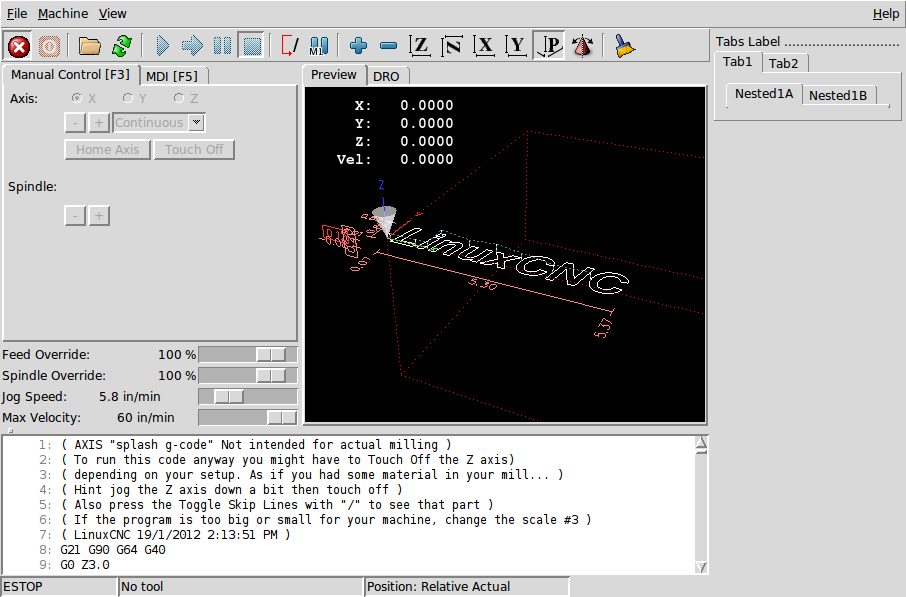

Here is my code...
This is what I get...
What am I doing wrong as to why the contents of the nested tab is not showing?

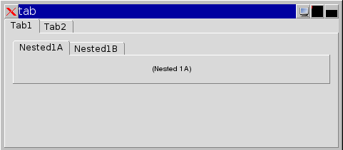

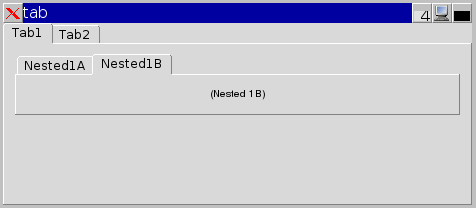

OK just done some tests
Your code is fine, but because you did not specify sizes or expand the widgets with the mouse, the contents of the nested tabs are hidden
I used this called tab.xml
and called it with
halcmd: loadusr -Wn tab pyvcp -c tab tab.xml
having stretched the widget a bit with the mouse to reveal the nestings, the results are
Using the pyvcp -g switch would have displayed the widgets at preset sizes and hopefully ensured the nestings were visible
"-g <WxH><+X+Y> specifies the geometry to be used when constructing the panel. The syntax is "Width"x"Height"+"X Anchor"+"Y Anchor". You can set the size or position or both. The anchor point is the upper left corner of the panel. An example is -g 250x500+800+0 This sets the panel at 250 pixels wide, 500 pixels tall, and anchors it at X800 Y0".
regards

and called it with
regards

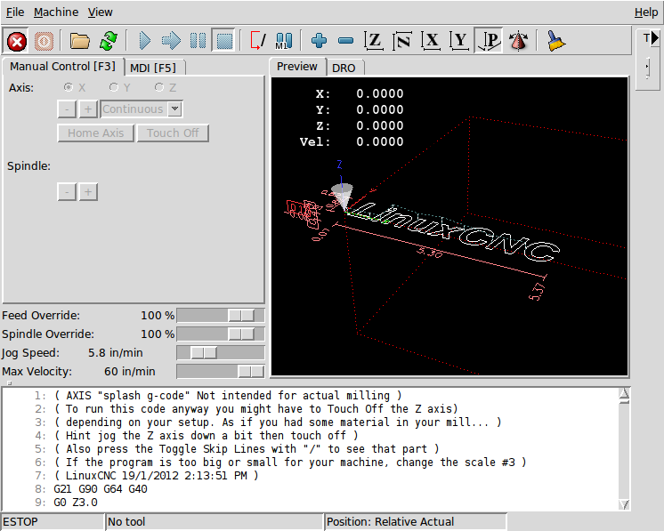

Also I am not using this as a stand alone widget but as a axis sidebar.

17 Oct 2013 22:21 #40015
by DaOne
Replied by DaOne on topic Nested Tabs Imposable?
JT,
Thats exactly what I get. I see nothing in the nested tabs.
