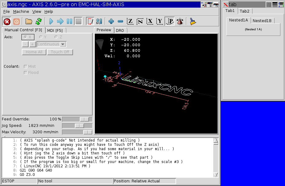

I also tried loading the pyvcp panel in the hal file but it does not embed into Axis. Unless there is a loadusr command string that will embed it into Axis???
JT
17 Oct 2013 22:52 #40018 by ArcEye
Replied by ArcEye on topic Nested Tabs Imposable?
Would you mind showing me where in the xml code I would be defining its size?
Unfortunately it does not work like that at present
If you call pyvcp directly you can use the -g [<WxH><+X+Y>] switch, but then you end up with a floating window
Axis does this to embed the pyvcp widgets
   if vcp:
        import vcpparse
        comp.setprefix("pyvcp")
        f = Tkinter.Frame(root_window)
        f.grid(row=0, column=4, rowspan=6, sticky="nw", padx=4, pady=4)
        vcpparse.filename = vcp
        vcpparse.create_vcp(f, comp)
    comp.ready()
vcpparse is a seperate file which parses the xml and creates the widgets.
I am going to have to look through pyvcp_widgets again, I may have to make some more changes, if it can be done at xml level
The only thing that might embed is something like
EMBED_TAB_COMMAND = halrun loadusr -Wn tab pyvcp -c tab tab.xml {XID}
in the ini file
I will try that in a bit
regards

17 Oct 2013 22:57 #40019 by DaOne
Replied by DaOne on topic Nested Tabs Imposable?
So if I am understanding correctly what I am trying to do is not possible at this time?
17 Oct 2013 23:34 - 17 Oct 2013 23:42 #40020 by ArcEye
in the ini file
No that doesnt work, it is spookly similar to how you embed a gladeVCP widget through
Will keep on trying.
It should be, but appears not to work with embedded widgets, because of the way they are created.
I am playing with tkInter.pack() at present, because that is what is used underneath.
EDIT
Well in fact the widget is based upon bWidget.notebook I have just found
I will have a dig into it to see what can be changed in pyvcp_widgets that might display the contents of a nested widget properly

19 Oct 2013 19:15 #40063 by ArcEye
Hi
Afraid I am giving up on this, the only solution I have found that works, is to create the pyvcp panel in a postgui.hal file with something like
loadusr -Wn tab pyvcp -c tab -g 200x300 tab.xml
If you must have nested tabs AND have it embedded, will probably be simpler to create the panel with glade.
regards
