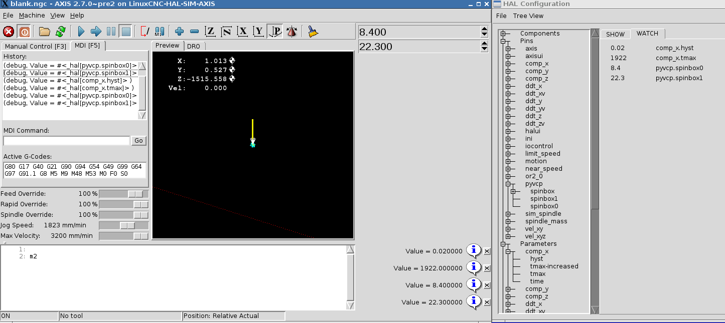

01 Feb 2015 18:22 - 01 Feb 2015 20:52 #55546
by ArcEye
Replied by ArcEye on topic SPINBOX DATA to G-Code Variable
Hi
It is quite simple honest.
I created a xml panel with 2 spinboxes
Then I put it in the ini file
and also the line to enable hal pin examination.
The BIG thing is to ensure your version supports this, I am using a RIP of 2.7 for this demo
The spinboxes are not 'netted' to anything, there is no need, their value can be interogated directly in gcode
Then I started the sim and set HAL Configuration to monitor 2 existing params which had a value and the 2 spinboxes
Then I use the (DEBUG, ........) statements in the MDI window to show the value of the 2 parameters and the 2 spinboxes
voila
regards
<?xml version='1.0' encoding='UTF-8'?>
<pyvcp>
<vbox>
<spinbox>
<halpin>"spinbox0"</halpin>
<min_>-12</min_>
<max_>33</max_>
<initval>10</initval>
<resolution>0.1</resolution>
<format>"2.3f"</format>
<font>("Arial",16)</font>
<param_pin>1</param_pin>
</spinbox>
<spinbox>
<halpin>"spinbox1"</halpin>
<min_>-12</min_>
<max_>33</max_>
<initval>20</initval>
</spinbox>
</vbox>
</pyvcp>Then I put it in the ini file
[DISPLAY]
PYVCP = custompanel.xmland also the line to enable hal pin examination.
[RS274NGC]
FEATURES = 12The spinboxes are not 'netted' to anything, there is no need, their value can be interogated directly in gcode
voila
regards
