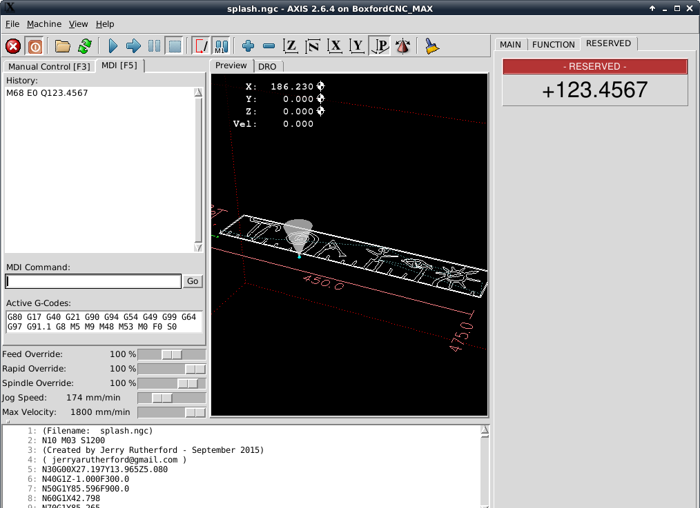

01 Oct 2015 02:16 #63298 by Askjerry
Replied by Askjerry on topic SPINBOX DATA to G-Code Variable
I was staring at this with that duhhh :blink: face... going wahhhhh????
Then the light bulb went on. :ohmy:
I see....
linuxcnc.org/docs/html/gcode/m-code.html#_m68_analog_output
So I would link them up in the HAL file to my panel widgets...
alpha     motion.analog-out-00      => pyVCP.apha
beta       motion.analog-out-01      => pyVCP.beta
charlie   motion.analog-out-02      => pyVCP.charlie
delta      motion.analog-out-03      => pyVCP.delta
Then in G-Code...
M68 E02 Q123 would push "123" to the second analog output... pyVCP.charlie
And "charlie" would need to be able to handle the float number... or I would need to convert it.
So in my previous example using the number box... with a pyvcp.my-number I would simple need the following in the HAL file...
net my-number motion.analog-out-00 => pyvcp.my-number
Then pass data via M68 E00 Qnnn.nnnn where nnn.nnnn is the number I want to pass.
Let me give that a try...
That got it... experiment time!
Thanks folks!

01 Oct 2015 23:25 #63342 by Askjerry
Are you kidding... I already figured out how to convert float to u32 (integer) and pass it to image buttons with multiple states.
Now I can have a status indicator with a different graphic for...
  • Spindle Running
  • Spindle At Speed
  • Spindle Slowing
  • Spindle Stopped
or example...
Or a graphics panel that looks like a display screen with canned messages...
  • Phase 1 - Spindle Starting - Keep Hands Clear
  • Mount the part - On the Run/Safe switch, select RUN
  • Remove the Part - Rotate 180 Degrees and Press Start
  • Phase 2 - Spindle Starting - Keep Hands Clear
  • Part is complete - Flip the switch to SAFE and remove the part.
All kinds of new options now. B)
