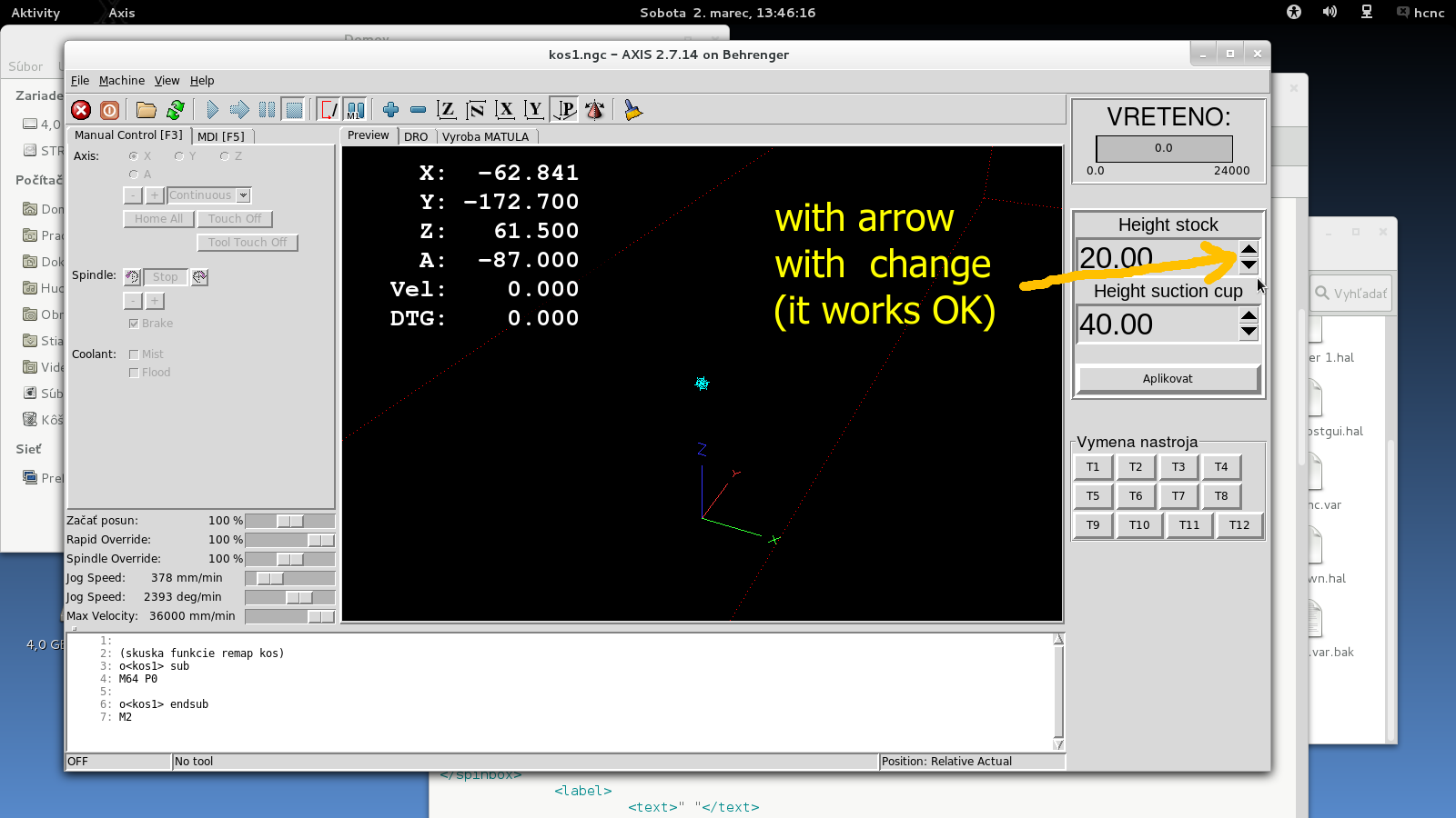

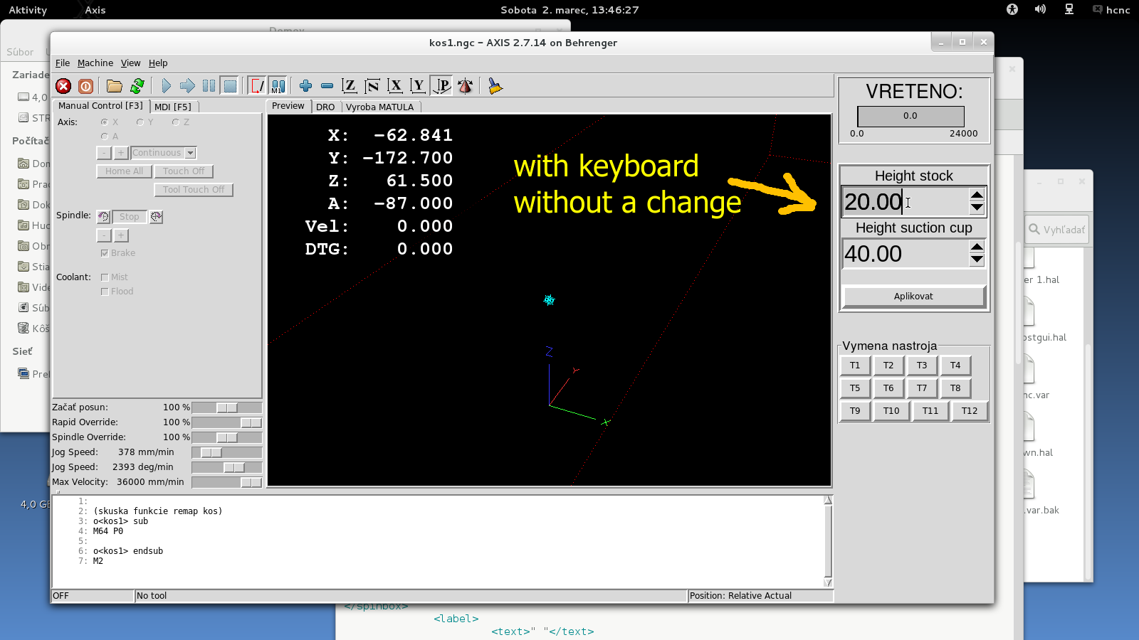

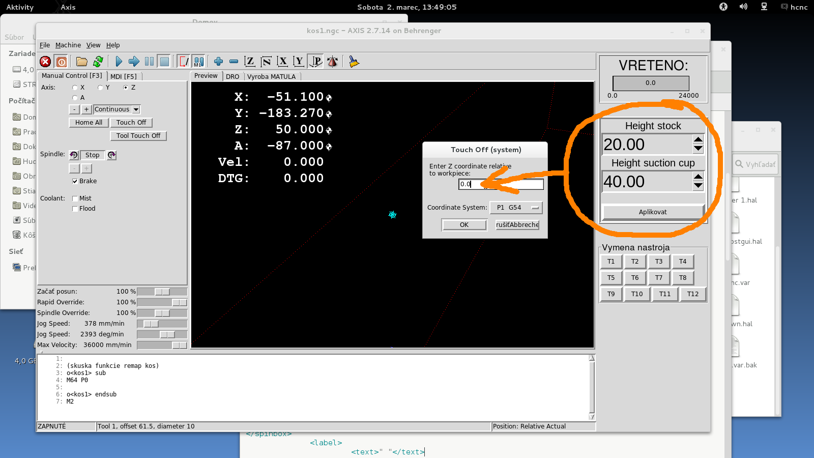

02 Mar 2019 13:43 - 02 Mar 2019 19:30 #127493
by jurod
Replied by jurod on topic SPINBOX DATA to G-Code Variable
Hi everybody
I have two problems with spinbox.
1. G code (aplikovat) is unchanged if I write to a spinbox with a keyboard. The number on the
screen is changed but gcode is without change.
A change with arrow G code (aplikovat) its OK. It works with changes.
2. I wood like change "Z coordinate relative to workpiece" with button "Aplikovat" .
Why? Help please.

- Askjerry
- Posts: 239
- Thank you received: 31
02 Mar 2019 17:19 #127522
by Askjerry
Replied by Askjerry on topic SPINBOX DATA to G-Code Variable
When you put a value into the SPINBOX, you must hit ENTER to lock it in... otherwise no change.
Also... the SPINBOX will not effect the TOUCHOFF screen... they are separate.
If you are attempting to set the Z-Axis G54 HOME to the new measurement... for example 20mm as shown in your code... then the command would be
#TEMP = [#<_hal[pyvcp.stock]> * [-1]]
G10 L20 Z #TEMP P1
When the command is executed... TEMP is calculated... so if you set the SPINBOX to 20... then TEMP would be -20.
When the routine executes G10 L20 Z #TEMP P1 it tells LinuxCNC that you are now 20mm lower then the ZERO (HOME) position.
The current location will then be set as 20mm above the surface.
Is that what you are attempting to do?
Jerry
G10 L20 Z #TEMP P1
Jerry

03 Mar 2019 10:38 #127586
by jurod
today I will test.
to Askjerry: With ENTER it works. I am
today I will test.
05 Mar 2019 16:32 #127797
Replied by andypugh on topic SPINBOX DATA to G-Code Variable
When I had an interface with spinboxes I was in the habit of clicking up-arrow then down-arrow to lock the value. (I think that this was before the enter key was mapped to the control....)
It's an annoying feature of PyVCP.

07 Mar 2019 16:53 #128000
by jurod
I created ngc. It's ok. Thanks.
O<aplikovat> sub
#<TEMP> = #<_hal[pyvcp.stock]> + #<_hal[pyvcp.suct]>] *[-1
G0 G53 Z0
G10 L20 P0 Z[140.27 + [#<TEMP>]]
O<aplikovat> endsub
M2
O<aplikovat> sub
G0 G53 Z0
O<aplikovat> endsub
