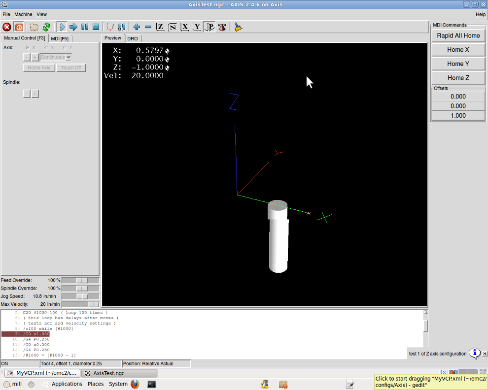

11 Apr 2011 11:33 - 11 Apr 2011 12:06 #8752 by piasdom
i'm adding another button and having this problem.i'm trying to get the offset of X
custom_postgui.hal:12: Signal 'x-offset' of type 'float' cannot add pin 'pyvcp.x-offset' of type 'bit'
in the link i have and the button shows in axis
net x-offset halui.tool.length_offset.x <= pyvcp.x-offset
all looks ok to me, but i think i need something besides pyvcp.x-offset.
can't find anything about floats and bits. and in the docs, list of pins
have
halui.tool.length-offset.x minus sign
but i found in the hal config
halui.tool.length_offset.x underscore
so i know i have the pin right. just don't know if the end of the
link will always end in pyvcp.?????-?????
THANKS
p.s. i'm trying to make a pin in xml file, but isn't pin halui.tool.length_offset.x
used to output something. so i need to change my xml file to something besides button ?
Last edit: 11 Apr 2011 12:06 by piasdom. Reason: thinking
11 Apr 2011 12:08 #8755 by piasdom
i've found <number> </number>, but it doesn't
display the offset. just 0.0
11 Apr 2011 13:03 #8756 by piasdom
got it.
was offsetting x and looking for z :)

11 Apr 2011 13:48 - 11 Apr 2011 13:49 #8762 by piasdom
Cool. thanks ! can you comment out a paragraph in the xml file?
what i have so far.
