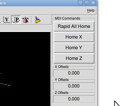

11 Apr 2011 15:14 #8766 by piasdom
i now have this. but i like to know if i can get the names next to the number.

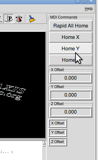

11 Apr 2011 16:46 - 11 Apr 2011 16:59 #8770 by piasdom
i got this now. but i can't get it to show output. shows <text> in a border. or
tables don't have output ? [

11 Apr 2011 17:19 #8771 by andypugh
No, tables and text don't have output. You need to put buttons and controls in the table.

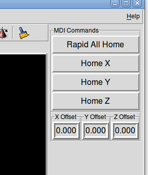

11 Apr 2011 17:29 - 12 Apr 2011 12:03 #8772 by piasdom
thanks andypugh.
i ended up with this. shows me what i want, so i'm happy. thanks again for all your help.
attached is my xml, in case someone need examples
