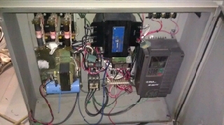

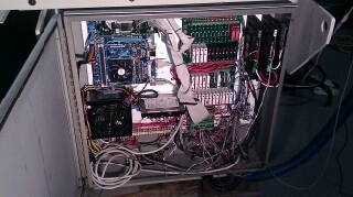

24 Jan 2012 05:14 #17081 by JR1050
My initial idea was to write an executable shell script in the c shell( csh,like bash or ksh).It seemed like it might be easier than Comp and considering Python scripts work as user space components,it mighta been worth a shot.I have some previous retrofit experience with Delta Tau and I wrote two PLC programs for a Cincinatti lathe.One was estop,error messages and button functions,the other for the Duplimatic turret.DT scans for changes in i/o states and acts on the changes accordingly.I was thinking about just writing one long file with my turret,estop logic,fault conditions ect.Right now Im using some and/or functions to get things up and going.
I do appreciate that the HNC turret logic has been figured out and shared.Im a glutten for punishment and was gonna have a go at it myself,just for the learning experience.Im not hot on ladder programming and Classic ladder runs in userspace anyway.I was thinking about putting a reverseable two way solinoid on the lathe so the turret would be bi directional.
Thanks for all the input,I started writing the C component and will post some snippets...its a first and Im sure Im gonna get stuck!!.I posted some pics.....
if I can be of any help to any one,please ask!!!

24 Jan 2012 05:17 - 24 Jan 2012 05:18 #17082 by JR1050
[img size=320]www.linuxcnc.org/media/kunena/attachment...acy/images/hard2.JPG
I gotta get better at this photo thing!!
