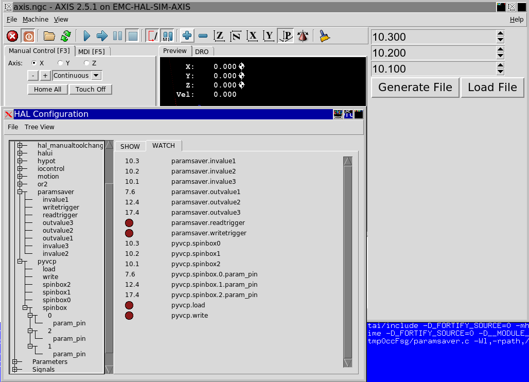

14 May 2013 18:52 - 14 May 2013 18:57 #34065
by ArcEye
Replied by ArcEye on topic Saving parameters after shut down
Hi
Think I have sorted it.
Part of the problem was needing to specifically flush the file write, because it is in a polling loop function and the other was sorting out the file path
(I just did a ~/ in the example, but that won't work with C only bash)
and proof of concept running in a sim
The input pins receive what you want to write to file and are connected to the spinbox hal pin so as to reflect the current value
The output pins receive the saved values from file and are connected to the spinbox.N.param_pin so as to update the spinbox from file
Note that the amended pyvcp_widgets param_pins and the corresponding paramsaver.output pins will remain at the last values they were set at until set again
They are checked internally in pyvcp_widget.py against the last value that they were set to, not the last value of the spinbox widget.
The connections for the pyvcp panel in the screenshot were as below, which demonstrates
Hopefully will do what you want
regards
net 1p pyvcp.spinbox.0.param_pin <= paramsaver.outvalue1
net 2p pyvcp.spinbox0 => paramsaver.invalue1
net 3p pyvcp.spinbox.1.param_pin <= paramsaver.outvalue2
net 4p pyvcp.spinbox1 => paramsaver.invalue2
net 5p pyvcp.spinbox.2.param_pin <= paramsaver.outvalue3
net 6p pyvcp.spinbox2 => paramsaver.invalue3
net 7p pyvcp.load => paramsaver.readtrigger
net 8p pyvcp.write => paramsaver.writetriggerHopefully will do what you want
regards
Last edit: 14 May 2013 18:57 by ArcEye.
The following user(s) said Thank You: mariusl
