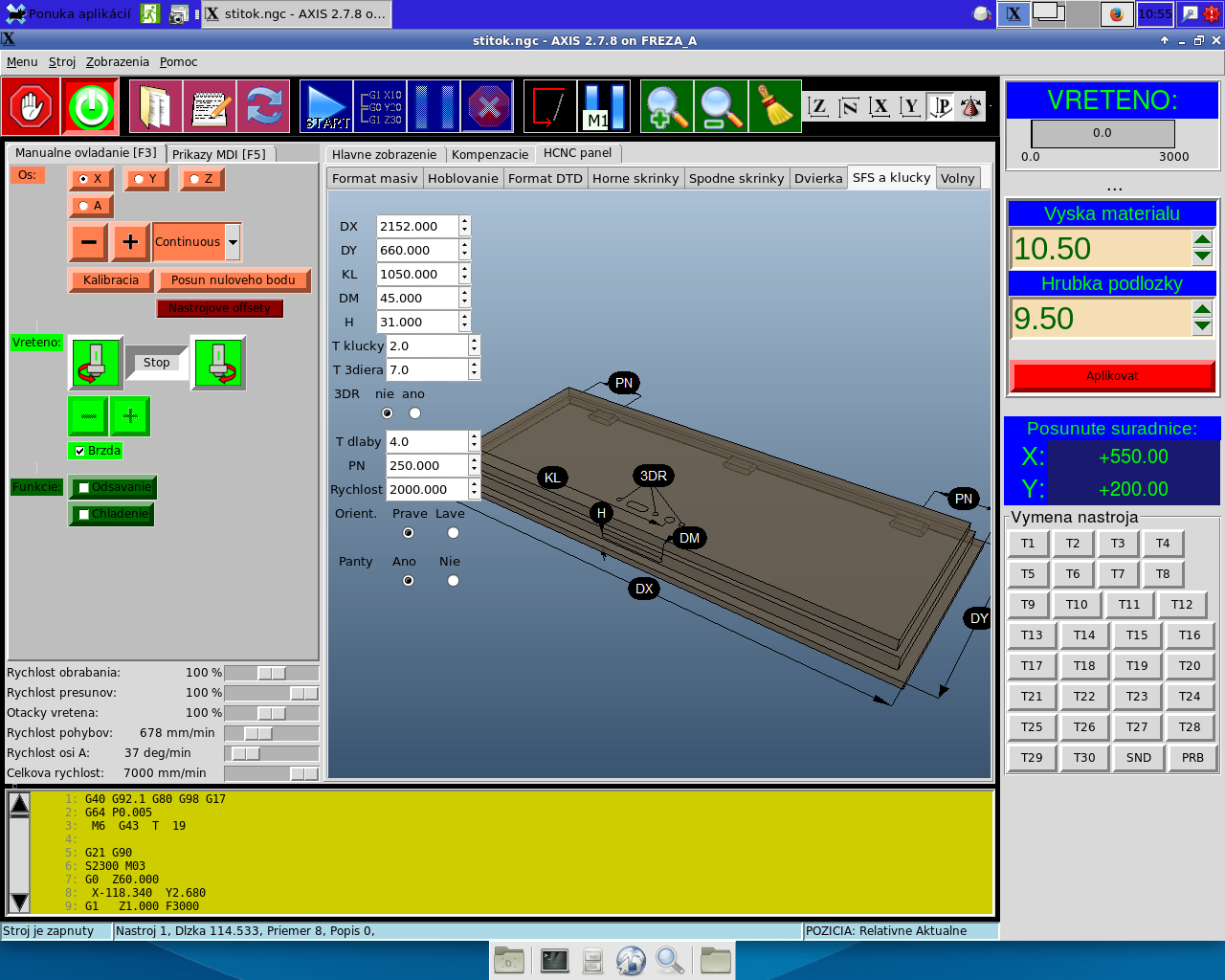

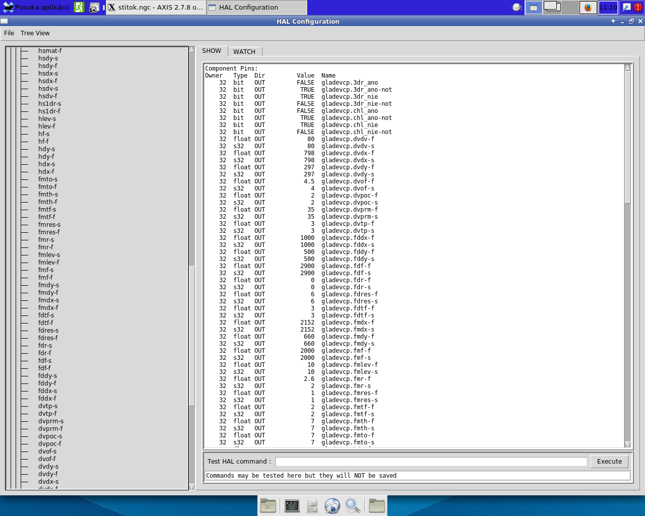

12 Sep 2019 09:39 #144951 by jurod
Replied by jurod on topic Saving parameters after shut down
Hi people
Is it possible to use paramsaver in the gladevcp panel?
If so, how?
In file pyvcp_options.hal
########################## FILE SAVER ###################################
loadusr -W paramsaver f=10 s=10 b=1 filename=memory_pins onstart=1 onexit=1
net material_out pyvcp.spinbox.0.param_pin <= paramsaver.outvalueF-000
net material_in pyvcp.mat => paramsaver.invalueF-000
net podlozka_out pyvcp.spinbox.1.param_pin <= paramsaver.outvalueF-001
net podlozka_in pyvcp.pris => paramsaver.invalueF-001
net fmdx_in gladevcp.fmdx-f paramsaver.invalueF-002
#net fmdx_out gladevcp.fmdx-s paramsaver.outvalueF-000
########################## FILE SAVER END ###################################
In file HCNC.ui
<child>
<object class="GtkLabel" id="fmdxlab">
<property name="width_request">40</property>
<property name="height_request">25</property>
<property name="visible">True</property>
<property name="label" translatable="yes">DX</property>
<attributes>
<attribute name="foreground" value="#000000"/>
</attributes>
</object>
<packing>
<property name="x">2</property>
<property name="y">25</property>
</packing>
</child>
<child>
<object class="HAL_SpinButton" id="fmdx">
<property name="width_request">100</property>
<property name="visible">TRUE</property>
<property name="can_focus">TRUE</property>
<property name="digits">3</property>
<property name="tooltip_text" translatable="yes">Pozadovany rozmer v smere DX</property>
<property name="invisible_char">&#x25CF;</property>
<property name="adjustment">fmdxadj</property>
</object>
<packing>
<property name="x">50</property>
</packing>
<object class="GtkAdjustment" id="fmdxadj">
<property name="lower">1</property>
<property name="upper">3600</property>
<property name="value">2152</property>
<property name="step_increment">1</property>
<property name="page_increment">10</property>
<property name="page_size">10</property>
</object>
</child>
14 Sep 2019 17:50 #145160 by andypugh
Replied by andypugh on topic Saving parameters after shut down
There is a simpler way to save setting in GladeVCP than paramsaver:
linuxcnc.org/docs/2.7/html/gui/gladevcp....ariables_in_gladevcp
