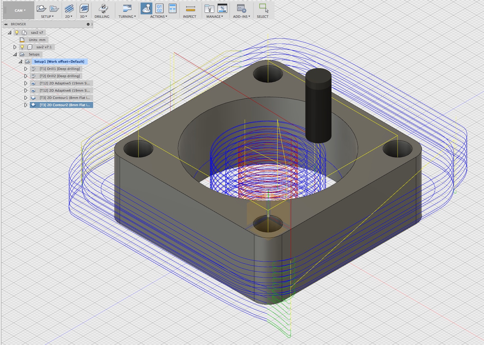

I am using Fusion 360 to generate the Gcode...here is a snippit It was working before but now not working again. I had a bit of deal sorting out the speed of the spindle but have thet pinned nicely it is within 30 rpm across the whole range as I dont have a encoder on the spindle but I setup my Dynavibe prop balancer I use on my fullsize aicraft to read the rpm at 1 PPR
I also have another issue you might be able to hep me with.
I have changed the homing position on the mill to the most common now of the table all the way to the main stanchan of the mill and the table is now the max left corner so the table homes to the back and to the right. I also had a issue where the Y axis was not going in the negative direction on the DRO when coming forward to the front of the mill. I have made the origin of the noseblock the front left top corner of the stock that sits upagainst the fixed vice jaw. For some reason I cant get it to sit directly where it is supposed to on the mill table in the representation on Axis. Also if I stop the process when doing the first stage when I reload the program it doesnt start from the same position....dont know why yet. It would be nice if it all just worked easily. The mill even though at this stage it is just running on a standard parallel port out of LCNC sounds and moves so much better on LCNC than when I had it on Mach3. It is supposed to be 10 times better once I eventually get it running on a full Mesa system
(1001)
(SAV NOSEBLOCK)
(T1 D=3. CR=0. TAPER=118DEG - ZMIN=-27.901 - DRILL)
(T2 D=8.5 CR=0. TAPER=118DEG - ZMIN=-29.554 - DRILL)
(T3 D=8. CR=0. - ZMIN=-14.95 - FLAT END MILL)
(T12 D=19. CR=0. - ZMIN=-24.7 - FACE MILL)

This is what it is

I found out why there was a crazy measurement. Somehow I had values put into my tool 1 tool table in XY and Z...got no I dea how values ended up in there but that explains when I did a dry run with tool 1 it was not going to the place it was supposed to. Also I found that for some reason when I have 6000 in the Gcode it will not run the spindle but if I put in a lesser value it will work when running the Gcode. The PWM is programmed in the HAL file to be 6000 rpm but it doesnt like it when it sees it. Ii may have something to do with the VFD and 6000 rpm is 200 hz maybe the VFD wants to go higher and it just doesnt recognise that. So in the program I set the rpm to 5500 and it seems to work fine. Hopefully I will get some chips going tonight or tomorrow night. I will do a dry run and see how it all pans out

I couldnt help myself so went out to the shed last night to do another dry run...It is still doing funny stuff...I have no idea why yet. The Gcode looks correct but the program is not sending the machine correctly yet all appears to be correct. I will check tonight when I get home and I will make a simple program up to test the XY and Z movements...but it must be another silly corrupt file... anyway I will find out.

Well this is very interesting. Today I did a test file with different drill holes over a block at specific distances and places. I loaded it today and ran the machine. It was perfect in all dimensions and also the origin setting. There must be something wacky I did with the file I posted above. I will redo it and see. I am not using the MPG HAL and INI files at the moment I have dropped back to my standard file as I was having all this trouble. I found the tool offset issue and the RPM I am sure now I know what it is. I will do another Savblock file and try it as it has more operations than just drilling although it was the drilling that went haywire. If it all turns out ok then I will re enable the MPG files and see what else I can stuff up. Thankyou for your help Danny and also Andy on this. I just hope the more I work on this LCNC the easier it gets.

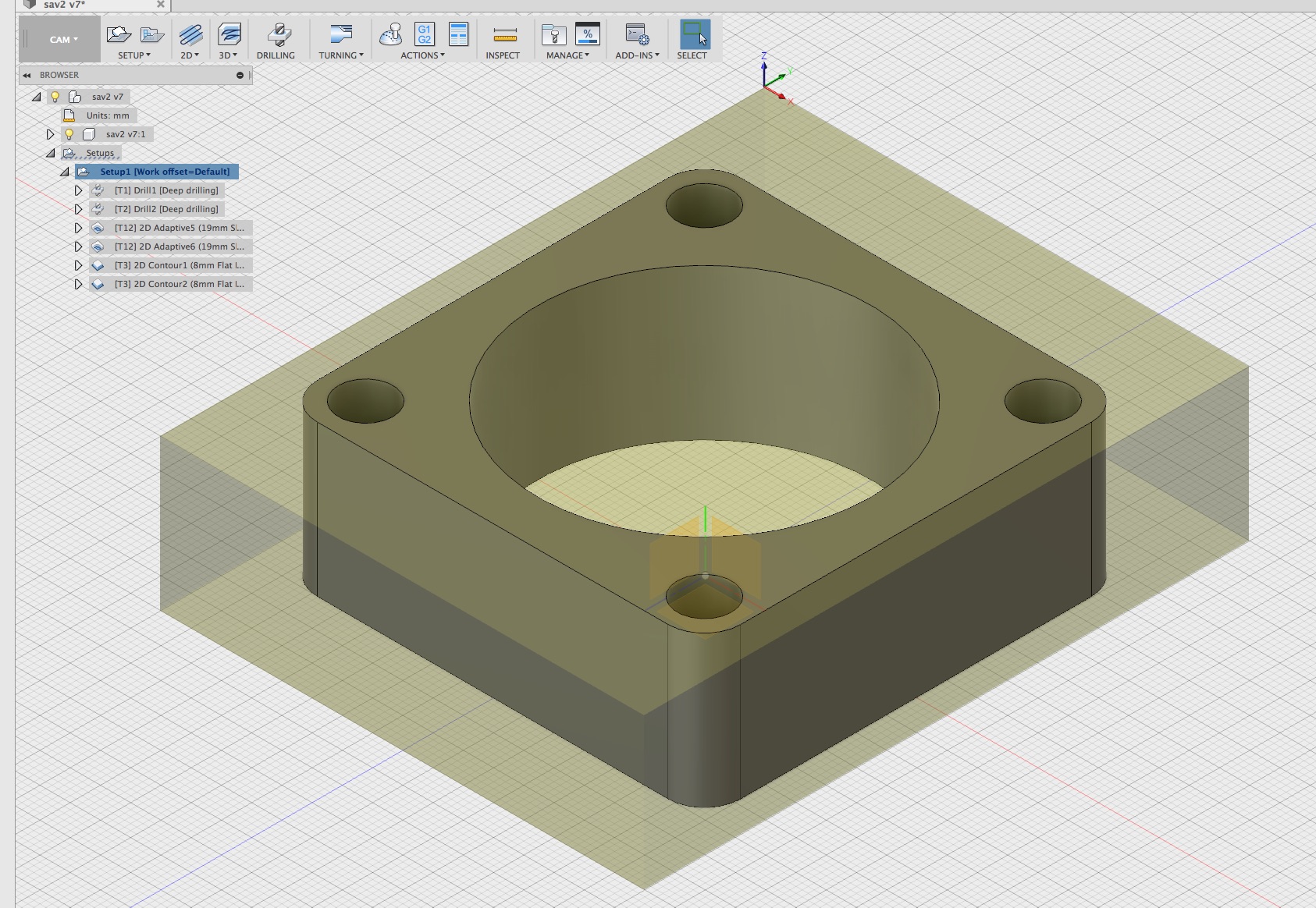

Thought I would let you know the positioning issue was something in the drawing I did for that particular file the sav noseblock. There was a strange plane in there and even though it wasnt turned on Fusion somehow picked it up in the post. Did a trial run tonight on a new file I did and it works fine.
