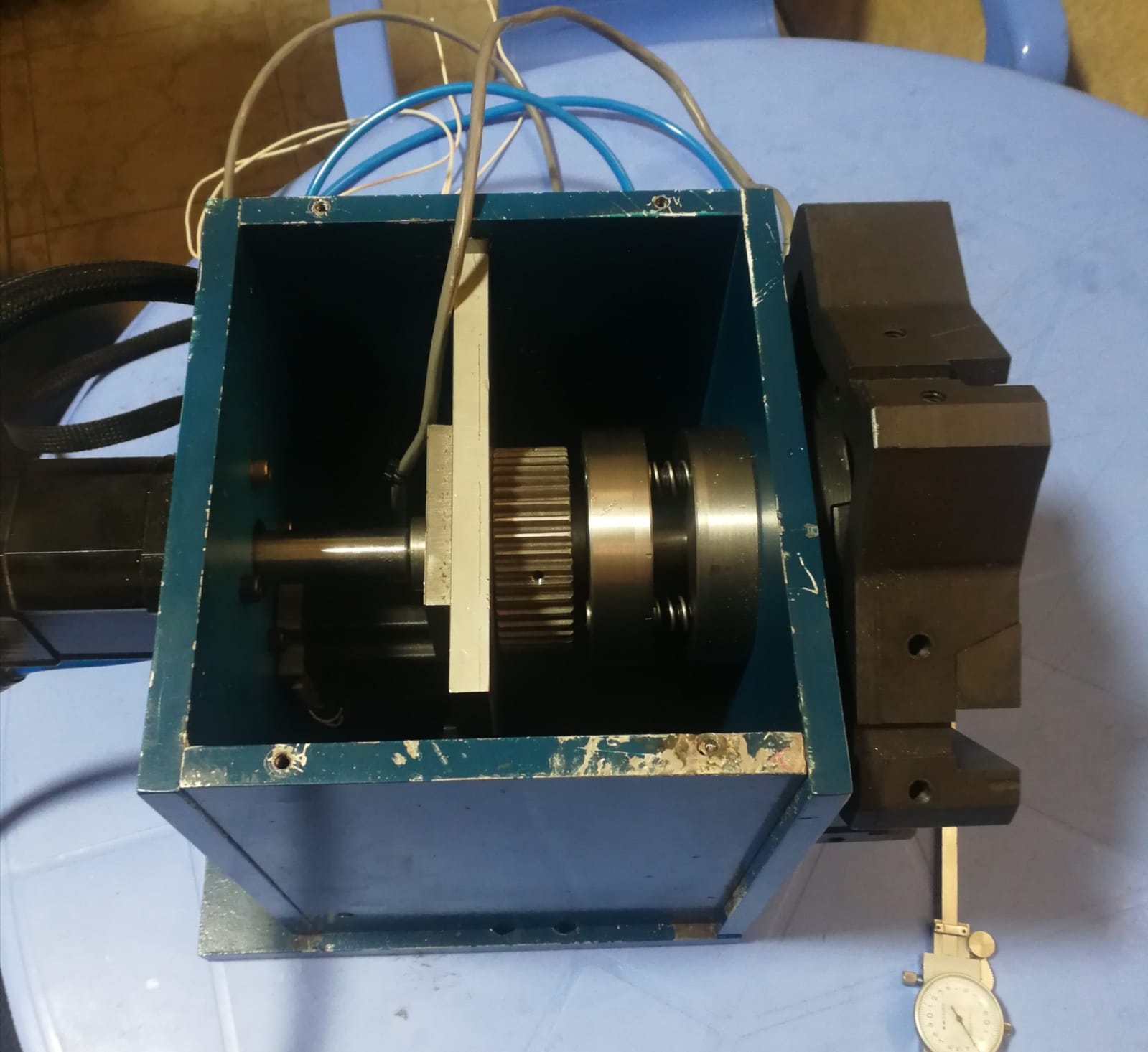

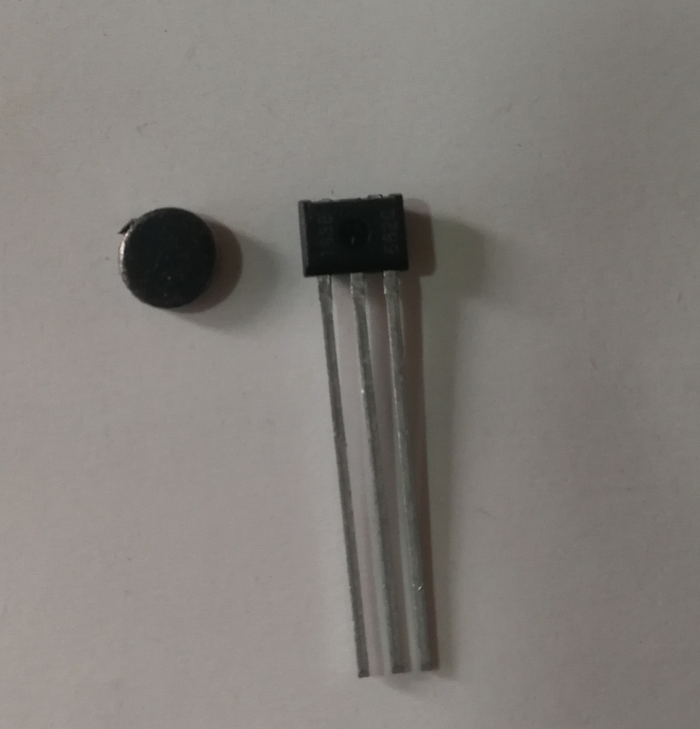

Tomorrow I publish the photos of the ATC. Regarding the sensors, I think I will use the hall effect switch, which are smaller and instead of drill holes, I will use neodymium magnets glued to a disk simulating a 3-bit gray code plus another for the index or strobe. in total 4 hall effect switch.
23 Jun 2022 21:47 #245728
There are some fairly small inductive sensors: www.ebay.co.uk/itm/313673605719 as an example. You need ones (like these) where the metal case comes right to the end. The others can't work buried in a hole in metal.
Replied by andypugh on topic Carousel Component add jog buttons
I shy away from magnets on machine tools, they attract swarf.Tomorrow I publish the photos of the ATC. Regarding the sensors, I think I will use the hall effect switch, which are smaller and instead of drill holes, I will use neodymium magnets glued to a disk simulating a 3-bit gray code plus another for the index or strobe. in total 4 hall effect switch.

The only reason not to use magnets, I suppose, is that you will need quite a lot of them. One for each strobe, and about 12 more to build the gray codes. Sensing metal instead you can use holes and grooves in existing parts for targets.
There are Hall sensors with magnets included for sensing metal targets, though I am not sure how well they do with pure DC sensing.
ATS-667 is one example, though they are bulkier than the one you show.
For something really tiny, look at reflective optical sensors, this one is 2.5 x 2 mm: uk.rs-online.com/web/p/reflective-optical-sensors/1612156

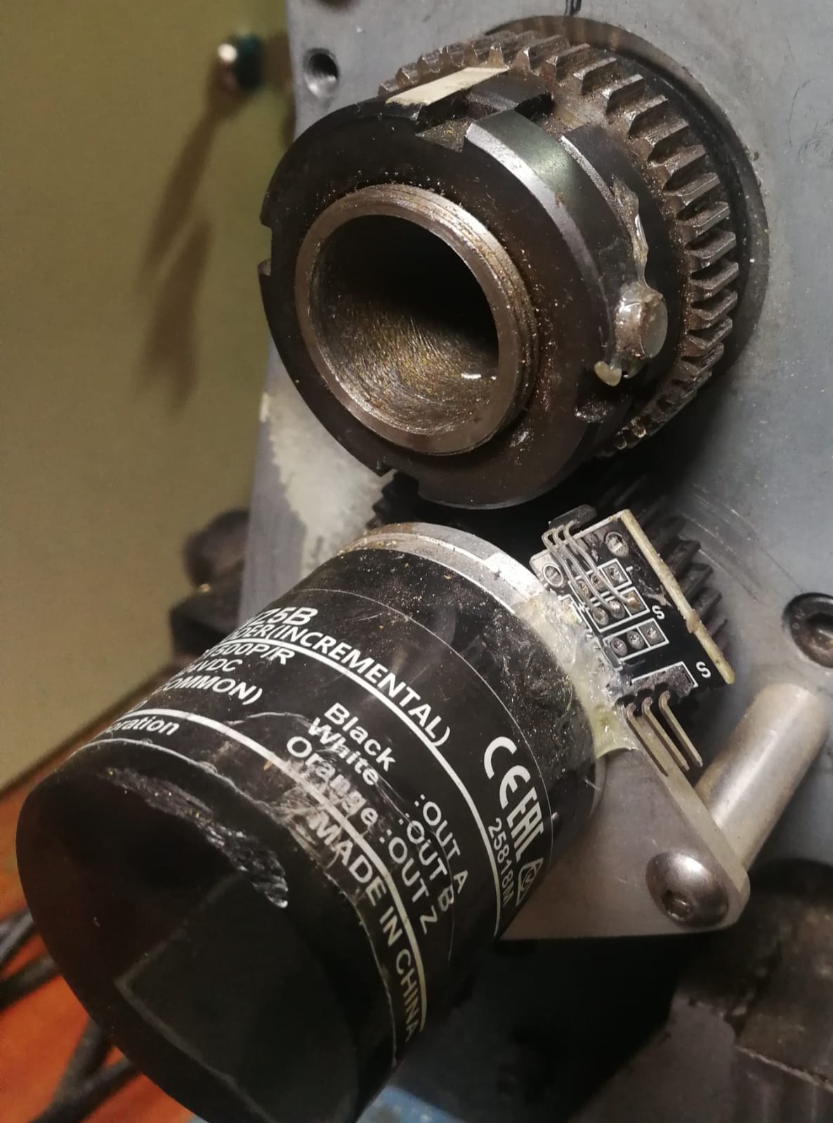

I have a doubt, in the carousel component there is talk of using that component in index mode, but now I don't understand what you mean by Strobe. Regarding the hall sensors, I have already used them in a tone that worked with MACH 3 and used it with INDEX input as seen in the photo. I already replaced it with an encoder now that I am using LINUXCNC.

You can probably use the encoder with carousel. And probably also use the encoder index rather than an external one.
Carousel is basically intended to use any form of feedback that can work. Which includes an incremental encoder + index. (There is a pin for the offset between the index and pocket 1)

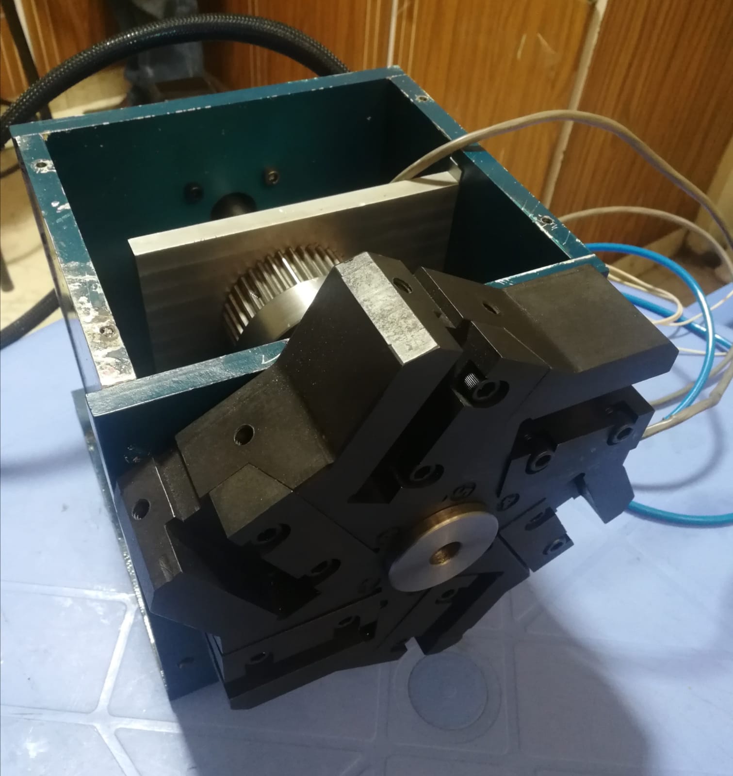

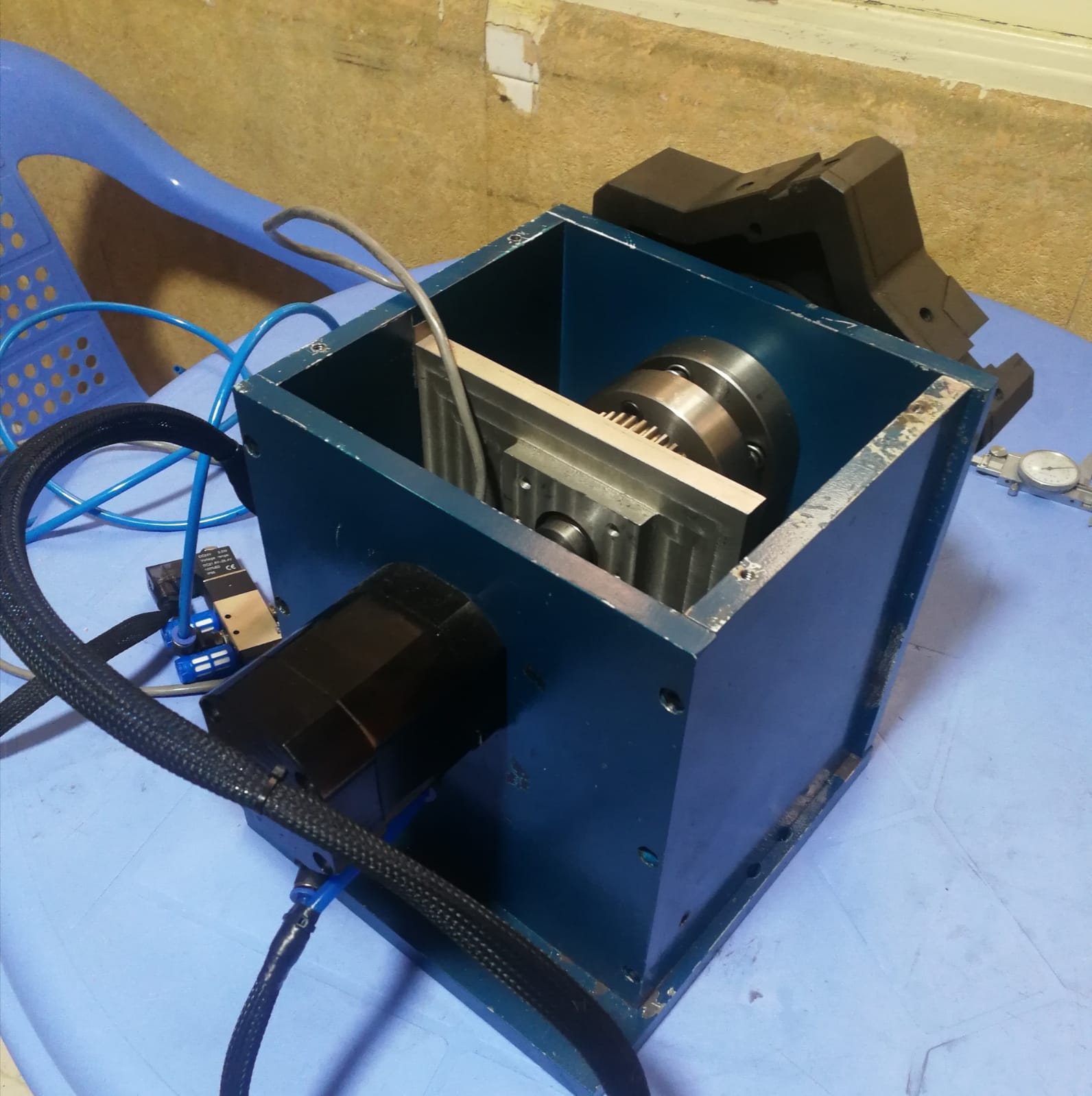

Andy I already have the gray encoder working for the tool changer for the lathe, simulating the movement with the sensors, everything works fine. Now I included the stepper motor, but now the problem is that after homing the X and Z axes and trying from the MDI make a tool change with M6 Tx, I get the error: cant issue MDI command when not home. I understand that as the motor I use for the carousel I have no way of doing homing for linuxcnc this motor is not in the home position. These are my configuration files.
