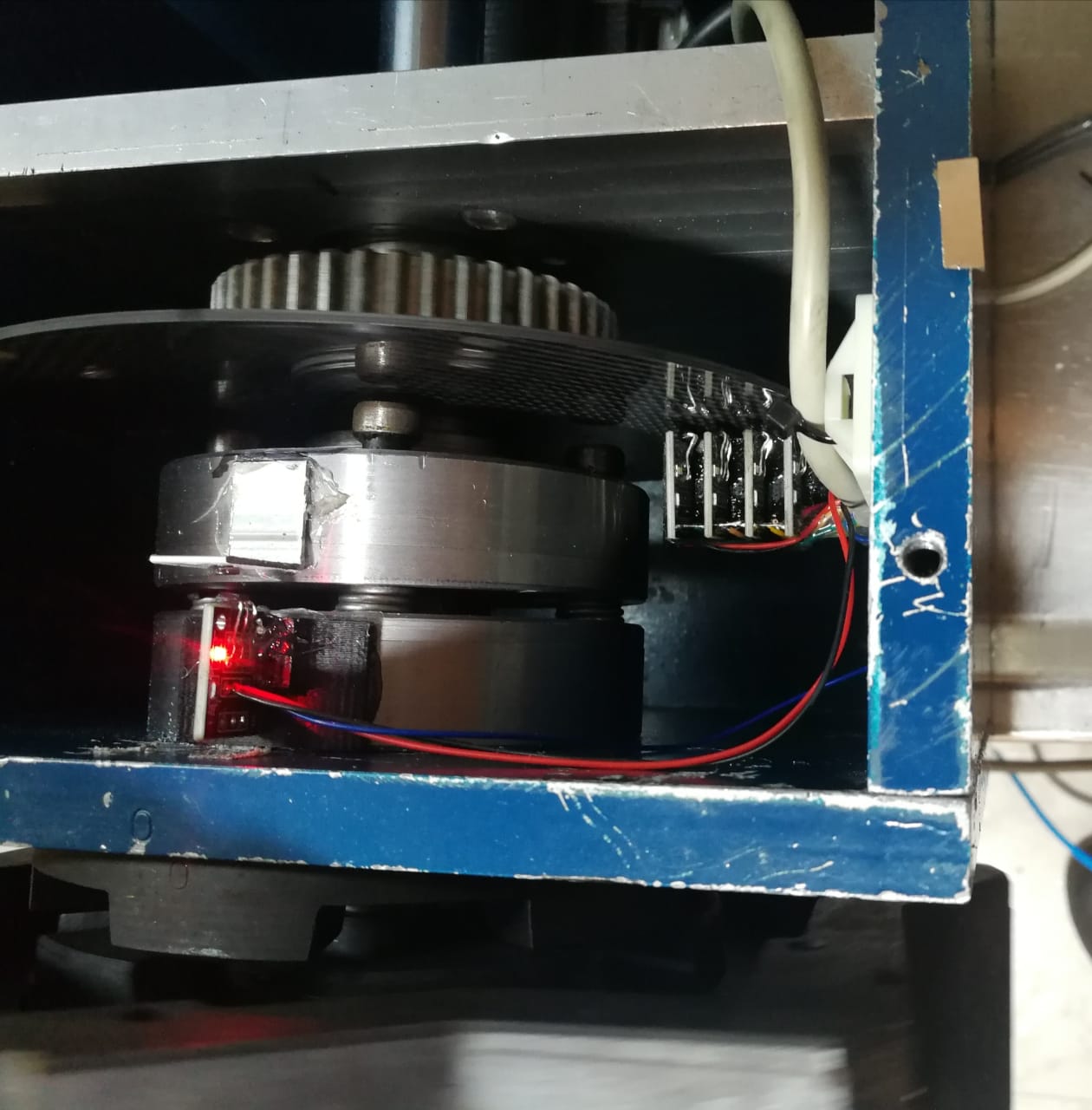

Problem with homing ATC step motor

Replied by andypugh on topic Problem with homing ATC step motor
I think that the only change you need is to reduce to two joints:
[KINS]
JOINTS = 2
KINEMATICS = trivkins coordinates=XZPlease Log in or Create an account to join the conversation.

07 Jul 2022 20:34 #246832
by COFHAL
Replied by COFHAL on topic Problem with homing ATC step motor
Andy
No, if I only leave two joints I get an error: joint.2.amp-enable-it does not exist., and without that instruction the engine doesn't work.
07 Jul 2022 23:18 #246841
change
to
net a-enable <= joint.2.amp-enable-out
net a-enable => hm2_7i96.0.stepgen.03.enableto
net a-enable <= carousel.0.active
net a-enable => hm2_7i96.0.stepgen.03.enablePlease Log in or Create an account to join the conversation.

09 Jul 2022 15:57 #246953
by COFHAL

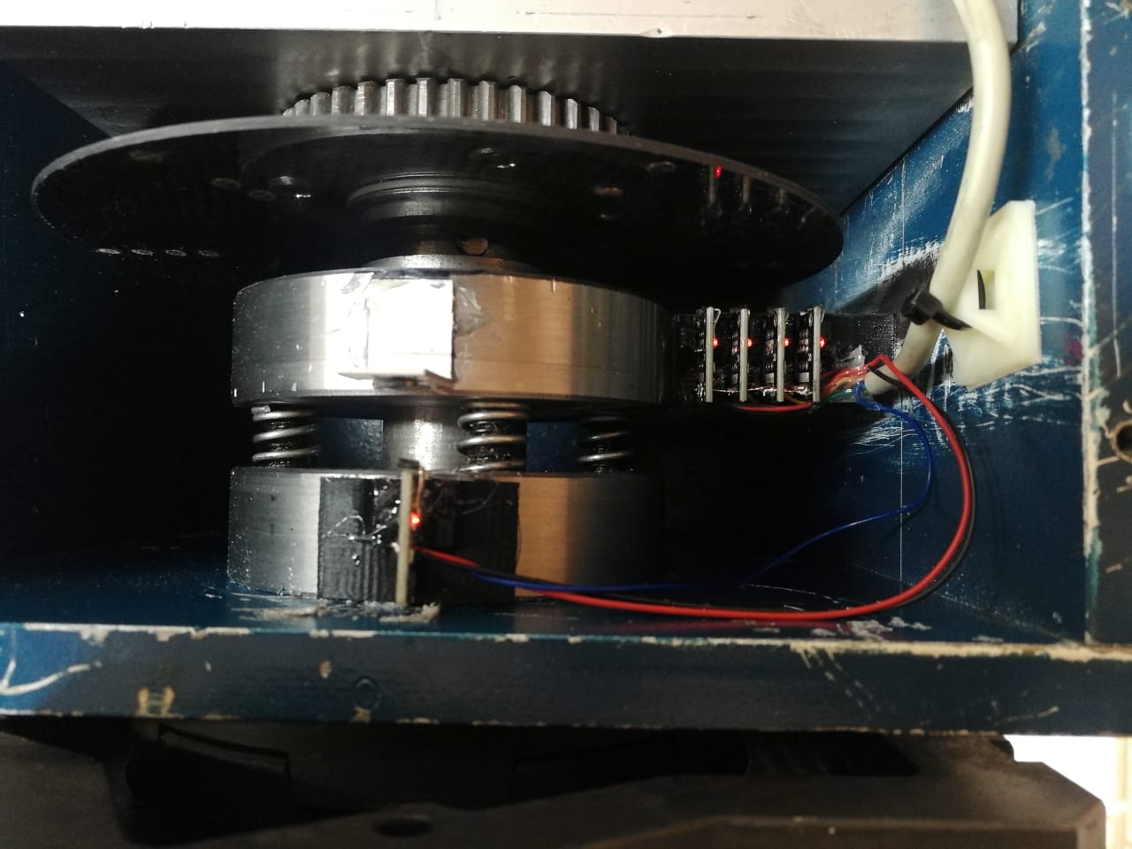

Thank you very much for your support, the motor already works. The problem now is that despite having the carousel configured as bidirectional it always turns in the same direction, when verifying with the HALSHOW carousel.0.motor-fwd or carousel.0.motor-rev it is activated depending on which is the most it cuts to reach the tool it selects, despite that the motor always only turns in the same direction.
11 Jul 2022 10:34 #247065
How is carousel connected to the stepgen?
For a stepper you should probably have carousel.0.motor-vel connected to stepgen.N.velocity-cmd. If the changing sign of the velocity command does not change the rotation direction than it may be that the stepgen.N.dir pin (in software or hardware, or possibly both) is incorrectly connected.

11 Jul 2022 19:59 #247105

11 Jul 2022 20:53 #247106
try -10000 for the rev-dc
