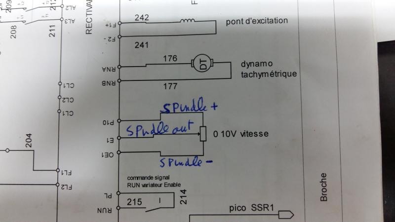

25 Sep 2016 18:14 - 25 Sep 2016 18:17 #80909
by finemeca
Replied by finemeca on topic Mesa 5i25 and 7i76 and encoder
Ok I just take my config.
Linuxcnc OK but it will not always.
For the drive, it is wired like this:
https://goo.gl/photos/Th81Ptx2LnNri4J37
The spindle drive is a DC motor.
On this type of engine there is a dynamo.
