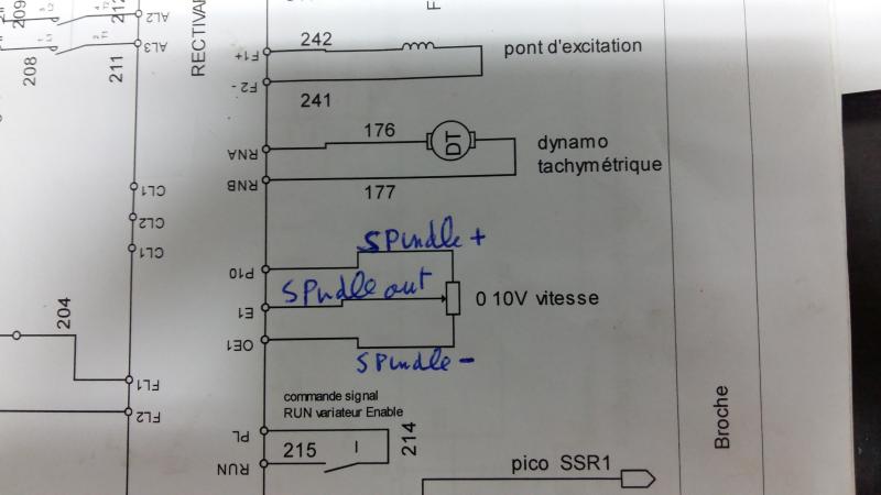

Linuxcnc the coast I think I have everything configured properly.
I have a problem with the drive:
Max spindle speed: 2500 rev / min
Speed requested by linuxcnc: 300 rev / min
Speed displayed on the LCD screen of the drive: 1500tr / min
Can you check the wiring diagram attached

Replied by PCW on topic Mesa 5i25 and 7i76 and encoder
What is the voltage between spindle-out and spindle- when you command 300 RPM?

For 300 tr/min i have 7,45 V in spindle - and spindle out
In file attached my Ini.

OUTPUT_SCALE = 400
is incorrect (the is the spindle analog output scaling)
this should be
OUTPUT_SCALE = 2500
Its the spindle INPUT_SCALE that should be 400 (assuming 100 line quadrature spindle encoder)
this should be
OUTPUT_SCALE = 2500
