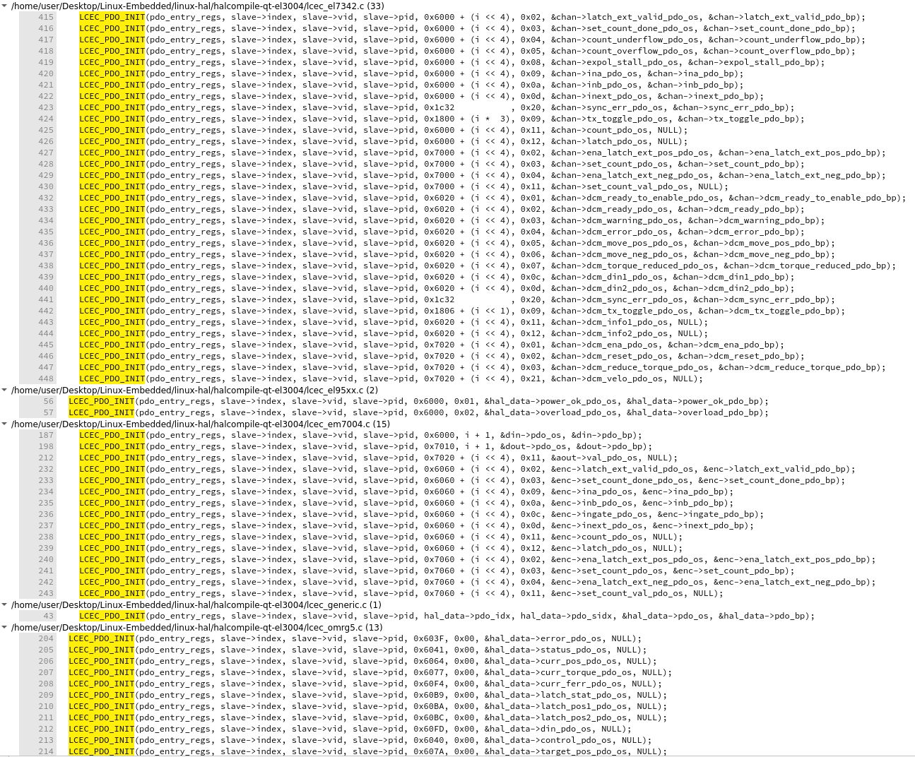

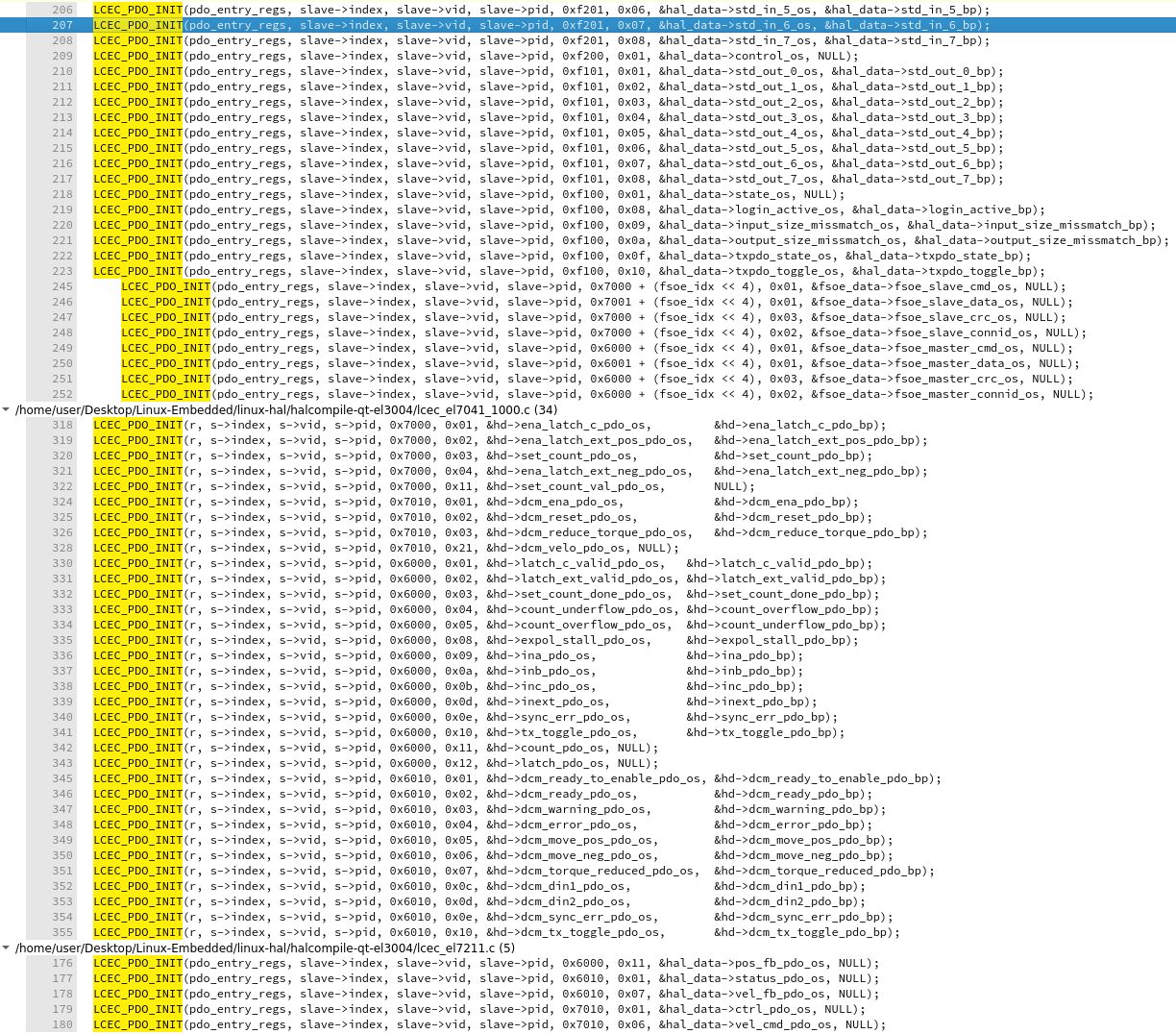

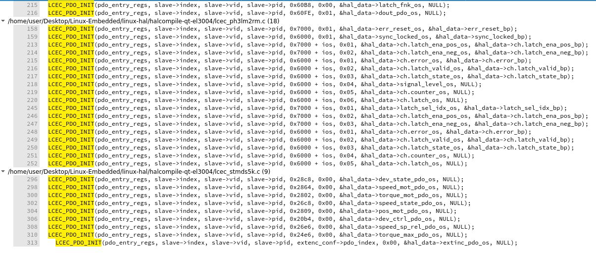

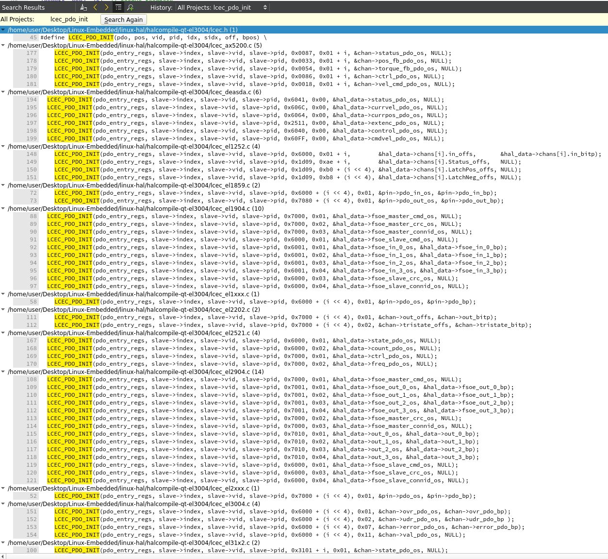

22 Apr 2021 11:53 #206783
by Stormholt
Replied by Stormholt on topic How: Add more (Beckhoff) devices to EtherCAT HAL driver?
I am attempting to write a driver for the EL6021,
I have read couple of drivers, but cant quite understand how to decide which entries to use LCEC_PDO_INIT() on in the init function.
As far as i can read it is for the entries that are not a full byte in size, but i am unsure. Can anyone explain this to me ?
Thank you in advance
Stormholt
Stormholt
- Grotius
- Posts: 2419
- Thank you received: 2349
23 Apr 2021 23:59 - 24 Apr 2021 00:02 #206902
by Grotius
Replied by Grotius on topic How: Add more (Beckhoff) devices to EtherCAT HAL driver?
Hi Stormhold,
When i compare all the lcec_pdo_init's(..) of the project, i think you can maybe quess what the entry should look like.
I don't know anything about the el6021. There is some online documentation with details.
Attached some pictures, maybe it help's you.
The pdo init is to tell something about the product, the vendor, the index etc. In lcec.h :
P.s i remember the command : "ethercat cstruct" gives this kind of info from the online slaves.
// pdo macros
#define LCEC_PDO_INIT(pdo, pos, vid, pid, idx, sidx, off, bpos) \
do { \
pdo->position = pos; \
pdo->vendor_id = vid; \
pdo->product_code = pid; \
pdo->index = idx; \
pdo->subindex = sidx; \
pdo->offset = off; \
pdo->bit_position = bpos; \
pdo++; \
} while (0); \P.s i remember the command : "ethercat cstruct" gives this kind of info from the online slaves.
