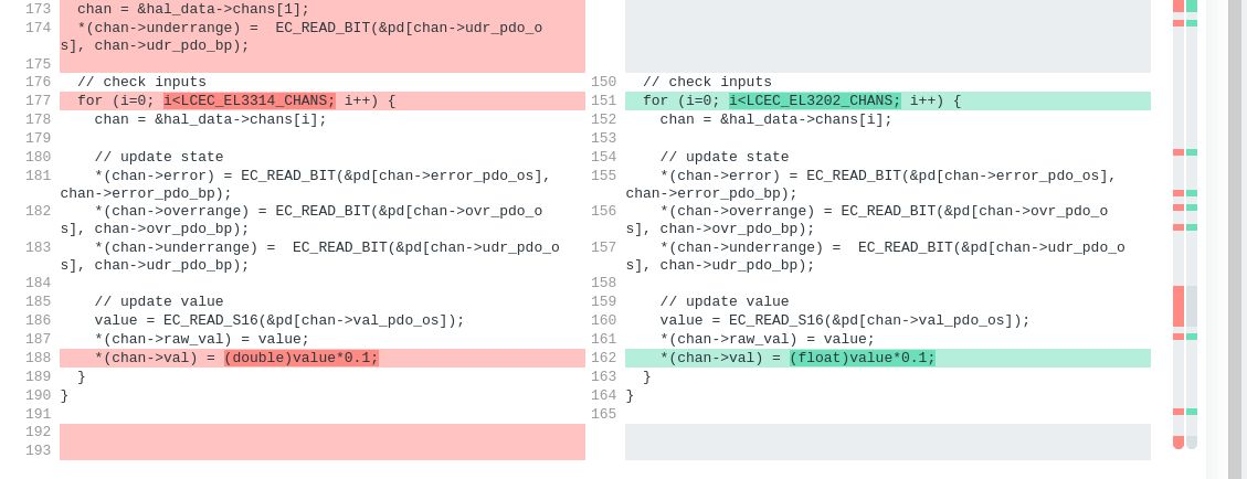

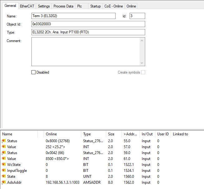

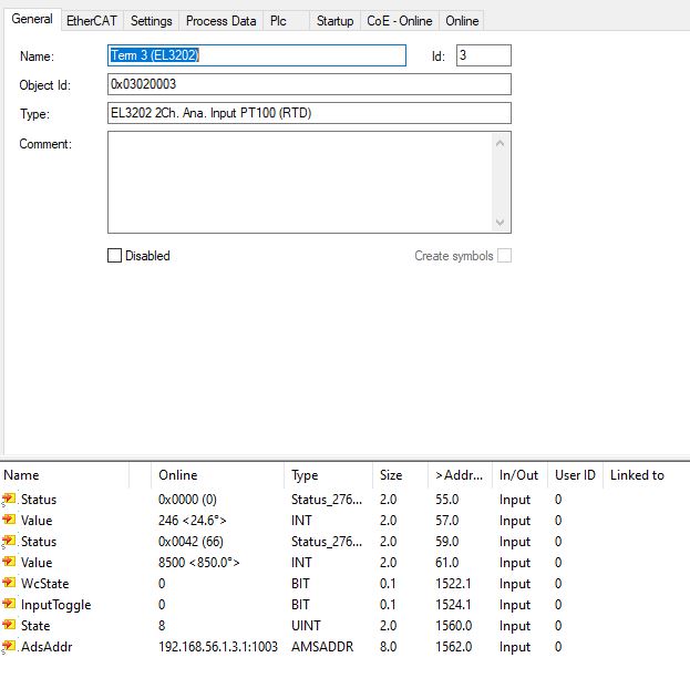

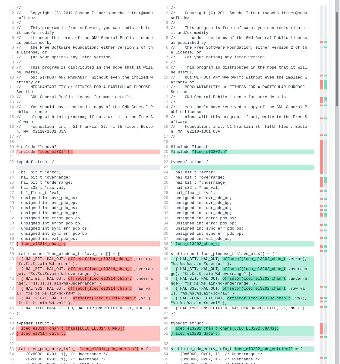

Hello i am having trouble with writing a driver for the EL3202 2 channel input terminal pt100.
I have both the el3202 and the el3314 physically and have created drivers for both of them, and the drivers are extremely identical. The el3314 works perfectly however not the el3202. The values I get from the value pdo entry corresponds to the full status. I don't understand how the device gets this value, as the driver is mapped according to the cstruct. Every half second the value changes from 0 to -32768. In Twincat the device works perfectly.
I am hoping someone might have an idea as to why the value reads from the wrong address.
I have attached the .c .h and cstruct of the el3202 and the .c of the el3314. as well as pictures of the hal results and the twincat. lcec.0.1 is the el3314 and lcec.0.2 is the el3202
Thank you in advance
EDIT:
Also if i provoke an error like removing a pin, the error LED lights up but does not indicate error in hal.
EDIT:

Hi Stormhold,
Can you attach the lcec_el3314.h file?

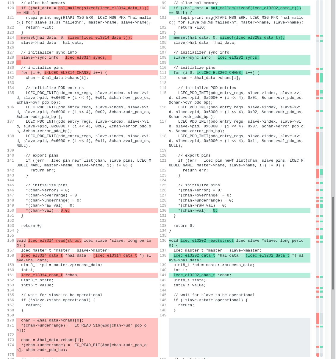

Indeed line 69 is curious, however looking at both the cstruct of both devices and using Twincat the pdo entries are correct. Also i did try changing that and some other entries and it showed no results.
line 170 to 175 are some old test code that i thought i removed.
Are there any other tools useful in debugging ethercat devices ?
