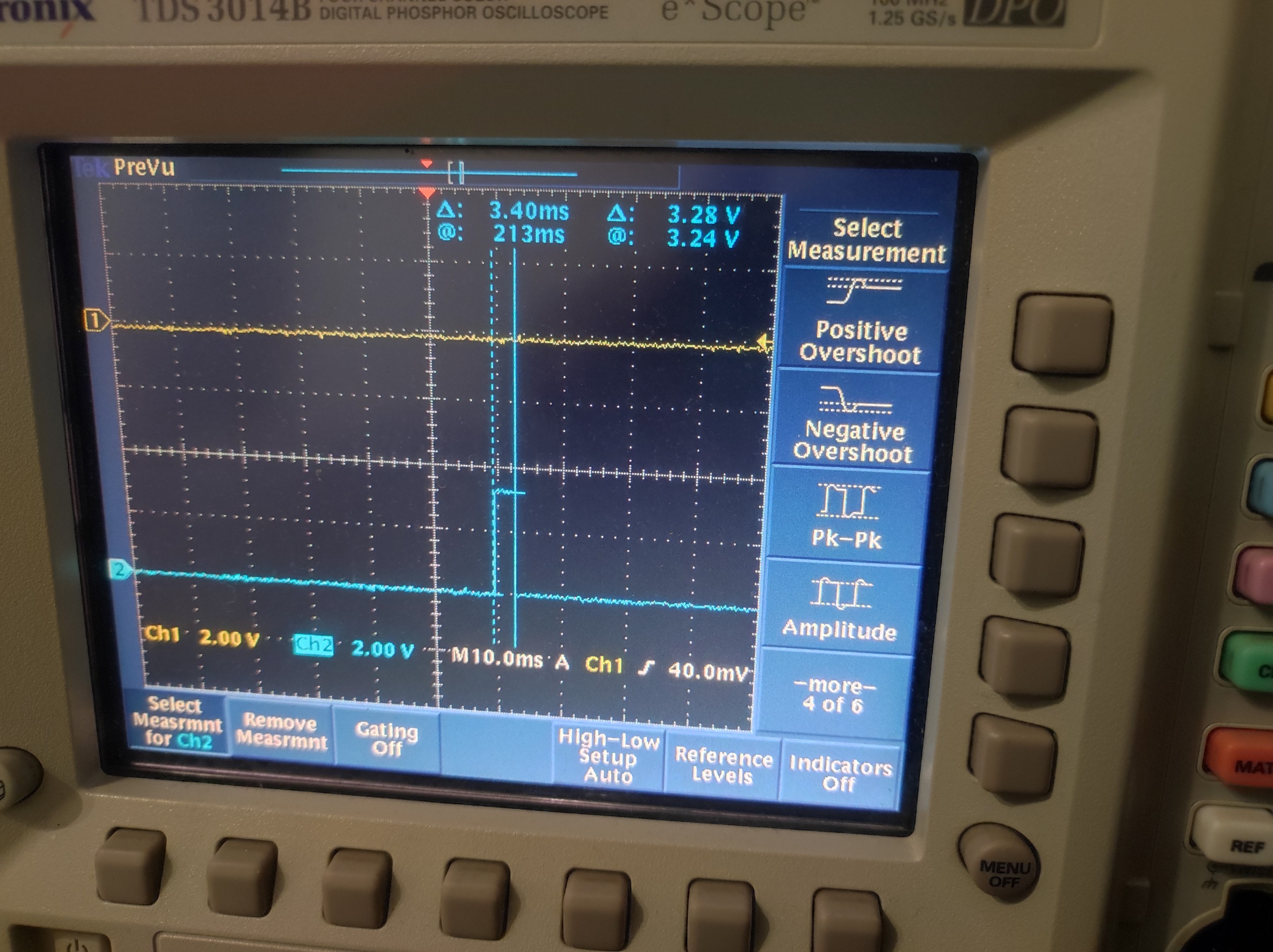

Hello again . I think there is a problem with my bit file. Smart serial does not work. I look at the TX-pin output with an oscilloscope. Only one pulse is sent when LinuxCNC is started. I also have a 7i76e with the same setup, I see a few pulses when starting linux.
I have two 7i98 cards and the problem is not in the PCB. Can anyone help? What's wrong with the bit file? In a p3 connector, all pins have IOPortTag & x"00" & NullTag & NullPin,

10 Apr 2023 22:30 #268789
Replied by PCW on topic 0-10v Servo Control with 7i76E
The 7I98 has the option of pullup/pulldown resistors on the I/O pins
so the I/O pins can be HIGH or LOW until the are controlled by LinuxCNC
If sserial does not work its likely a connection or polarity issue

11 Apr 2023 03:57 #268803
by besriworld
Replied by besriworld on topic 0-10v Servo Control with 7i76E
I spend several days in tests. Now I look at the oscilloscope what it shows on the 7i98 board (my board is not connected). if the jumper is set pull-down low voltage - the voltage is low and when linuxcnc starts , it goes one pulse high (as shown in the picture) and goes back to 0 and stays there. if the jumper is set pull-up high level - the voltage is high and when linuxcnc start it goes one pulse low and goes back to 3.3v and stays there. Where could be the problem?
At 7i76e I have a series of pulses.
Thanks!
Thanks!
- Posts: 18112
- Thank you received: 5331
11 Apr 2023 16:41 #268831
Not sure, the one pulse just looks like the driver enabling the output to send data
but nothing is sent (the interface should send a 0xDF and a CRC character and wait for a response)

12 Apr 2023 15:39 #268903
by besriworld
Thanks for the reply! I can't fix the problem. I put in a new bit file that uses the p2 connector for tx pin . I look at the signal on the oscilloscope and a series of pulses is visible. After turning linuxcnc on and off several times, only one pulse is visible again. I formatted the disk and installed debian again. On the oscilloscope I could see the series of pulses but I had no connection with the 7i73, now I have only one pulse again. I use this controller : max3490csa
is there a command to run again and again trying to connect with 7i73
Could it be a problem that I don't have a pin TXEn0 ?
- Posts: 18112
12 Apr 2023 16:38 #268909
TXen is not needed unless connected to the driver chip
Did your bitfile meet timing?
You can start/stop SSLBP with simple register operations (using mesaflash's WPO function for example)
Basically setup the DDR/AltSource registers then issue a startall/stopall
command to the SSLBP command register

12 Apr 2023 18:05 - 14 Apr 2023 17:45 #268917
by besriworld
PWM works well. I'm uploading a "readhmid "

Can you upload a link ... I'm just very new to the linuxcnc world
PS:
I upload this firmware. 7i98_7i77_7i74d.bit
I am trying to read it with command $ sudo mesaflash --device 7i98 --addr 10.10.10.10 --sserial
There is no change, only one impulse comes (when I look with the oscilloscope).
SSLBP port 0:
SSLBP Version: 1.43
SSLBP Channels: 1
SSLBP Baud Rate: 2500000
PS It's working fine now
PS:
SSLBP port 0:
SSLBP Version: 1.43
SSLBP Channels: 1
