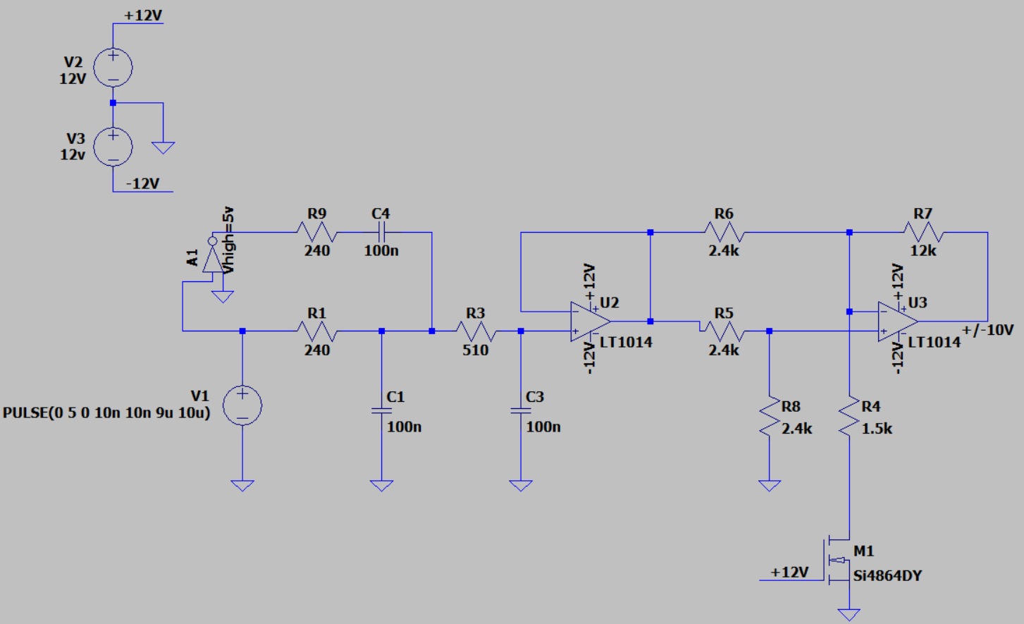

Hi, stupid mistake. I had to change the sign/direction of the feedback. But there seems to be a problem with my board. There is noise in the analog signal. And with 1000 revolutions per minute and without a pid regulator I get spindle-vel-fb-rpm-abs 1005-1010rpm
should I filter the analog signal?
What do you think of the scheme? I can also upload a simulation ?
In simulation it's good, but in real life it's not good
Maybe I should add a capacitor in parallel with the resistor R28 ?

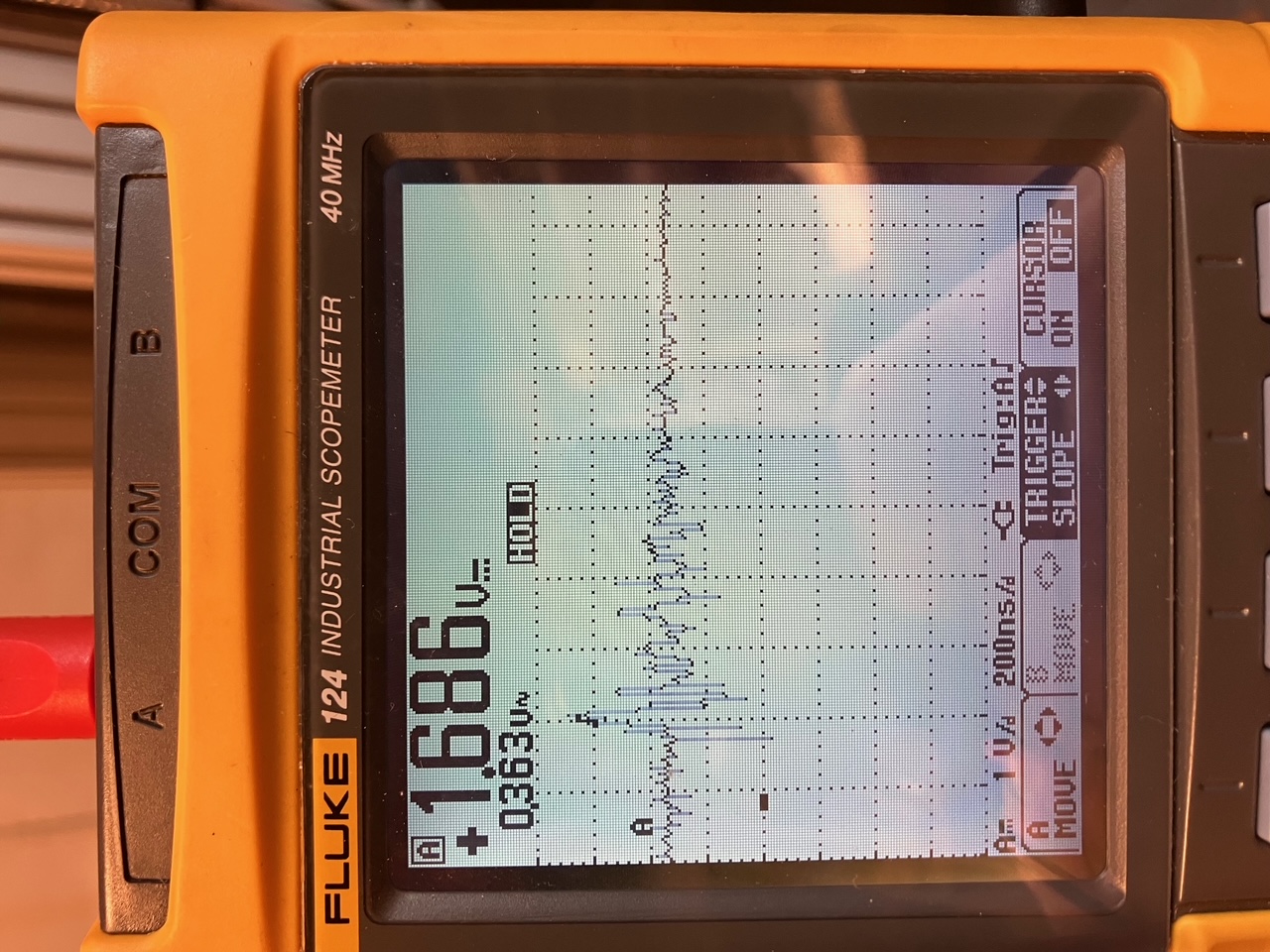

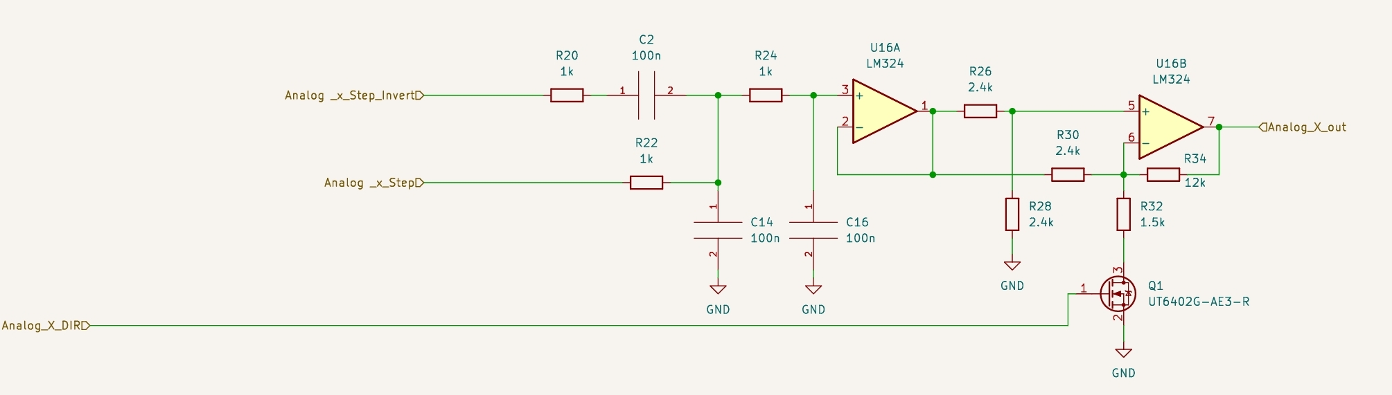

Hi, I can't clear the output voltage ripple ...Does anyone have a photo of the +-10v signal with the oscilloscope.
What can I improve on the scheme?

The problem is that if I put a big capacitor and a resistor, I will add a big delay. I want the spindle to also work as a C axis for milling. I don't know what's wrong. Does anyone have a diagram of the solution that is in MESA card? Or a picture of the output with an oscilloscope?

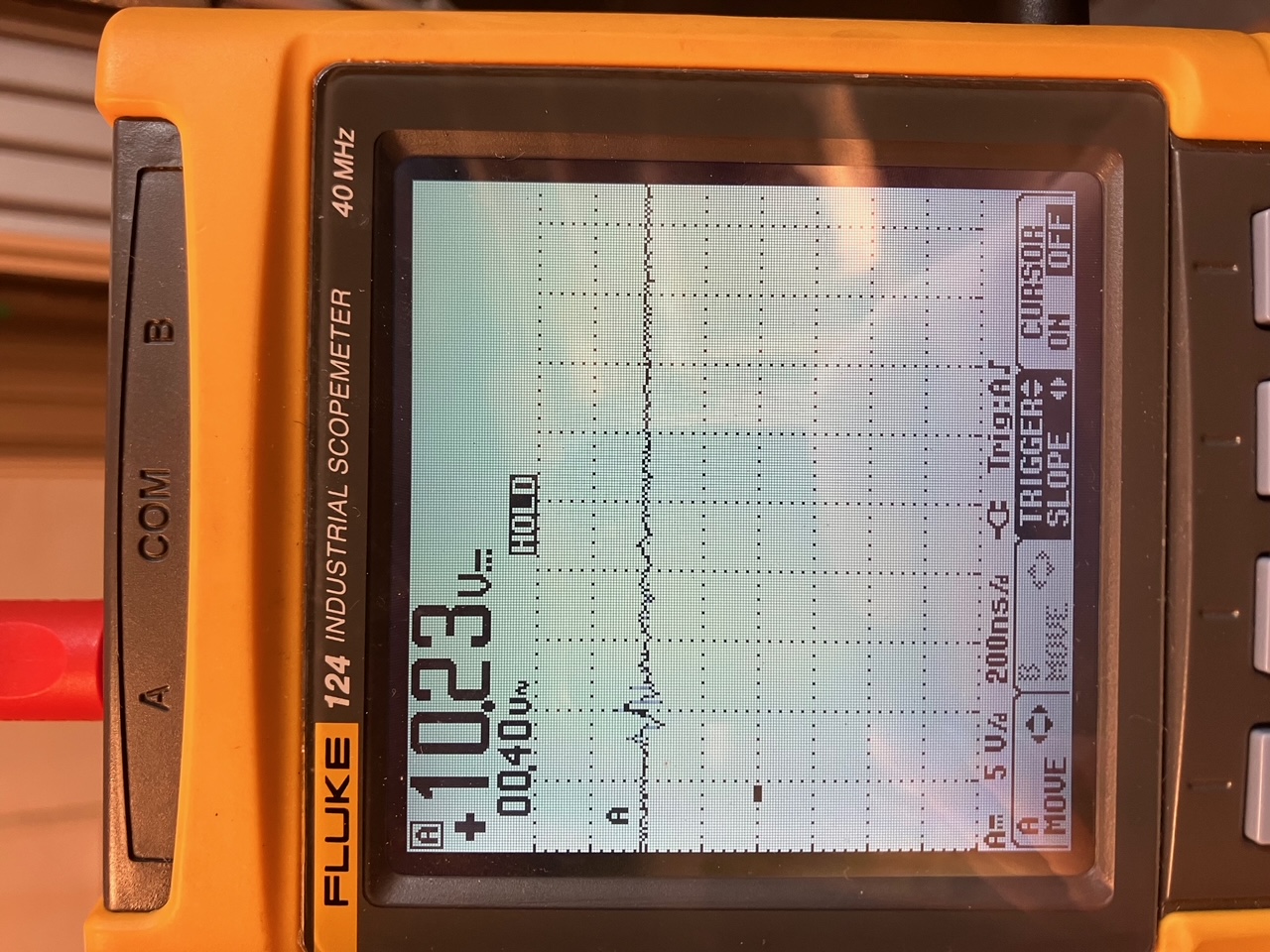

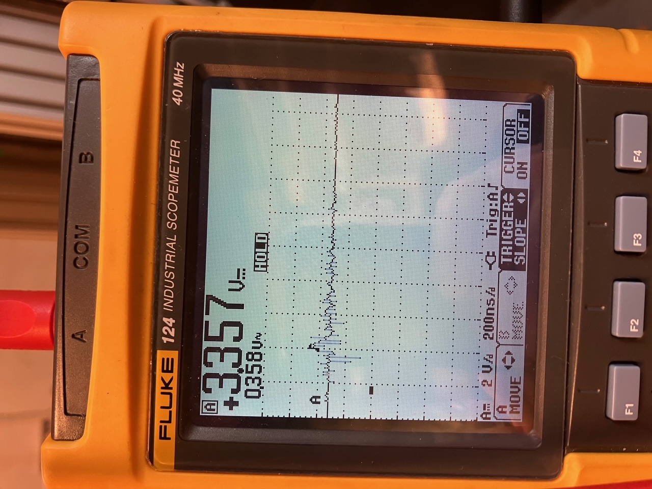

I check this on my noise nightmare. 10V Signal and out at 4K and 8K. 0,4V max
