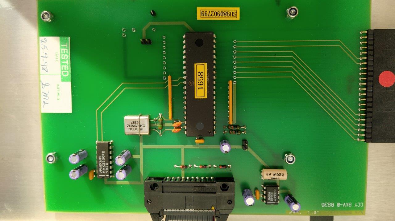

I do have pics, but it's basically a PIC, a serial interface etc. The keyboard is of course a row/col matrix, but the hardware is doing just fine. The serial interface works perfectly - the cable etc is a regular one, and I've got a couple of serial interfaces on the industrial PC's that I use.
The only real question is how I can get the ASCII from the serial interface and into LinuxCNC.
It would seem one option is to somehow get it to appear as a serial keyboard (well, it basically is a traditional serial keyboard!) and then use HAL_input to access the input device. As that seems a bit hokey and going to require building kernel drivers etc (there's got to be something out there already?!), the easiest options are:

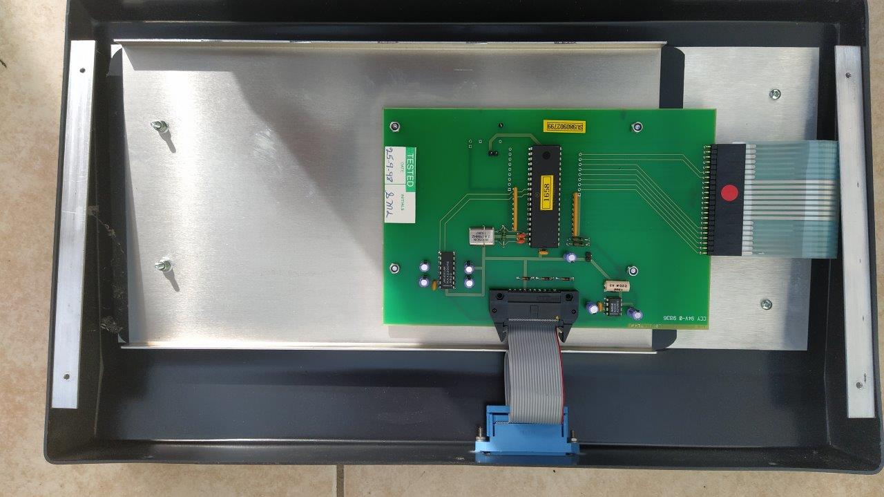

Can out get physical access to the row\col of the keyboard matrix ? if so a 7i73 could be the answer if you are going the MESA route of a custom USB solution, Arduino ProMicro or another mcu that has native USB.
Or as per your solution an MCU reading the serial and connecting via USB.
Any pics of the guts of the device ?

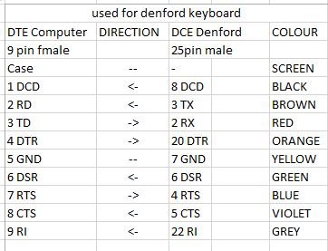

14 x 8 matrix, so I guess that it might be straight-wired to the 25-pin D-sub.
But if it is, it can't be a parport pinout.
I would think that burying a 7i73 inside would be one answer, but an arduino or similar would be cheaper.
Replied by andypugh on topic Question about keyboard for cnc build

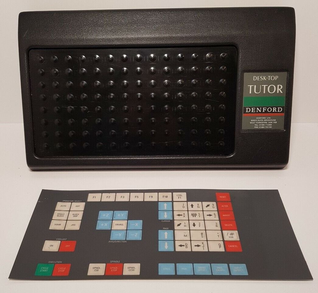

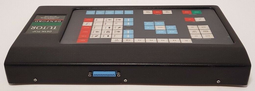

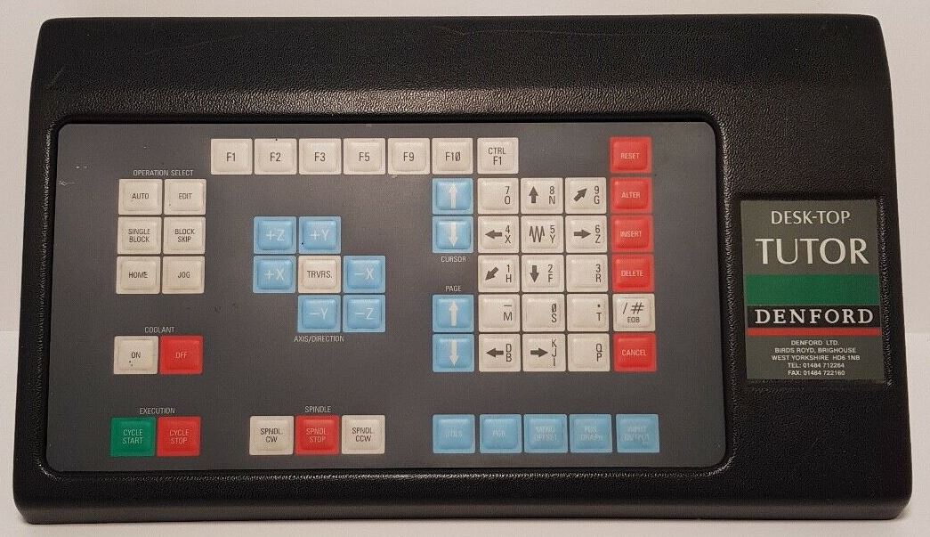

I've got one of these denford desktop / desk-top tutor keyboards too.
