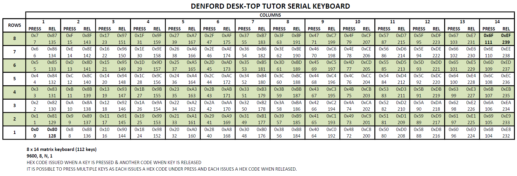

12 Mar 2021 23:36 - 15 Mar 2021 12:10 #202034
by robertspark
Replied by robertspark on topic Question about keyboard for cnc build
Hex codes as extracted this evening.
Note, one hex code is transmitted when a button is depressed and another is transmitted when a button is released.
It is possible to press two buttons and corresponding hex codes are transmitted when the buttons are pressed in sequence, and again when they are released.

14 Mar 2021 22:37 - 15 Mar 2021 12:12 #202273
by robertspark
python script to read the keyboard codes and convert to integers {probably better for switch case later}
save as foo.py
and run in terminal as
(I know little about python.... but am learning slowly)
keyboard codes start bottom LHS as 0x00 (keypress) and 0x80 (release) and
end top RHS as 0x6F (keypress) and 0xEF (release)
.... ie... go from 00 >> 111 for key press (as DEC / INT) and
from128 >>> 239 for release
note: you would need to change your port to whatever you have it plugged in as (I am using good old serial ports, but it is possible to use a USB adapter too)
save as foo.py
python foo.pyimport serial
ser = serial.Serial(
port='/dev/ttyS2',\
baudrate=9600,\
parity=serial.PARITY_NONE,\
stopbits=serial.STOPBITS_ONE,\
bytesize=serial.EIGHTBITS,\
timeout=0)
while True:
for line in ser.read():
print(ord(line) )
ser.close()(I know little about python.... but am learning slowly)
sudo dmesg | grep tty
