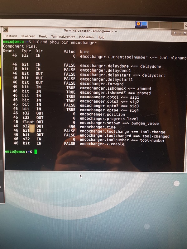

- Erikcnc
- Posts: 153
02 Aug 2019 22:56 - 02 Aug 2019 22:58 #141238
by Erikcnc
I got the picture in the attachment.
Replied by Erikcnc on topic emcoturn 120 / 220 tool turret hal outputs
I see the emcochanger.forward pin which suggests that the PWM
polarity is not used to change directions
Can you list all of the emcochanger pins?
halcmd show pin emcochanger*
(in a terninal window)
When LinuxCNC is running should do this
Last edit: 02 Aug 2019 22:58 by Erikcnc.
- Posts: 18103
- Thank you received: 5326
02 Aug 2019 23:29 - 03 Aug 2019 03:26 #141241
Replied by PCW on topic emcoturn 120 / 220 tool turret hal outputs
Looks like the emcochanger.forward signal needs to be linked to the 2 complementary direction signals on the LM298
To do this with the current firmware would require disabling one more stepgens and using one of the free pins of say stepgen3 for the direction signals.
It would probably be cleaner if I made firmware that left the DIR pin of Stepgen4 a GPIO pin instead of the PWM direction pin (which is under control of the PWM gen)
EDIT
freeby.mesanet.com/7i76e_7i76pdpo.bit
Here is firmware that has stepgen4 STEP pin replaced with PWM but left Stepgen4s DIR pin as GPIO
(GPIO8) so it can output the toolchanger forward pin
EDIT
