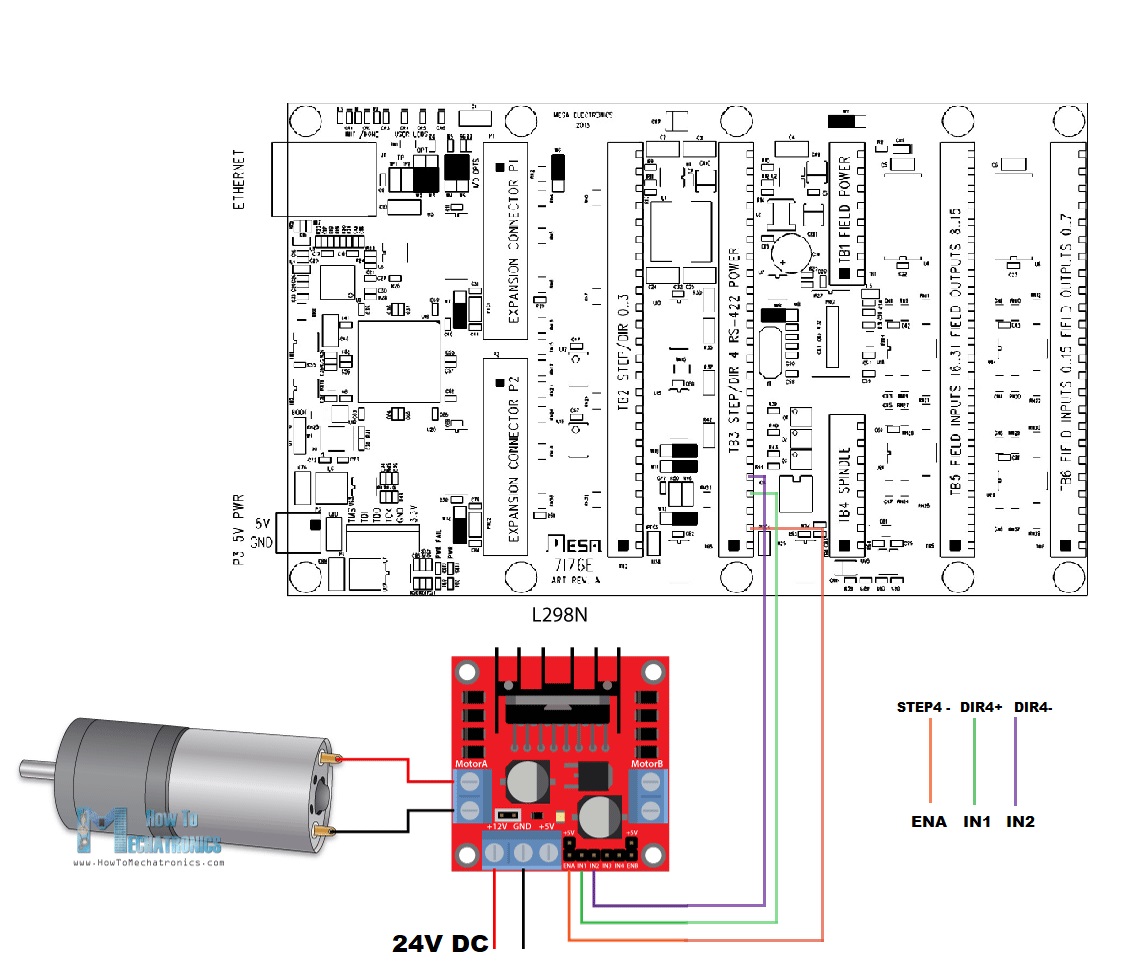

So now DIR4 on the 7I76 should follow the state of emcochanger.forward
( did you check this? )
and if DIR4+ is wired to LM298 IN1 and DIR4- is wired to LM298 IN2
the state of emcochanger.forward should control the direction of motion
and if STEP4- is wired to LM298 ENA, The PWM value should control the speed

03 Aug 2019 19:24 - 04 Aug 2019 09:08 #141292
by Erikcnc
confirmed, it does. i watched emcochanger.forward and GPIO8 out in and ion_not in halshow.
But between DIR+ and DIR- does nothing. it stays +5v
Its is wired like that indeed. but does not change direction. DIR+ stays high and DIR- stays low
STEP- does what it has to do.

hm2_7i76e.0.gpio.008.out should control the direction signals on DIR4+ and DIR4-,
but it doesn't. what could this be?

can you post your current hal file and the results of
mesaflash --device 7i76e --addr 10.10.10.10 --readhmid > pins.txt

Thanks for your reply.
I will do the readhmid right now.
Here are the hal file and schematics in advance.
Replied by Erikcnc on topic emcoturn 120 / 220 tool turret hal outputs

Just to be sure, can you remove the connector that goes to L298 from Mesa and power the drive.
If it spins, try the other output as that one is gone.

if the state of hm2_7i76e.0.gpio.008.out changes and the
external pins STEP4 DIR pins dont change, that unfortunately
suggests damaged hardware.
Do you have a ground between the LM298 board and the 7I76E?
If this connections is missing you could possibly damage step/dir outputs
especially if the 24V supply common is not grounded to the same place
as the 7I76 logic section
Replied by PCW on topic emcoturn 120 / 220 tool turret hal outputs

uhm, only ground on the 24v section. but it doesn't go to the mesa.
So now what? cant i use dir3?
and btw, the resistors i had to add were meant to protect my mesa board??
If you had resistor in all three interface lines its not likely the 7I76e outputs were
damaged.
can you do a simple test?
First comment out
net sig-forward emcochanger.forward => setp hm2_7i76e.0.gpio.008.is_output true
in you hal file then start LinuxCNC
then from a terminal, type halcmd -f then
setp hm2_7i76e.0.gpio.008.out true
setp hm2_7i76e.0.gpio.008.out false
and
show param hm2_7i76e.0.gpio.008.is_output
and copy/paste the results here (please no screenshots)
damaged.
First comment out
and
