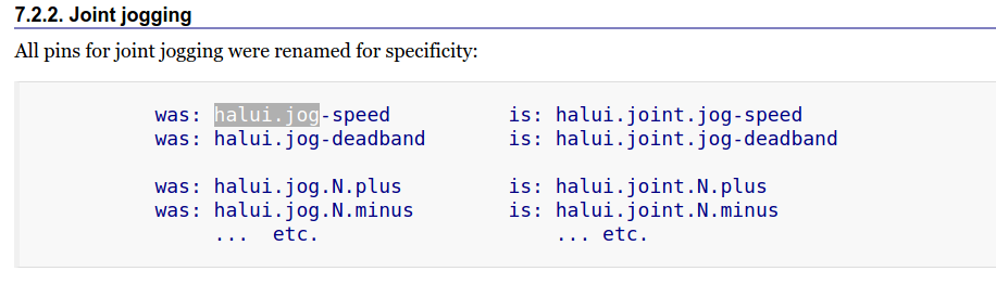

Ok got forward on this, I had to change "modbus.xplus" to "modbus.xplus.00" and it seems to not complain anymore modbus pins, now however it complains the pin which it is attached in hal "halui.jog.0.plus"
"net jog_x_plus <= modbus.xplus.00 => halui.jog.0.plus
dunno why it can't find the halui pin as I have also halui set in ini file

Sorry, I found reason for this... I used hal documentation 2.8 : linuxcnc.org/docs/2.8/html/config/core-components.html
and when I tried instead commands from devel:
linuxcnc.org/docs/devel/html/man/man1/halui.1.html
it works. Dunno how it is possible as I have 2.8. It seems the documentation is not that great on linuxcnc at some parts. I used now "halui.axis.x.plus" and it was accepted

Indeed, there is still a reference in the 2.8 docs to halui.jog:
linuxcnc.org/docs/2.8/pdf/LinuxCNC_Documentation.pdf
despite the fact that the halui.jog have been replaced in 2.8:
linuxcnc.org/docs/2.8/html/getting-start...dating-linuxcnc.html
Could somebody fix that?
