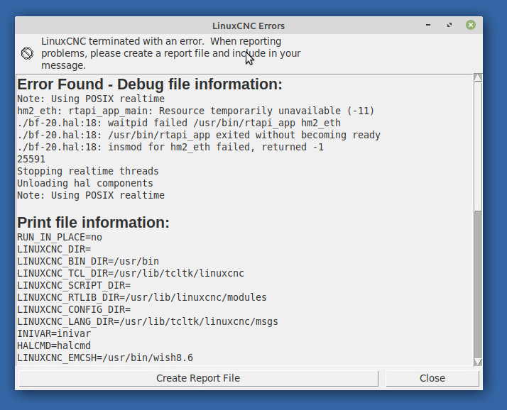

Would it have been easier to find the error if you had got this
at the beginning of the log rather than buried towards the end?
Debug file information:
Note: Using POSIX realtime
./nyx.hal:125: Pin 'modbus.xplus' does not exist
4823
Stopping realtime threads
Unloading hal components
Note: Using POSIX realtimeat the beginning of the log rather than buried towards the end?

Actually, on advice from Andy, I just swapped two lines in show_errors.tcl and added a string.
That screen shot is the actual pop up window with the mods that Andy suggested.

yes, that would been easier. I noticed I had also debug level 3 on modbus... which is way too much info on error report, I swapped it to 2 and directly I noticed modbus ini was ok.
Yes it would been easier to notice if the exact error was in beginning of report
Anyway now I know where to look and maybe I will start to understand the error log little better.
