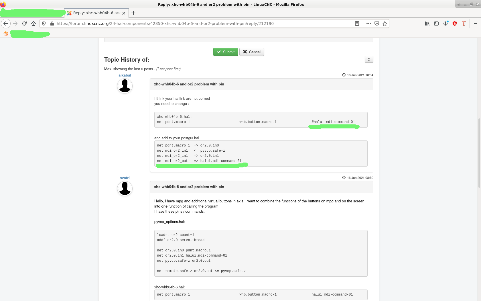

16 Jun 2021 10:34 - 16 Jun 2021 10:35 #212190 by alkabal
Replied by alkabal on topic xhc-whb04b-6 and or2 problem with pin
I think your hal link are not correct
you need to change :
xhc-whb04b-6.hal:
net pdnt.macro.1                        whb.button.macro-1                 #halui.mdi-command-01
and add to your postgui hal
net pdnt.macro.1  => or2.0.in0
net mdi_or2_in1   <= pyvcp.safe-z
net mdi_or2_in1   => or2.0.in1
net mdi-or2_out   => halui.mdi-command-01

16 Jun 2021 11:29 #212191 by szatri
Replied by szatri on topic xhc-whb04b-6 and or2 problem with pin
Hello, does what I have marked on the screen are mutually exclusive?
I corrected 4 commands, but still the problem:
