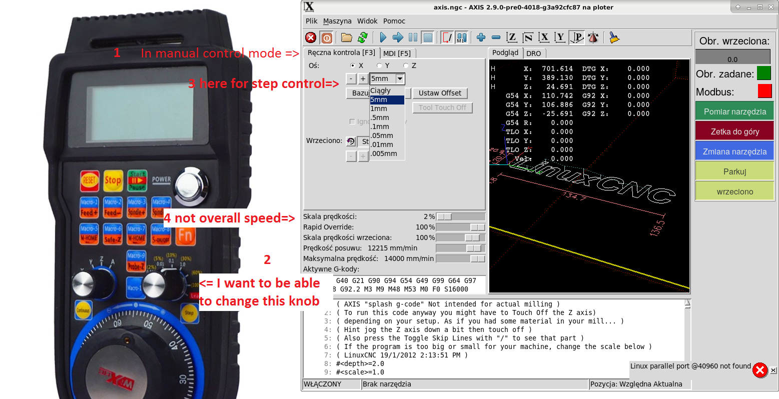

Hello, I can see that we did not understand each other, so I will show you on the drawing

I appologize but you are right i think i don't really understand what you want.
If you wan't to change the GUI step selection i think it's not really possible without issue.
The button is used as feed override or as step size and for continuous speed selection.

I'm sorry, but you are right, I didn't notice what the "step" button is for, now one click on the manual wheel changes the step jump that is set on the right switch. (just a pity that it ends at 1, as it is at 10 and 100)

I will ask what is the "lead" position for?
And how to change the preset and not machine positions on the display

Hello
Lead position is used for spindle speed override if you use the example config file.
# spindle speed override signals
net pdnt.spindle-override.scale whb.halui.spindle-override.scale halui.spindle.0.override.scale
net pdnt.spindle.override.value halui.spindle.0.override.value whb.halui.spindle-override.value
net pdnt.spindle.override.increase whb.halui.spindle-override.increase halui.spindle.0.override.increase
net pdnt.spindle.override.decrease whb.halui.spindle-override.decrease halui.spindle.0.override.decrease
For change display position Absolue/Relative you need to use macro 10.
net pdnt.reserved.for.ABS-REL whb.button.macro-10 # Hardcoded for swap Dro Relative/Absolue
Br
