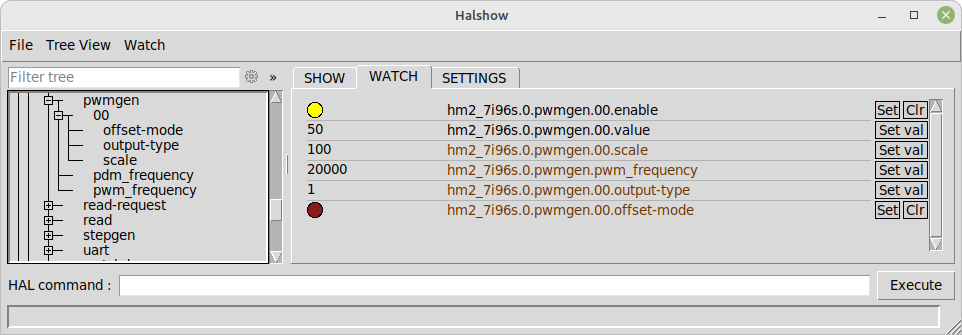

setp hm2_5i25.0.pwmgen.00.frequency 1000 threw error: ./5i25_7i76PWM_7i74.hal:21: parameter or pin 'hm2_5i25.0.pwmgen.00.frequency' not found
How else do I set the PWM frequency then?

halcmd show all | grep pwm
(the PWM frequency is for all PWMgens)

I found the parameter: 36 u32 RW 0x000007D0 hm2_5i25.0.pwmgen.pwm_frequency through halcmd
Now the motor partially spins. The PWM signal is set at 2 khz and scale of 5.0 and when I click the jog '+' button in axis, the motor had two distinct activation ( it spins for a quater turn, stops and then spins a couple of turns in the same direction) I measured the PWM voltage on mesa 7i76 board it matches the observations with a small 0.25 volts spike right after the click, it goes back to zero and then goes to 4.8 volts.
The same small voltage spike also exist in direction output too and this spike when I click '-' button makes the motor turn a quarter turn in reverse direction, stop and then turns in the same direction as the '+' jog button would make it spin.
I have uploaded the HAL config I used for this testing, it has fake position feedback to mitigate joint follow error which I tried widening the max error allowed but nothing worked.
Is there a way to suppress that initial voltage spike? Or am I doing something wrong in the HALfile?
Last edit: 14 Feb 2025 12:16 by pmchetan. Reason: Added clarity in the explanation

You could plot the velocity command to see why the PWM behaves that way
The PWM average output voltage will simple follow the PWM value its given
Note that you also have to make sure you don't exceed the maximum PWM
values (+- PWM scale)

The PWM scale is voltage right? setp hm2_5i25.0.pwmgen.00.scale 5.0 means the amplitude of the signal is 5 volts.
Does PWM in our context go positive to negative!! I did try setting it like this with 7i77 board.
When I measure the PWM output with a voltmeter, it shows positive 5 volts with both positive and negative jog directions with direction pin providing +5v when using negative jog and staying at 0 volts with positive jog.
Since I mentioned scale as 5.0 and I'm getting 5 V PWM signals correctly but why an initial spike of 0.25 volts and it goes back to zero and then climbs to 5 volts is the mystery that needs solving. I'll plot the velocity and PWM signals tomorrow and report back but isn't the PWM signal the one with drives the position thereby driving the velocity? Maybe setting max jog velocity has some effects on the PWM signals generated.

The _average_ PWM voltage (what a voltmeter reads) with be the output voltage (~5V)
times PWM_value/PWM_scale
The PWM amplitude is always 5V, its duty cycle changes with the PWM value
I would set the PWM value manually for testing as I have no idea what the velocities
are relative to the PWM scale
