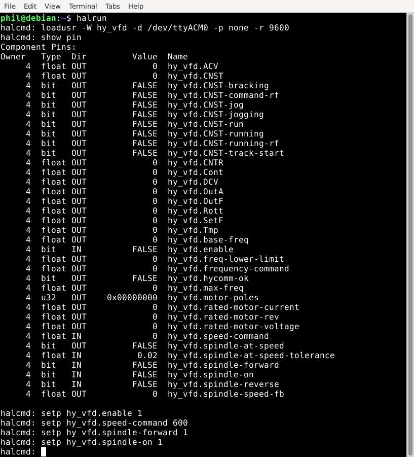

While linuxcnc loads, if, after homing, I select MDI and type M3 S1000 (or any other value), nothing happens.
For a while I was questioning the wiring to the spindle/mains and had the awful thought that either the spindle or VFD were duff.
Last night I found this thread forum.linuxcnc.org/24-hal-components/310...anyang-speed-control and when I followed these steps in Terminal, voila! my spindle runs.
I have attached my HAL file and a screenshot of my procedure in Terminal in the hope that someone can explain why I can't operate the spindle from within my GUI.

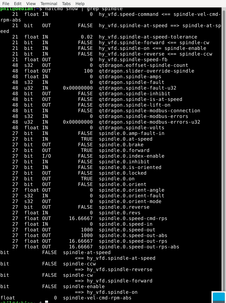

- Mr1576
- Posts: 11
26 Jan 2026 15:41 - 26 Jan 2026 15:58 #341952
by Mr1576
Replied by Mr1576 on topic HAL Edits for RS485 / VFD Spindle Control
Last edit: 26 Jan 2026 15:58 by Mr1576.
- Posts: 22025
- Thank you received: 7500
26 Jan 2026 15:46 #341953
Replied by tommylight on topic HAL Edits for RS485 / VFD Spindle Control
No spindle there, attach the hal and ini files here so we can have a look.

- Posts: 19902
06 Feb 2026 21:03 #342570
Replied by andypugh on topic HAL Edits for RS485 / VFD Spindle Control
spindle.0.speed-out is clearly there in the screenshot.
Two possibilities spring to mind, one of them rather wierd.
1) You have the net commands for the spindle too early in the HAL file, ie before the motmod module has been loaded.
2) The - in speed-out is the wrong sort of dash. Though it looks right in this case. Maybe try re-typing it using the minus key. I think I typed out the example text on my Mac on a train, and it likes to be clever with typography.
