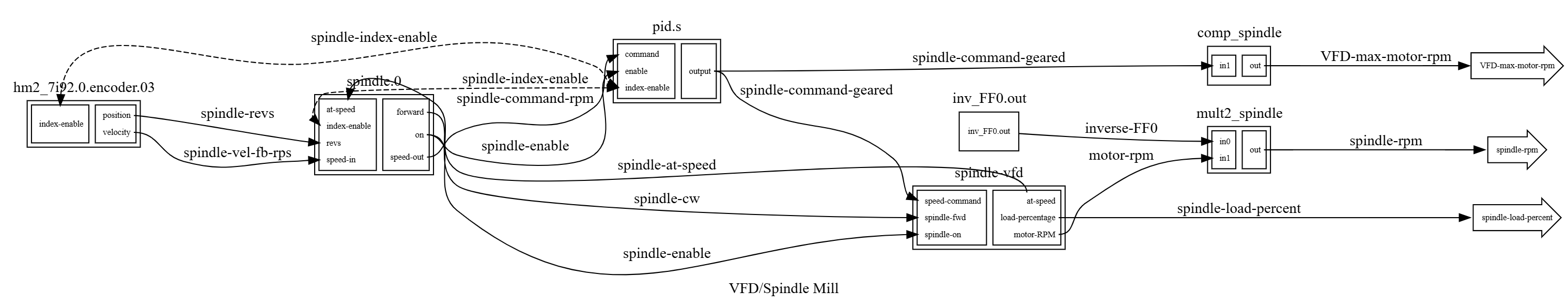

10 Feb 2026 14:21 - 10 Feb 2026 15:40 #342786 by jtrantow
Replied by jtrantow on topic HAL Edits for RS485 / VFD Spindle Control

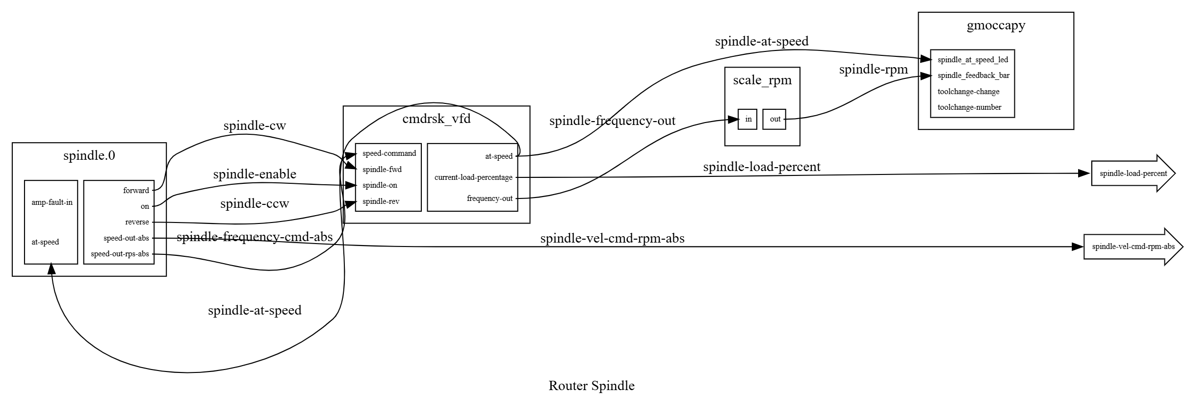

Looks like you have a very simple VFD/Spindle setup. If you are using a simple spindle setup that may be enough. If you have a machine with any type of gear ration between the motor and spindle the following may be of use.I'm using RS485 VFD to control the spindle on three different machines:
  • Router - high speed spindle 24000 RPM with a CommanderSK VFD (capable of 1000hz).
  • Mill - Six pulley combinations connected to nominal 1725 RPM @ 60 hz motor with a GS2 VFD. [MANUAL BELT CHANGE]
  • Lathe - Six pulley combinations connected to nominal 1750 RPM @ 60 hz motor with a CommanderSK VFD. [MANUAL BELT CHANGE]
    With the Router I don't have to worry about gearing changes (or sending commands greater than the VFD can handle).
    With the Mill and Lathe, I only recently figured out a way to easily change scaling to match the gearing using pid FF0.
    Using PID component is nice for several reasons:
    1. I can use the gmoccapy/Calibration to change/test/save [SPINDLE_0]FF0 while running linuxcnc whenever I change belts.
    2. I can set [SPINDLE_0]MAX_OUTPUT to avoid sending illegal RPM commands to the VFD which get ignored and can cause a crash if you aren't checking the at-speed status.I added a [SPINDLE_0]MAXIMUM_MOTOR_RPM parameter to the .ini and kick off a message to change belt if the motor RPM is maxed out.
      Here are my additions to Mill.ini for this implementation:
      Mill.ini
      [DISPLAY]
      MESSAGE_BOLDTEXT = NONE
      MESSAGE_TEXT = VFD using maximum motor RPM.
      MESSAGE_TYPE = okdialog
      MESSAGE_PINNAME = VFD-max-motor-rpm
      [SPINDLE_0]
      P = 0
      I = 0
      D = 0
      FF0 = 1.135
      [code]MAX_OUTPUT = 1799
      [/code]
In the near future I intend to redo my spindle encoders and use the forum.linuxcnc.org/47-hal-examples/27071-automatic-spindle-gea idea to automatically choose FF0.
