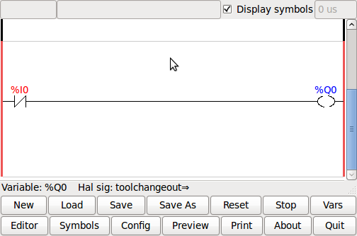

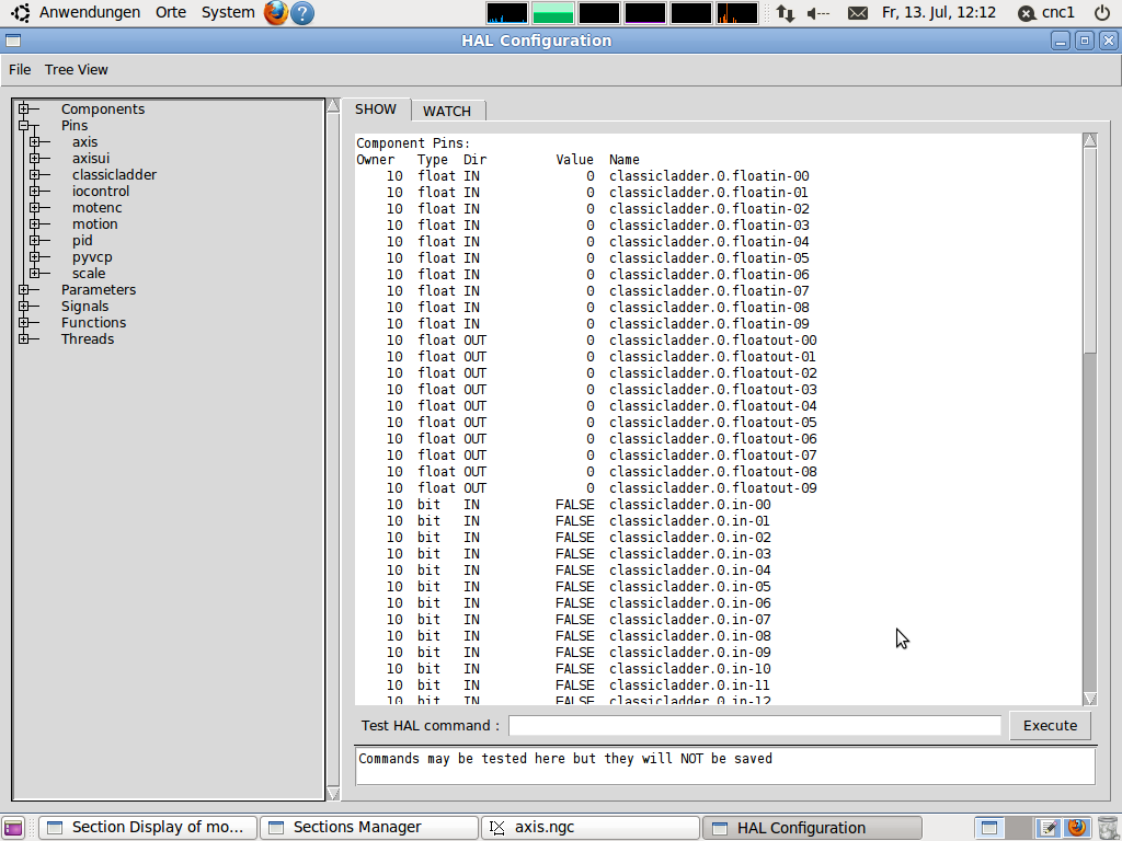

- Linux-Hus
- Posts: 9
13 Jul 2012 12:19 - 13 Jul 2012 12:20 #21872
by Linux-Hus
Replied by Linux-Hus on topic Re:I/O ClassicLadder
Last edit: 13 Jul 2012 12:20 by Linux-Hus.
- BigJohnT
- Posts: 6999
- Thank you received: 1176
13 Jul 2012 12:35 - 13 Jul 2012 12:36 #21873
by BigJohnT
Replied by BigJohnT on topic Re:I/O ClassicLadder
Did you addf classicladder.0.refresh servo-thread?
Add a rung to your ladder with a N/C input %B0 and a N/O output of %B1. If that does not show up in red then you don't have classicladder running in a thread.
John
John
