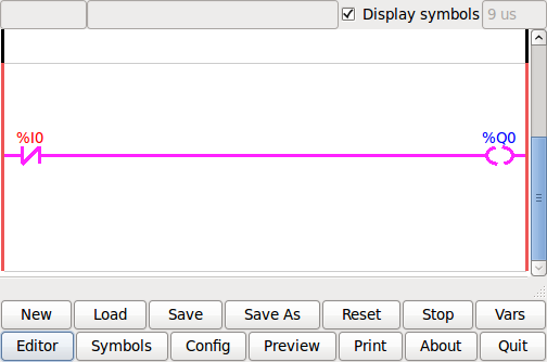

its working with the classicladder.0.refresh servo-thread.
the problem, i have in the ladder :
- %I0 N.O >>> %Q0 N.O its not working
- %I0 N.C >>> %Q0 N.O its working in the ladder to the output, nothing of emc (M06)
I starting the program in emc M06T1, its not workin.
thanks for reply.
Steffen

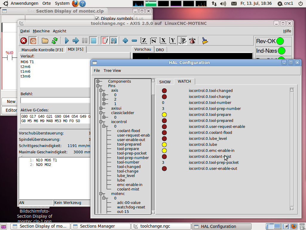

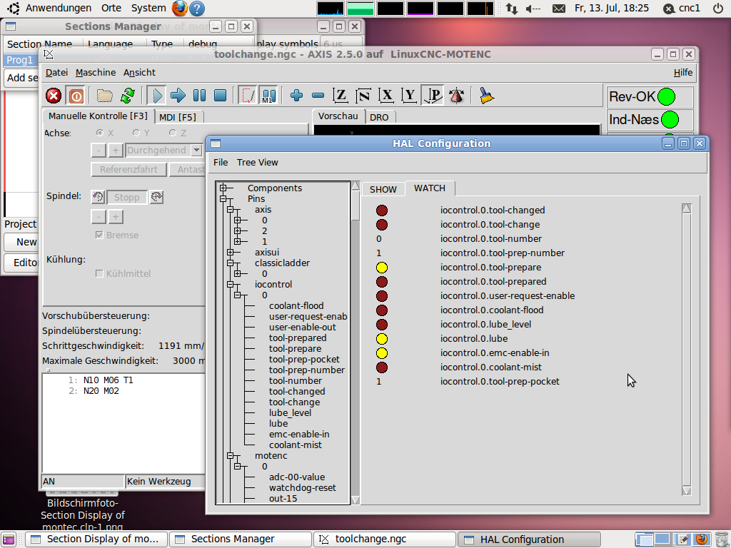

13 Jul 2012 13:55 #21878 by BigJohnT
Replied by BigJohnT on topic Re:I/O ClassicLadder
Open up the Show Hal Config window and add all the iocontrol.0.tool and classicladder I0 and Q0 pins to a watch window and do a tool change to 0 first then to 1 like this
T0 M6 G43
T1 M6 G43
and watch the status of the pins.

13 Jul 2012 17:08 #21903 by BigJohnT
Most likely your missing the tool prepare loop, that is why I posted my hal so you could compare to yours.
John
