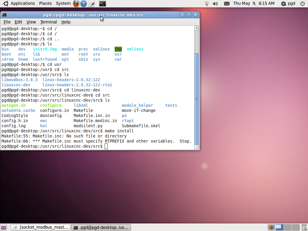

You must have been outside the sources directory.
install is an option in the Makefile, but you have to be in the directory containing Makefile to run make install

We may be at cross purposes
I was talking about building libmodbus
(You need to be in /usr/src/libmodbus-3.0.3 and have run ./configure then make then you can run make install to install the libraries in/usr/local/lib)
I thought by step 3 you meant make install and
I now think you are referring to something else?
meant you had got it to make OK at another attemptOK step 2 seemed to go ok,

No, I'm sorry, I think I got the libmodbus to install???
Now I had moved on to trying to get master to install. Which is what I thought step 2 was in the wiki.

Have a look in /usr/local/lib
Just in case you have not managed to build the libmodbus-3.0.3 libs there is a zip attached with the files to be copied to /usr/lib
(then you won't have to add another path to LD_LIBRARY_PATH)
Then run ldconfig from the command line.
regards
(they were built against 10.04)
regards

OK
Go to /usr/src/linuxcnc-dev/src
./autogen.sh
./configure (--enable-run-in-place) or (--prefix=/usr) for a system install
make
make setuid (RIP) or make install (system install)
(cd../
. ./scripts/rip-environment) for RIP
linuxcnc
Because the source code is now in the master that should take care of step 3 too

Now I get an error sayiing that python is required to build LinuxCNC..

sudo apt-get install cvs build-essential fakeroot debhelper libpth-dev libgtk2.0-dev kernel-wedge tcl8.5-dev tk8.5-dev bwidget python2.5-dev python-tk python-dev libglu1-mesa-dev libgtk2.0-dev libgnomeprintui2.2-dev libncurses5-dev libxaw7-dev gettext libreadline5-dev lyx texlive-extra-utils imagemagick texinfo groff
will install all you need and much more

is there any particular directory in which that particular can-o-worms should be opened?

No they are deb packages, will be downloaded into /var/cache/apt/archives
The command can be run from anywhere
