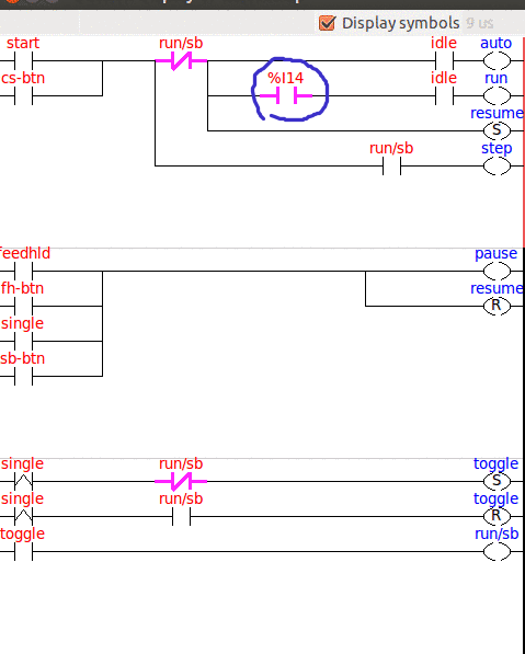

07 Jan 2021 12:16 - 07 Jan 2021 13:14 #194388
by nkp
Replied by nkp on topic CL logic to make LCNC buttons work like industrial machines
I10 - ?
I11 - ?
I13 - ?
When you first start the program, almost always an error:
can't do that (EMC_TRAJ_SET_TELEOP_ENABLE) in auto mode with the interpreter paused
Lcnc 2.7 Axis
PS
The scheme needs improvement
net mode:is:auto classicladder.0.in-14 halui.mode.is-auto
I11 - ?
I13 - ?
Lcnc 2.7 Axis
PS
Last edit: 07 Jan 2021 13:14 by nkp.
- nkp
- Posts: 143
- Thank you received: 39
07 Jan 2021 15:07 #194416
by nkp
This works fine.
net auto classicladder.0.in-00 pyvcp.run
net feed-hold classicladder.0.in-01 pyvcp.feedhold
net program-idle classicladder.0.in-02 halui.program.is-idle
net single-block classicladder.0.in-03 pyvcp.step
net mode:is:auto classicladder.0.in-04 halui.mode.is-auto
net btn-stop classicladder.0.in-05 pyvcp.stop
net auto-mode-select classicladder.0.out-00 halui.mode.auto
net cycle-start classicladder.0.out-01 halui.program.run
net feed-resume classicladder.0.out-03 halui.program.resume
net single-block-select classicladder.0.out-04 halui.program.step
net program-stop classicladder.0.out-05 halui.program.stop
net feed-hold-select classicladder.0.out-02 halui.program.pause

15 Jan 2021 12:03 - 15 Jan 2021 12:08 #195471
by The Feral Engineer
I don't get any error messages when I use it (2.8.1). I have made a few changes to it since I posted this, nothing crazy, just centralized the grouping of the physical and gamepad buttons I was using. Pressing cycle start should bring the machine to auto mode, not alarm. I did, however, add halui.mode.is-auto to I6 after posting my file here.
To answer your other question, I10, I11 and I12 (formerly i13) are for a different circuit. Those are assignments to two separate probe circuits, using separate inputs and an internal relay to switch between them.
Long story short, my machines have a hardwired tool setter mounted to the table and a spindle probe. Both setter and probe are NC, so when the spindle probe is disconnected from the machine, the signal is broken, so the probe is in a constant trigger state. I12 is a relay that flags mcodes using sets probe-relay true/false. I12 is tied to both a classicladder input signal as well as spindle inhibit, so when the spindle probe is active, the spindle cannot rotate.
see attached. I commented at the top of each rung section. I make little tutorial videos on basic CL and HAL for youtube, so sometimes my samples get attached to my CL files, but they don't usually get in the way.
Replied by The Feral Engineer on topic CL logic to make LCNC buttons work like industrial machines
I10 - ?
I11 - ?
I13 - ?
Lcnc 2.7 Axis
PS
Last edit: 15 Jan 2021 12:08 by The Feral Engineer.
