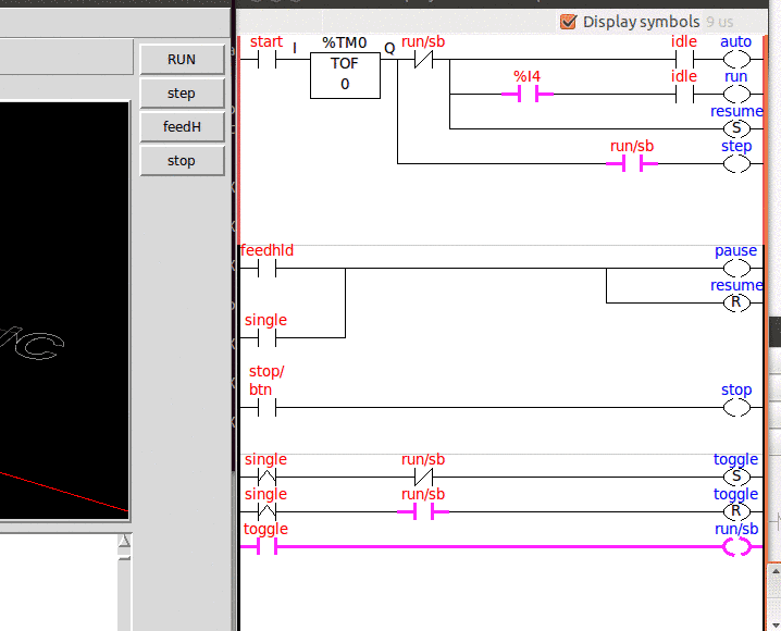

Hope you find it useful. I've got it working on my machine with no issues after a few minor adjustments
Replied by The Feral Engineer on topic CL logic to make LCNC buttons work like industrial machines
This works fine.
net auto classicladder.0.in-00 pyvcp.run
net feed-hold classicladder.0.in-01 pyvcp.feedhold
net program-idle classicladder.0.in-02 halui.program.is-idle
net single-block classicladder.0.in-03 pyvcp.step
net mode:is:auto classicladder.0.in-04 halui.mode.is-auto
net btn-stop classicladder.0.in-05 pyvcp.stop
net auto-mode-select classicladder.0.out-00 halui.mode.auto
net cycle-start classicladder.0.out-01 halui.program.run
net feed-resume classicladder.0.out-03 halui.program.resume
net single-block-select classicladder.0.out-04 halui.program.step
net program-stop classicladder.0.out-05 halui.program.stop
net feed-hold-select classicladder.0.out-02 halui.program.pause

[EDIT - I abandoned this in favor of the run/step scheme located in the HAL Examples sub-forum. I'll come back to classic ladder once I've learned more about LCNC]
Thanks to the OP for posting this; I'd really like to have all my machines to act the same with cycle-start, feedhold, and single-block functions.
Unfortunately, I'm having some problems getting it working properly. I'm sure I'm doing something wrong - i.e. new to LCNC and classicladder.
Anybody willing to have a shot at helping me troubleshoot this thing? The ladder program starts & runs, and the cycle start button works.
Problem is that while I can see the single-block toggle in ladder, it doesn't seem to 'stick'.
Pressing cycle-start starts a program - OK
Pressing feedhold pauses the program - OK
Pressing feedhold again does not resume - not OK
Pressing cycle-start resumes the program
Restarting the program:
Pressing single-block and then pressing cycle-start starts the program and runs a single line, but a second cycle-start puts the program back in auto. not OK. (single-block not persistent)
Pressing cycle-stop works OK
I've attached my version of the original .clp file and the pertinent sections of my hal file. Note that I have to put all my net commands on two lines as dyslexia gets me if a net command has more than one thing on it.

sorry for the late reply, just seeing this. i'll see if i can take a look at what you've got going on.
as far as pressing feed hold again to resume, the whole purpose of my CL logic was to prevent this from happening. Feed hold should never resume motion, only cycle start.

Despite the 'edit' in my last update, I'm back to using the CL scheme above. Seems to be working, more or less, but I haven't done tons of testing yet as I'm working on all the final retrofit punch-list stuff.
If you have a suggested edit I'm all ears, but I think my biggest complaint is that LCNC only pauses/steps at lines with motion. M-codes, G4 pauses, etc. all get executed whenever a program is paused or being stepped through.
As I understand it, this is pretty-much hard-coded and not something simple to fix - and has nothing to do with your CL single-block 'mode' function.

Indeed. There is no 1:1 link between G-code program lines and the elements in the realtime motion queue. Many codes simply set an internal G-code interpreter state, and nothing about them ends up in the motion queue until the next motion command is interpreted.
Everything that is sent to the queue has an associated program line attached to it. But, taking the case of a standalone F command on a line of its own, that won't end up as an item on the queue (such as "STRAIGHT_FEED(........)" ) it will just be something that affects the parameters in the next STRAIGHT_FEED
